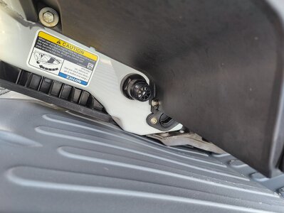

Hi, we have 3 fishpro trophies 2022. we have had issues where, on all of them the bait doesn't stay alive. I made a video to show why the baits are not surviving.
Unless we are doing something wrong. But I can't for the life of me figure it out.
At the same I can't see how no one else has had the same issue because on ours we can replicate it all the time.
Thanks

It's interesting that I am not getting any feedback. but I can replicate this problem 100% of the time. I think I will have to modify the intake of the water location
Bad design. Modifying the water intake away from the pump area where exhaust gases can be introduced or look into relocating the exhaust outlet above the water.
really bad design. I have already ordered a pickup forwhen the jetski is moving at high speed(need to modify live baitwell a bit). but as for in Idle, I have to open it up and see if I can rout it to the bottom of the hull..away from exhaust
Why not tap into one of the freshwater lines coming inside from the pump. The water should be clean coming from the pump before the exaust gases are introduced at the rear. A t fitting to the live well ?
yes..very possible. Honestly I havent opened the jetski up yet..I need to go in and figure out what type of pump is being used (because thats another problem). They claim it can run dry because it will have to as you're moving faster than idle. but no pump likes to run dry. Ive had issues with the switches and pump not working...I also need to see how and where everything is rigged.
I'm not familiar with the fish pro enough to know the water routing. Pop it open and See how the pump is routed. Can spitball ideas to figure it out.
