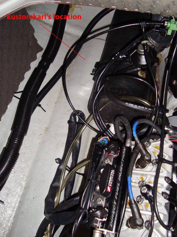

If you going to use silicone....try that location. Easy to undo. I'm gonig to try silicone as Mayberry az suggested.
This is my location....(pic not from my boat but same spot)

Thanks for the great information. Just got back from boating on Lake Ontario. The transducer in hull seems to be working well. I am getting good depth readings , just don't know how well the fish finder is working , did not see any fish but it was picking up the bottom and the water seemed mostly clear above the bottom. I guess it is time to learn how to use the fish finder. Prior to the outing, I did disconnect the nearby Sea Doo stock transducer so as to not get interference. The next time I will see if the transducers can work side by side, I believe they both use 200 hz, so not so confident about that.
