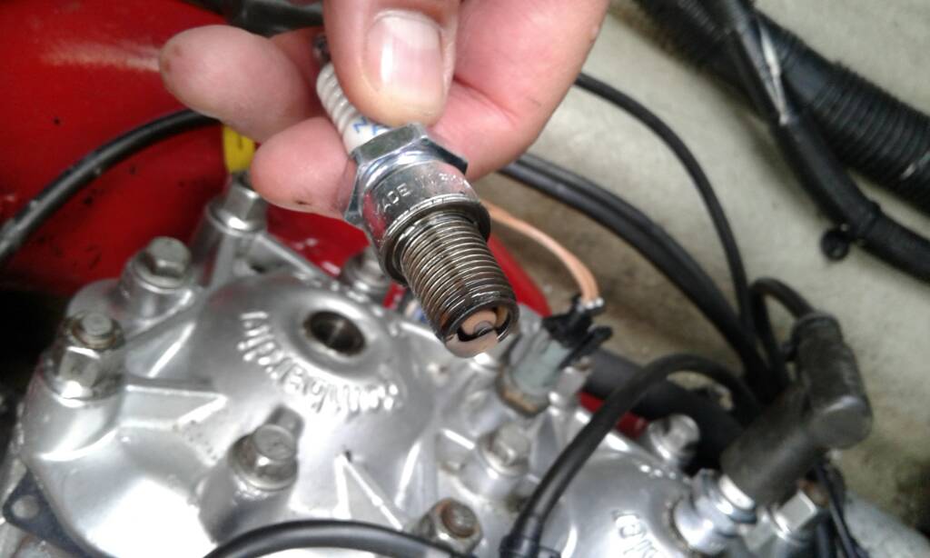

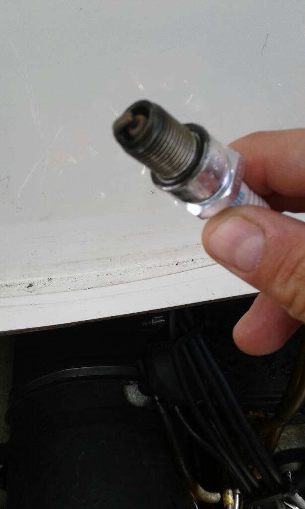

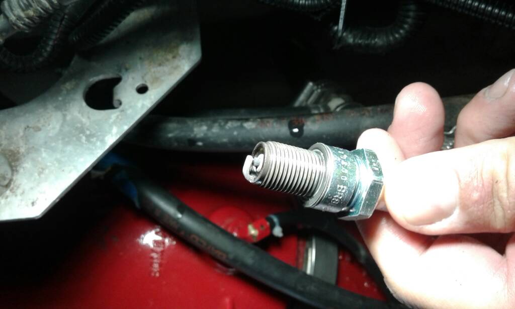

Done some mild carbtuning this summer .
Reading plugs every time I go out
Started with this.....
To this...
And now I think they look pretty nice. Anyone can confirm?
The high speed is all the 1/4 turn to lean and the low speed is as the manual + 1/4 turn clockwice then another like 1/8 turn.
Funny thing is that mag and pto cark lowspeed screws are slightly of eachother. When I put the lowspeedscrew exactly the same the mag plug get a little darker.
To this...
