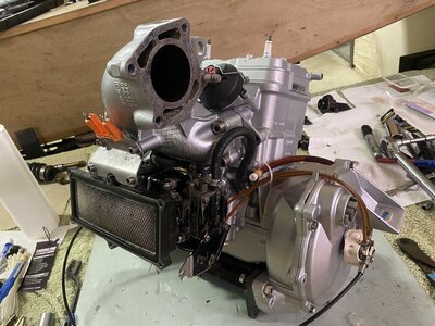

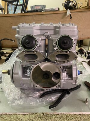

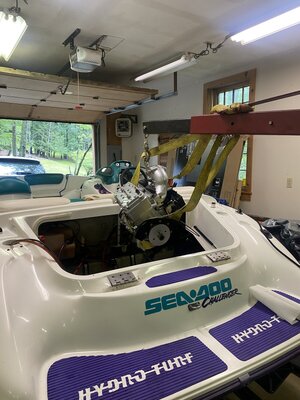

So I replaced my engine. I found a crack in the PTO jug and since I needed to do a top end I just said go ahead and get the whole engine and do it right. The previous owner didn't prep for winter and put JB weld which started leaking and I only just found it a week ago smh...
I have a few questions;

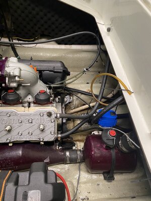

1. I felt the PTO wheel after running at idle for a while. It gets a bit hot, not enough to burn you, but like a hot cup of coffee. I had the cover off and touched it and this is the first time I've ever checked that. Is it normal for the PTO wheel to get hot to the touch while running for a while? (I do have the oil lines installed and they are full of oil.
2. How fast should the oil pump, pump oil? It seems to move extremely slow at idle, and I only see the oil move if I crank the engine with the plugs disconnected and pushing the throttle forward. Even when I had the pump off and I was bench testing it I had to pull it's "throttle" back pretty far for it to start pumping. At almost fully open it pumps in pulses back and forth at about 1 pulse each side every 1.5 seconds. But is it normal for the oil pump to pump very very slow at idle?
3. Here is how it sounds running. Does this sound normal to you experts?
New Engine Running
4. What are the stock carb settings for the 96 Challenger Rotax 787? I'm seeing all sorts of things like Low Speed to 1 or 1 1/4 or 1 1/2 turns out. I can't find any true and consistent source of the accurate stock settings. I want to set it stock, adjust for smooth idle, and leave it along.
