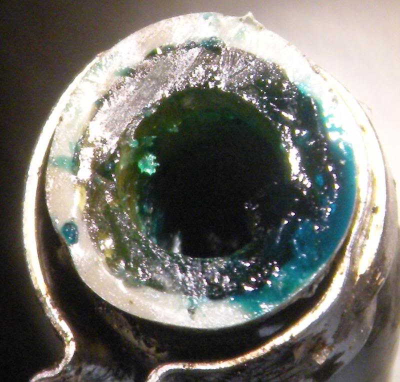

Finally started changing the lines. Found a jello like green substance in the return lines coming from carbs, one of them clogged completely. Anyone have any idea what the green stuff is?
Pix....
Last year, when I changed out my fuel lines on that new GTX I bought, I did the same thing. Took some pix, cut them lengthwise and took photos.
The Tempo fuel lines was another one of those big blunders that Seadoo used in building our skis.
In my signature, there is a link to "snipes korner" where I did a bit of research on these lines with pictures. I'm going to ask the poster if I can use this photo in my korner, where all who read the korner can see this up close and personal view. His camera takes much better close ups than mine does......!
Thanks guys!! I am glad you liked the pics.I'm happy to be able to finally contribute something to the site,since you all have been so much help.
I'm getting ready to tear into the carbs so I'll post more pics If I find any more "mystery goo." So then we can all see what these fuel lines are actually doing to our fuel systems.
And once again thanks for the compliments on the photos I really do appreciate it.:)
