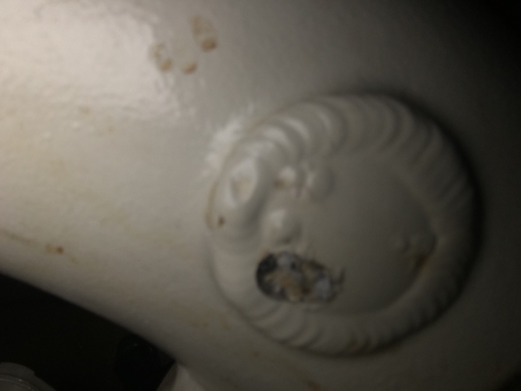

My carbs do not have accelerator pumps they are off a 1997 seadoo GTX which was not equipped with one but I found a chip in the exhaust pipe I can show you a picture of it there's some black stuff on it that showed me there is carbon which is a sign of a leak
