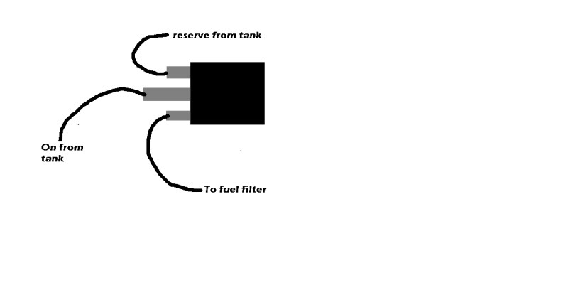

I just went out and checked and all the fuel lines are right coming out of the tank sender. Here is how i have the lines going to shut off valve-
I think i have the middle and bottom lines mixed up?
Ok i went out and seen that the valve was marked for which line goes where. I did have the lines mixed. I dont think that it had anything to do with the problem I have tho. Both cylinders are getting too much fuel. Anyone else have any input??
the fittings off the fuel selector are 2-in, 1-out. the 2 side by side ones, are the res/on lines, from the tank, the bottom fitting from valve, is the one to the filter.

Looking at your diagram, did you switch the lines on your selector? I took mine out and it is clearly marked. Mine has the fuel filter in on the middle one. The pop off test makes me think that it is on the selector. If it is right on the selector, you just going to have to turn wrenches. Please post the solution when you find the problem.

Yeah, all the lines are correct i checked them. Just gonna have to play with it another day. I'm starting to lean to something in the carbs.

Well I messed with the ski tonight some and got it running. I had one of the fuel lines mixed up going to the fuel selector and this must have been causeing my problem. I cleaned the plugs off and blew the cylinders out and it fired up. It ran a little rough at first, but cleaned it self up. It idled around 2500rpm so i adjust that back up the 3000. Also reajusted the low speed adjusters and it seems to be running pretty good. It revs real quick and clean. The only real problem it has is, if it sits for about 5min or so it has a little rough start up. But if you shut it off and fire it back up it starts right up. Just have to put it in the water now and see how it runs under load.
