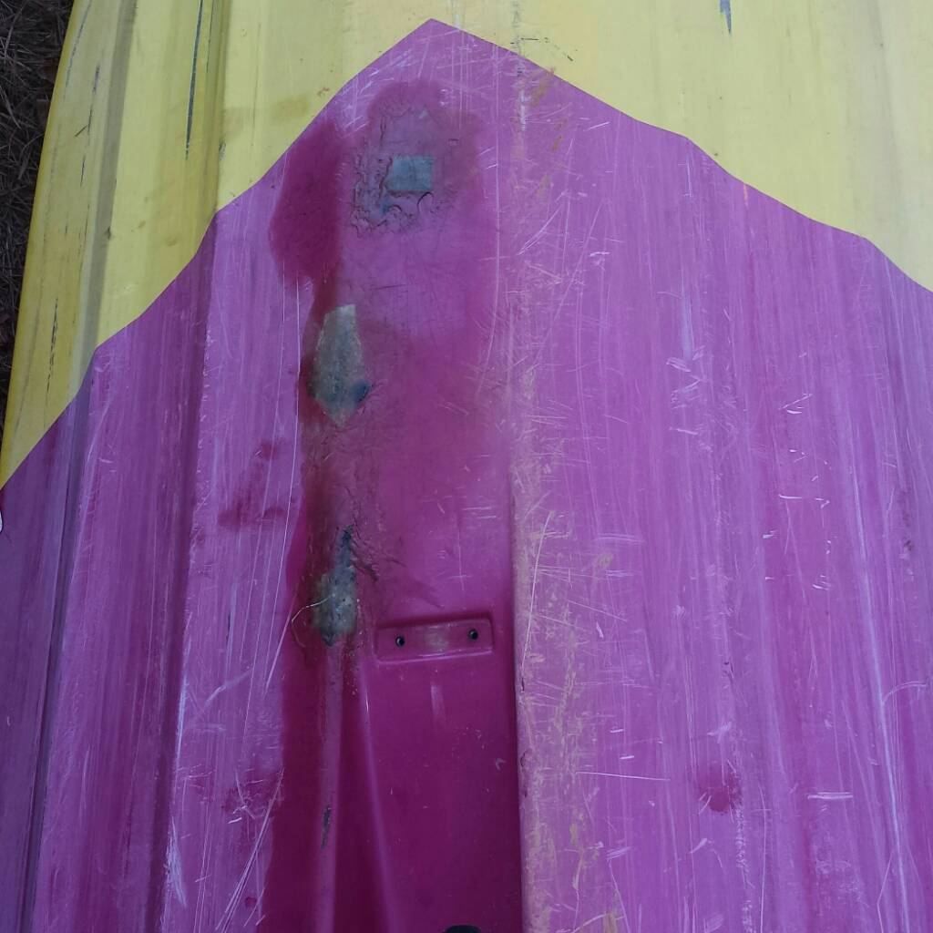

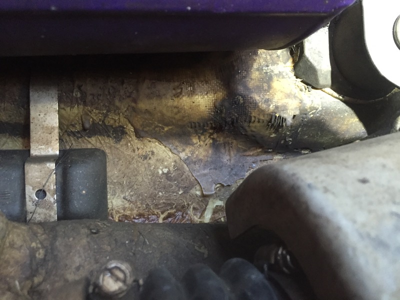

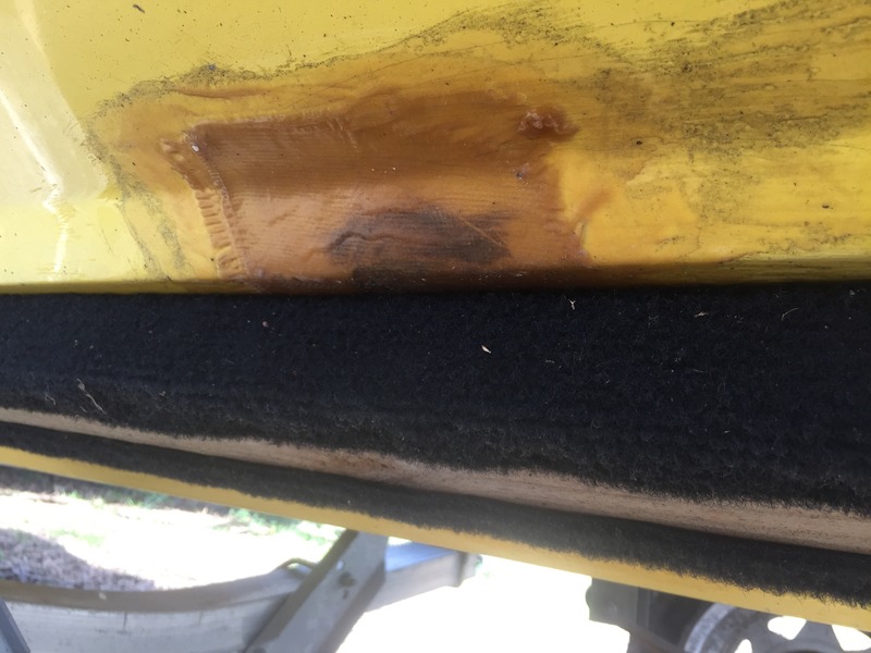

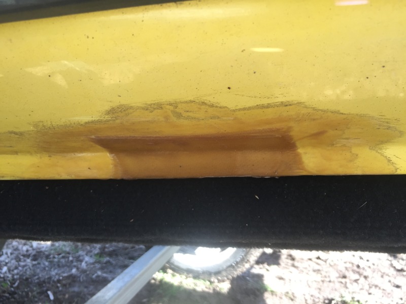

Ok, so I was outside today looking around at some of my projects. Got to looking at this one again. Now that it has thawed out I was looking at it and it's a shame the underside has damage. The top side is super clean. Looks like at some point trailer bunk bolts or something poked through the hull. The patches are large but the hole is only an inch or so big. Sooooo......should I pull the motor which I will be doing anyway and patch it correctly from inside and out, and paint and blend underneath it? Then restore the rest of the ski? Also, I am thinking about rebuilding the motor myself. I usually send them out to have rebuilt but reading some of the other threads like [MENTION=57920]racerxxx[/MENTION] and [MENTION=51350]Jetskigoodies[/MENTION] along with some others and seeing/learning to rebuild I think I can do it. Honestly is there much to it? Tearing it down, splitting the cases, then replacing crank, balance shaft, pistons, etc and sealing and torquing it back together?

So here are a few pics of the hull damage. Let me know what you guys think.
This last pic is near the rear port motor mount
It's ugly but it looks to be a solid repair to me. Although I do not know too much on fiberglass repair.

I don't know. Personally I would scrap it. I don't look like the went far enough with the repair. For a one inch hole I would think you would need to remove the gel for at least 6 inches from the hole so you would have about a 12 inch patch area. Old hulls are cheap enough is it worth risking the internals for a patch that could delaminate while riding?
The outside patches look ok. It's the inside that worries me. I can't tell if it's next to the motor mount or if the repair is part of the mount. I guess once I get the motor out I will look at it closer. May just be a doner ski. I found a 95 xp800 hull only on CL. Waiting on pics. Guy is 2 hrs from me. Will the pump from this 96 fit on a 95 800?
