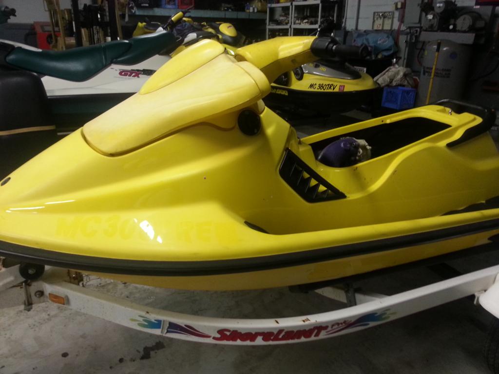

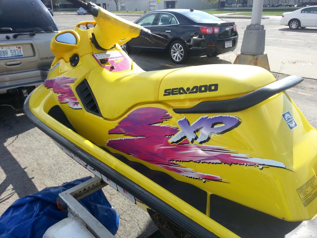

I know there are a bunch of these 96 xp threads but we have just had someone drop off their 96 xp and they want it restored. They want it close to original as possible. He wants new decals, the seat back to yellow, and it cleaned up to new. So I thought some of you may enjoy seeing the process.

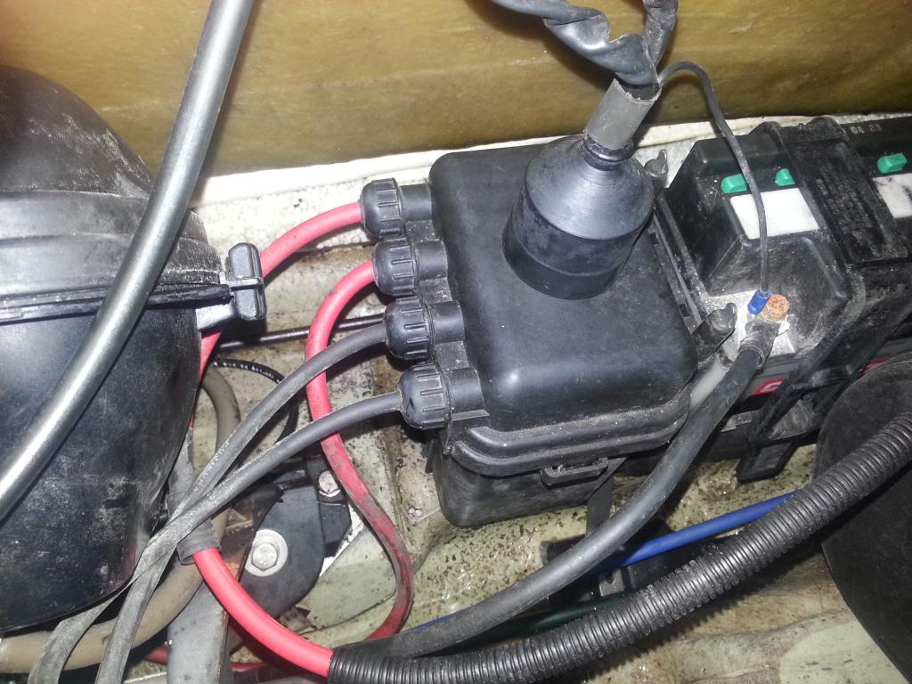

So he dropped it off and said it was not getting spark. We put an inline spark tester on and hit the start button. It turned over but no spark. We tested the battery and it was at 11.7, we put another battery in that was at 12.1 volts and it now had spark and fired right up.

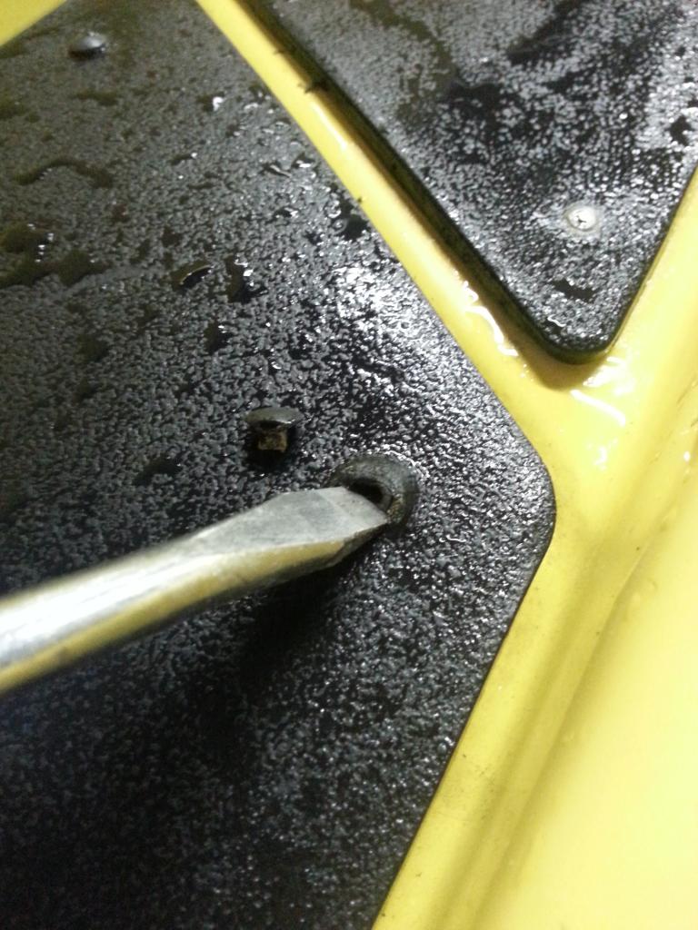

2. Remove mats

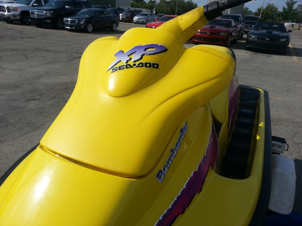

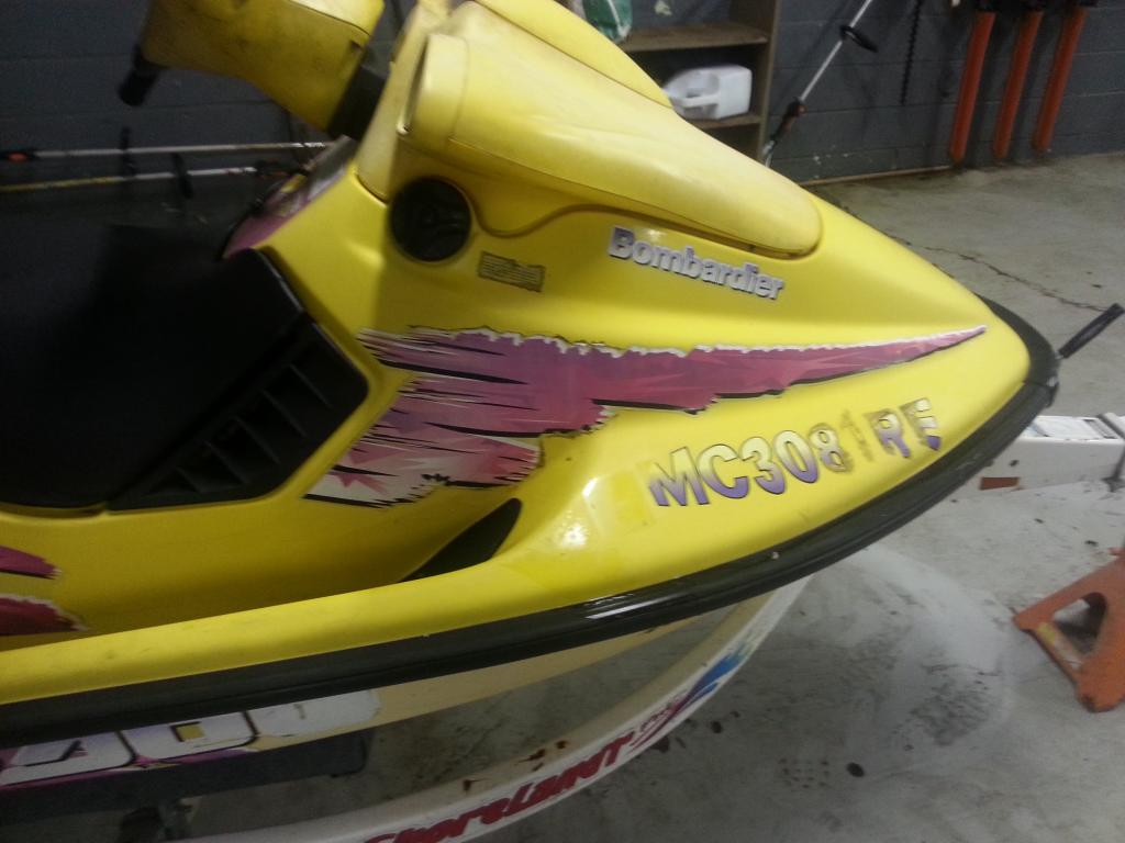

For the graphics I called Mike at pwcgrahics.com or [MENTION=70010]RatFink[/MENTION]. I told him what my plans are and I informed him I have a 96 xp that has nice graphics with vibrant colors. I am going to send him lots of pictures and dimentions this weekend. He said that would help him out greatly in reproducing them. He said there has been alot of interest in the 96 decals.
I will be taking pictures of this xp's decals to send in.

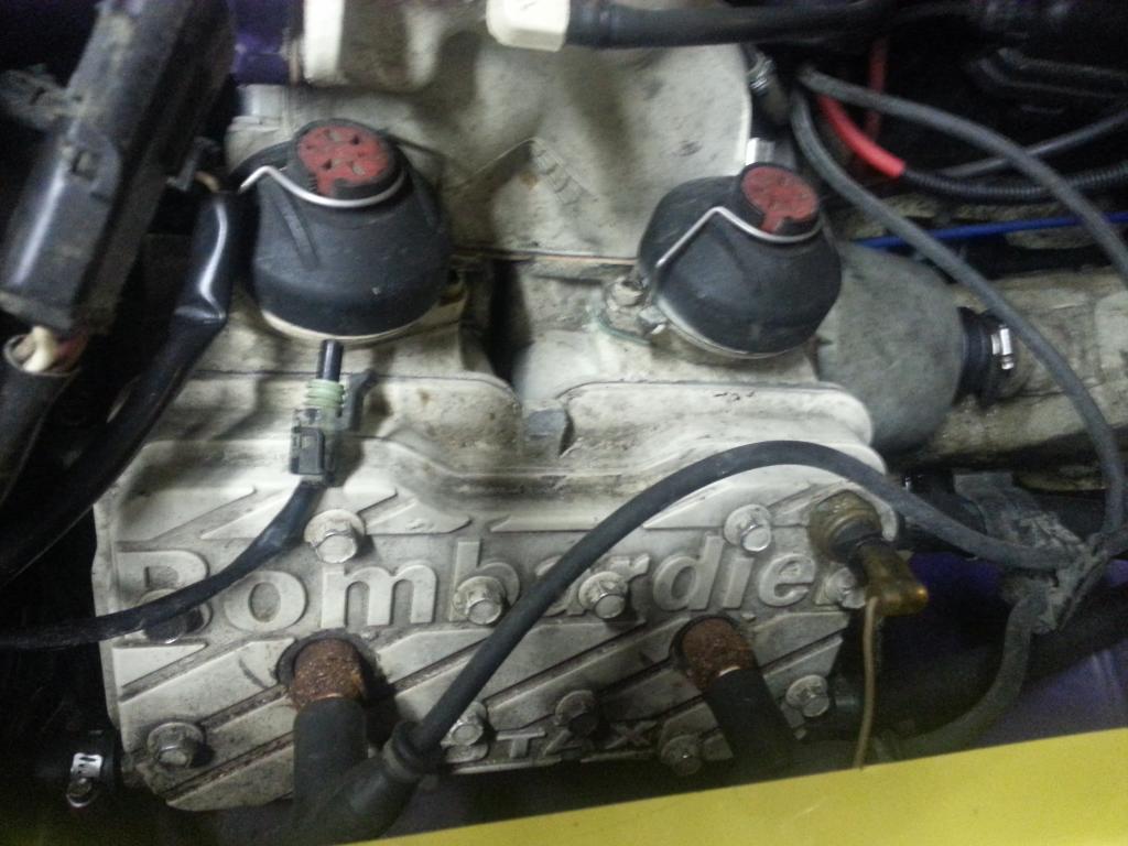

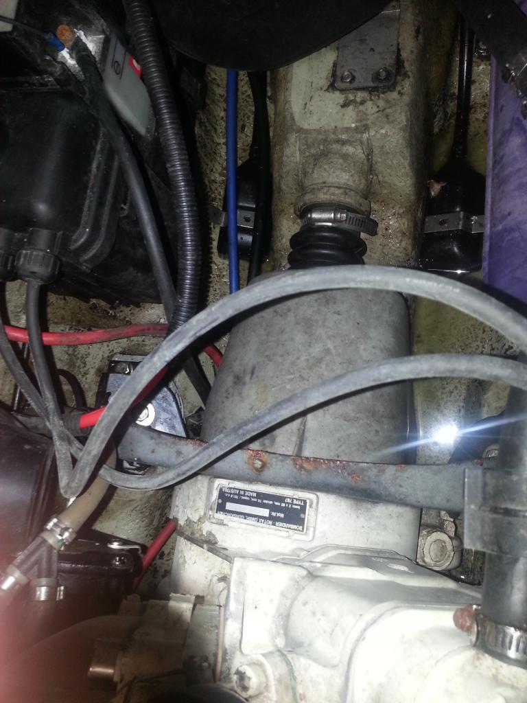

1. Pull the motor just to clean everything inside
2. Clean the raves
3. Change oil lines
4. Change fuel lines.
5. Weld the head pipe
6. Paint the motor and pipes the factory colors
7. Rebuild the carbs
8. Replace the vts housing
9. Change pump oil.
10. Right now it has an oil injection block of kit, he wants the injection pump back.

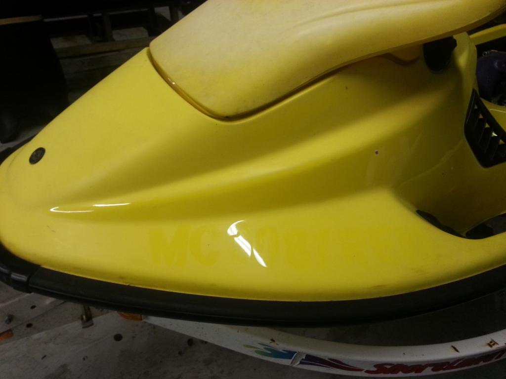

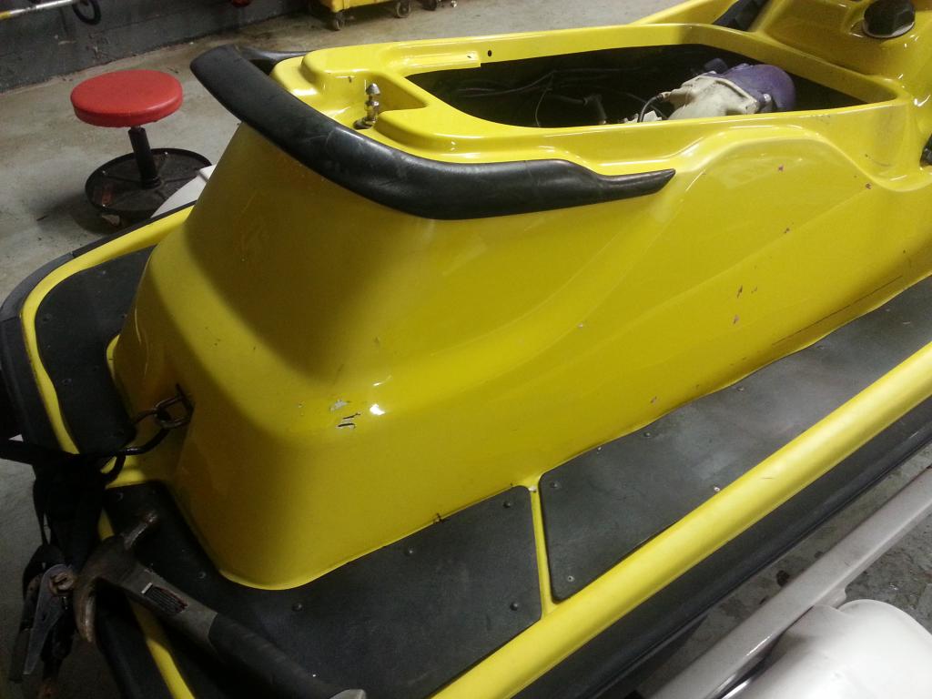

Today we already stripped the graphics

JSG you almost gave me a heart attack when you posted those pictures of that mint 96 in the first post. I thought you were going to strip the decals off that one until I read that last line. Should look really good when done! Sub'd

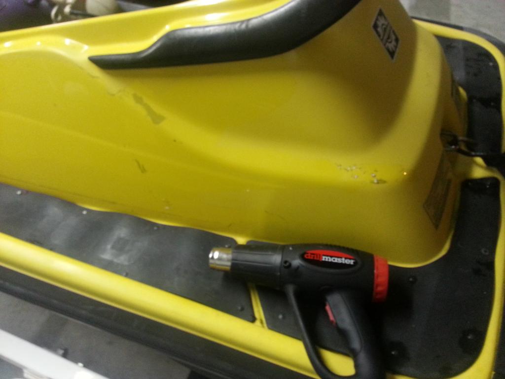

the one method I had the least favorable results was the heat gun, although I think we all know the heat gun is perfect for the corner bumpers.

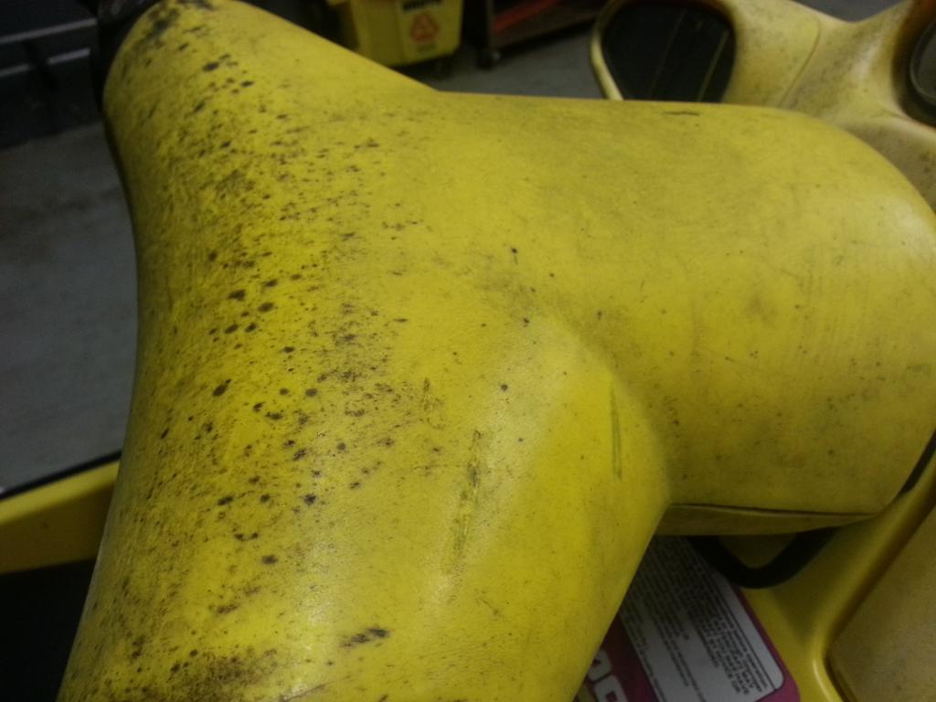

I just got one of these recently, I got lucky as mine looks much better than this one. I will be watching the pros do there magic here and following along. I got the same deep mold looking stuff on the soft handlebar cover; is this curable or?
Nice! Did Mike have the perimeter of the decals already? That is the big thing in getting them to the correct size. I know when I talked to him I think he said he was going to start working on those, I think he has a 96. Can't wait to see this neglected unit get brought back to life.
He does not have a 96 set ready to go, he has some pictures from someone but the graphics were faded. He is going to get my pictures and then send me some back with points marked for me to measure.
The heat gun trick works well on the 96 gsx hoods as well. I think anything with a dark color will work.

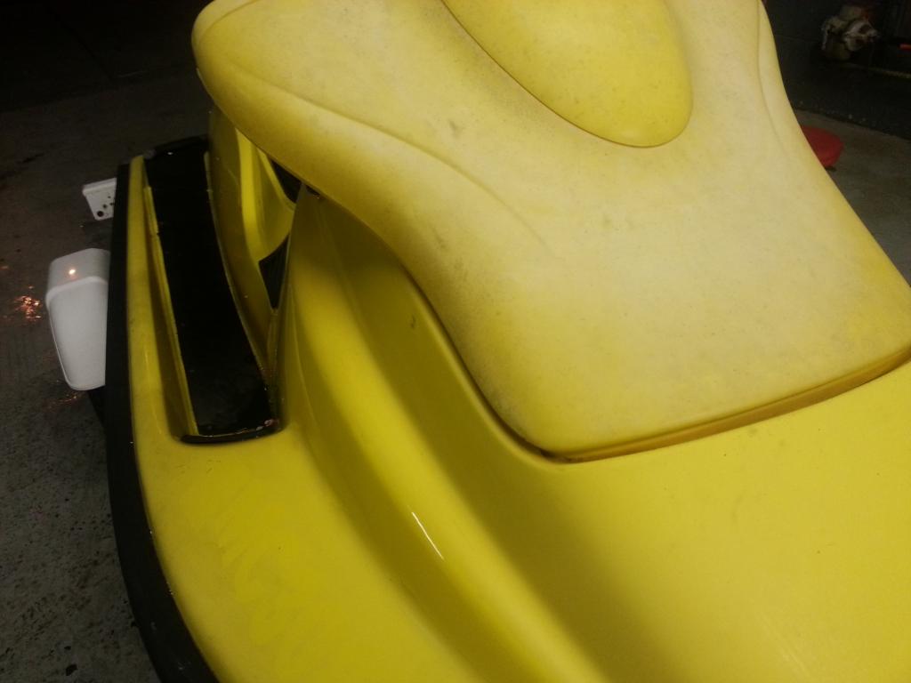

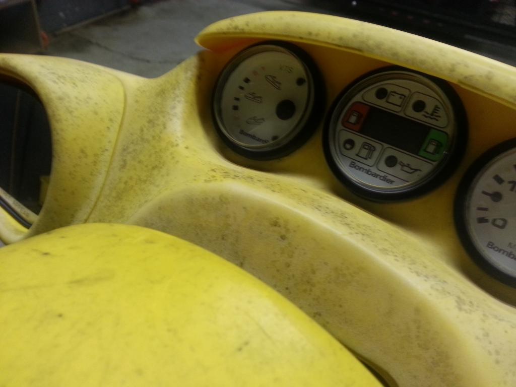

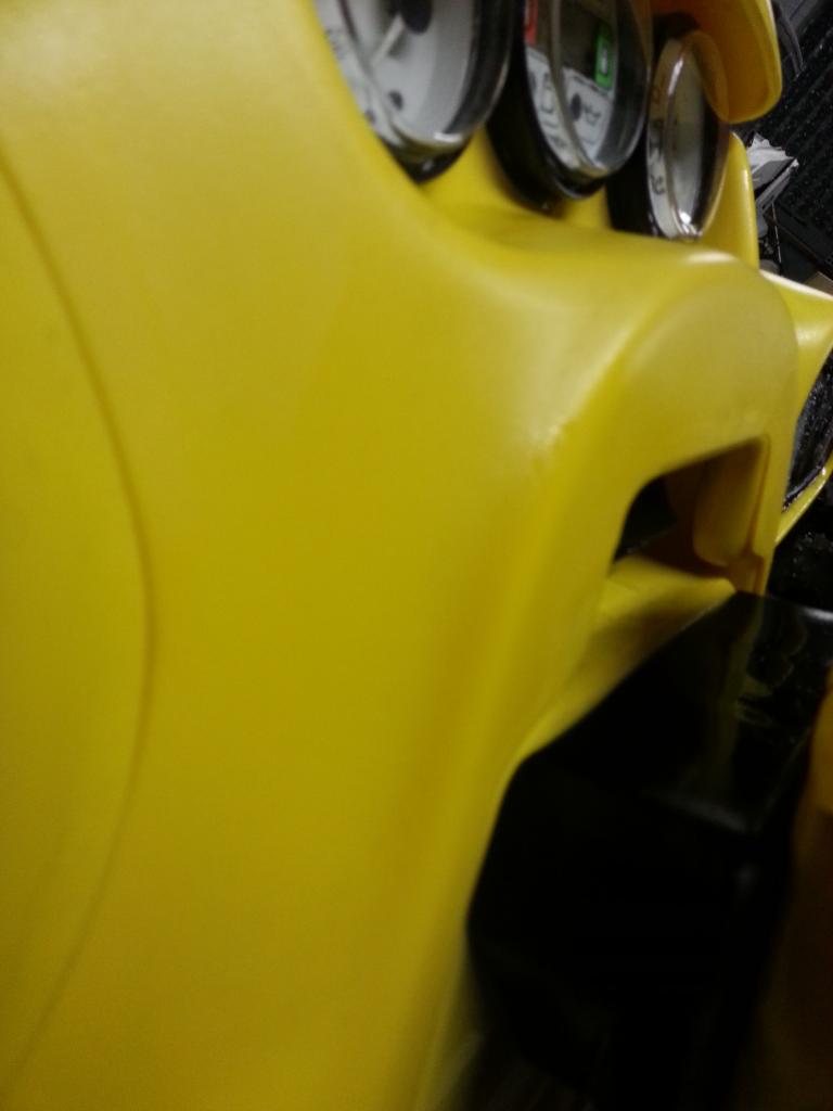

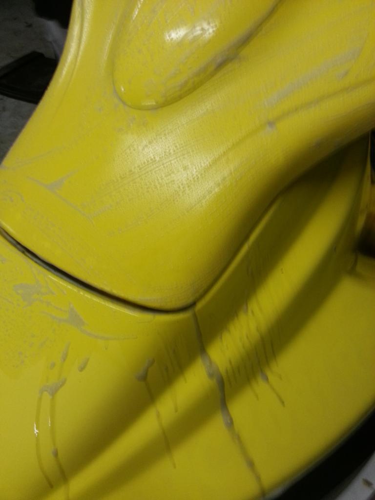

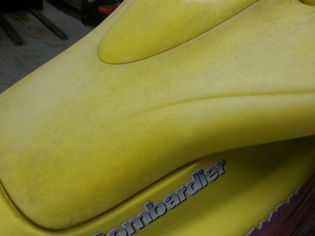

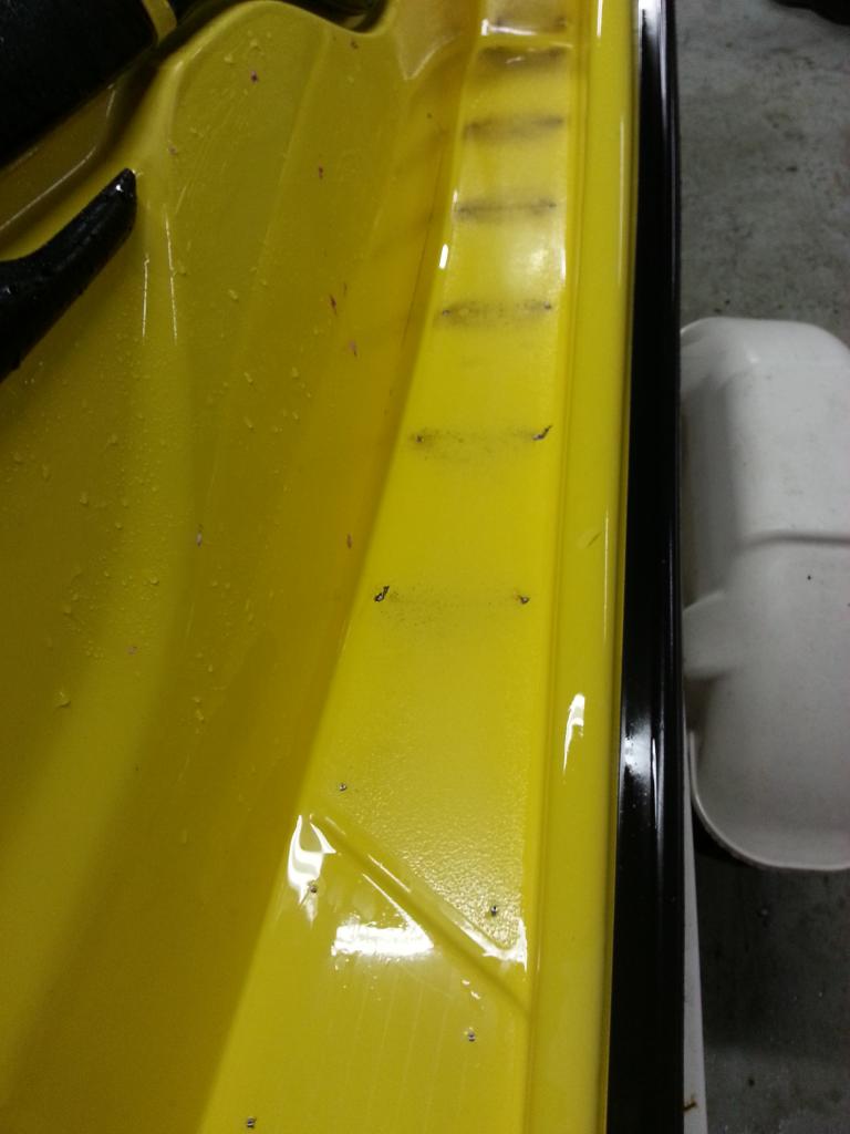

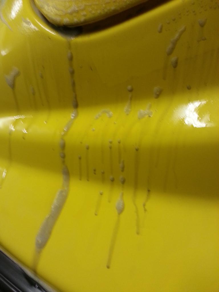

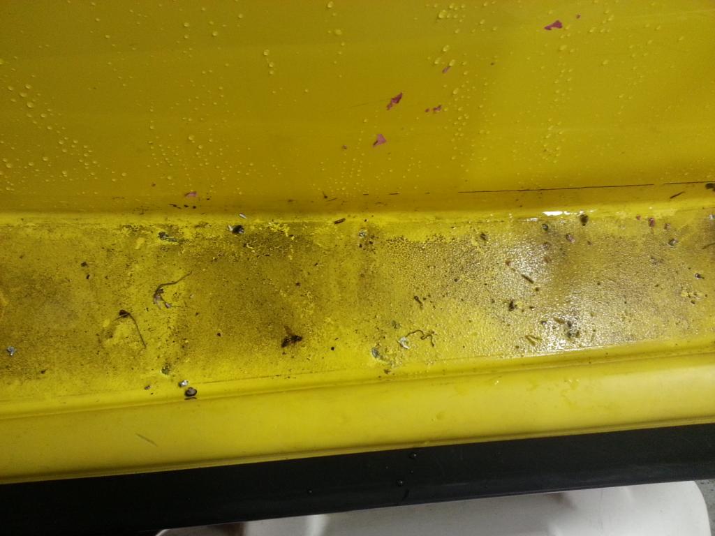

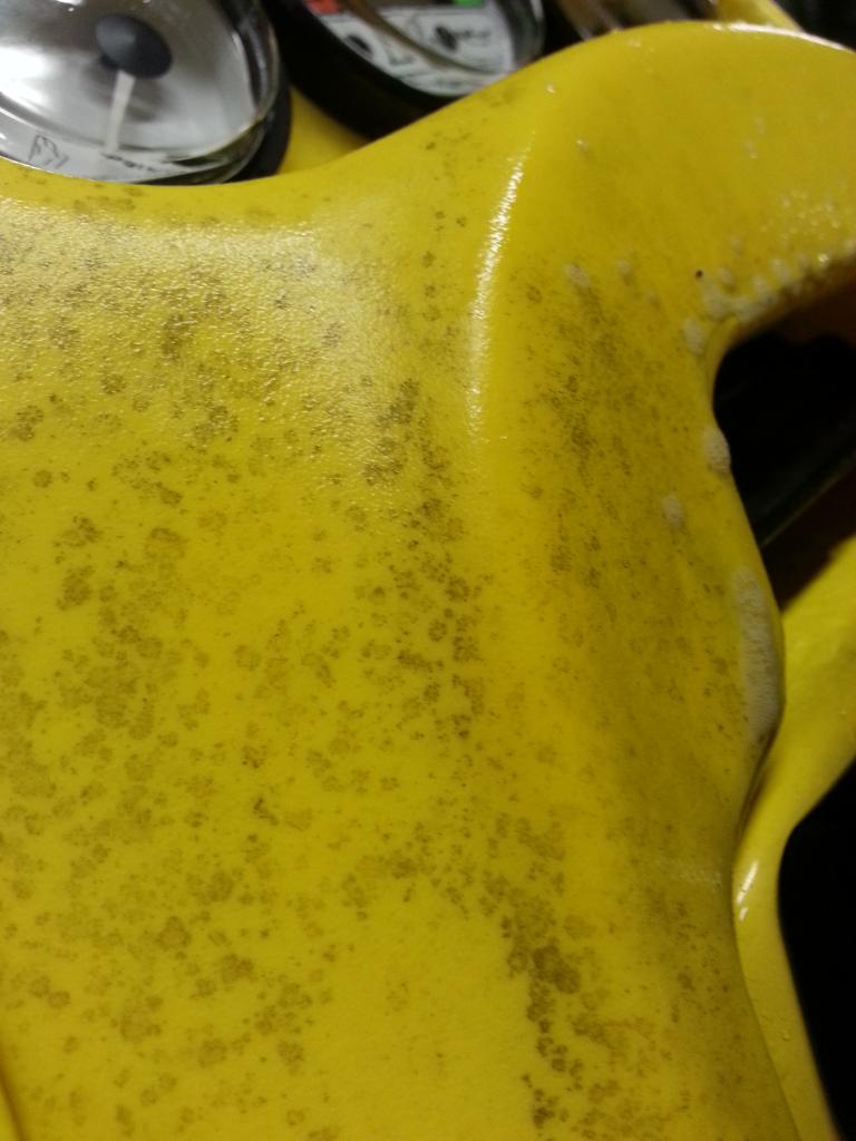

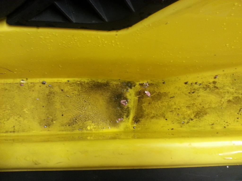

We also started to clean up the hood. It was really rough. We took degreaser and a scotchbrite pad and this was the results.
Oh we also noticed the mirror was cracked. We will replace that. The hood still needs some work but has came along way already.

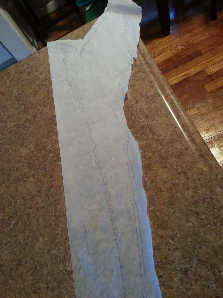

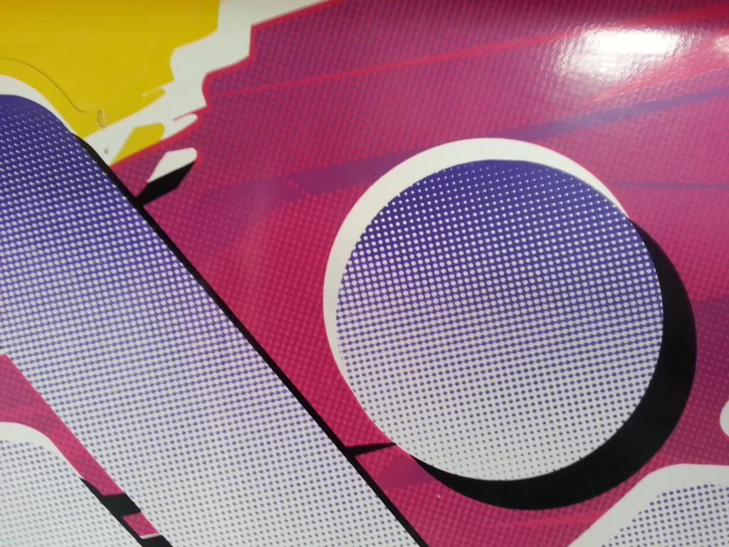

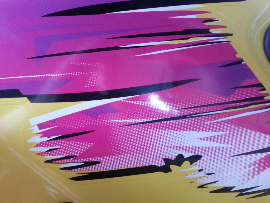

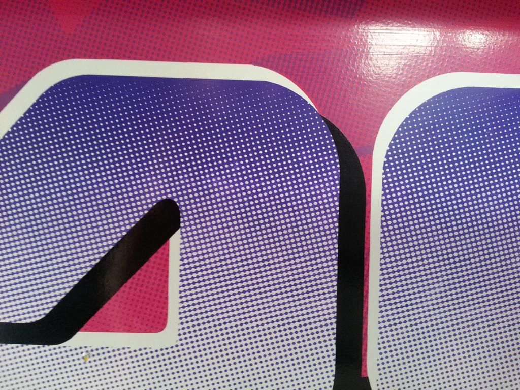

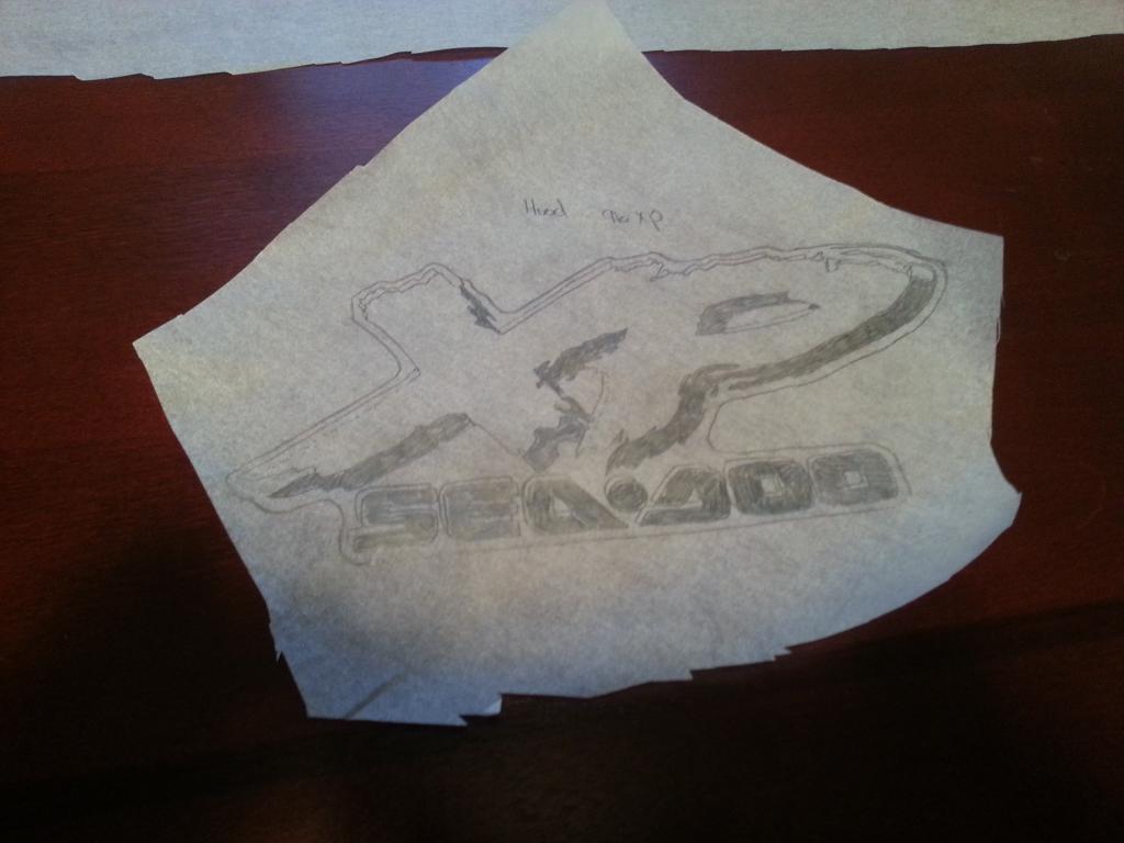

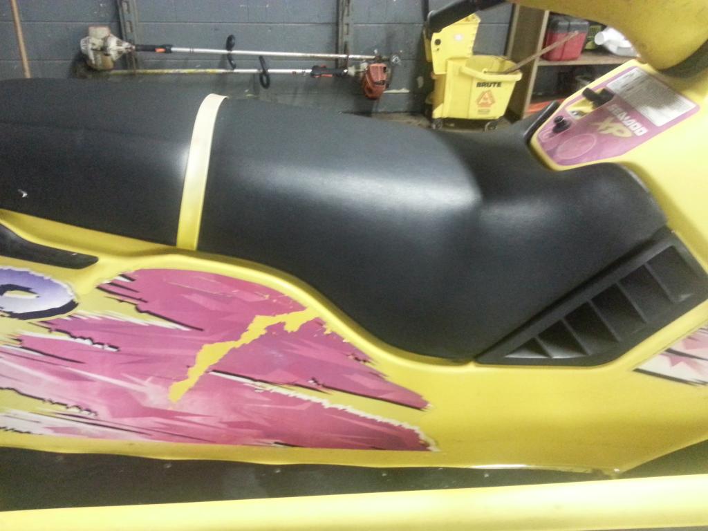

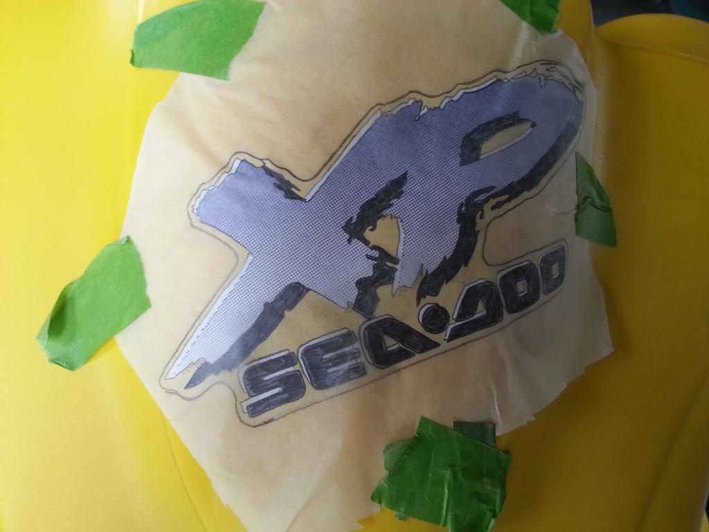

Today I traced the graphics to send to Mike. I took over 100 pictures. I took a bunch up close to show the detail in the graphics. I never knew how intricate they were until I saw the decals on this xp.
It took me about 4 hours, I traced the hood decal, the bombardier under the hood, the front left decal, the rear left decal, and the bottom decal.
Look how much is going on. I never saw the little dots and diamonds before, they even faded into each other
Isn't it amazing how much detail was there. When Mike and I talked the other day we were talking about your ski
