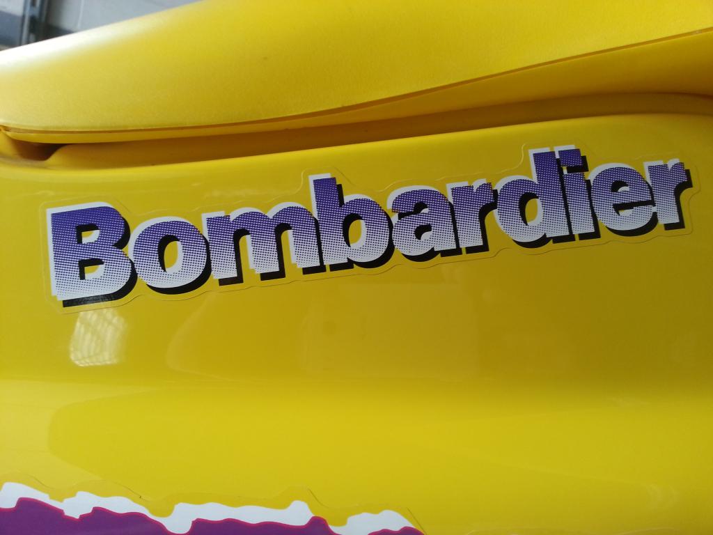

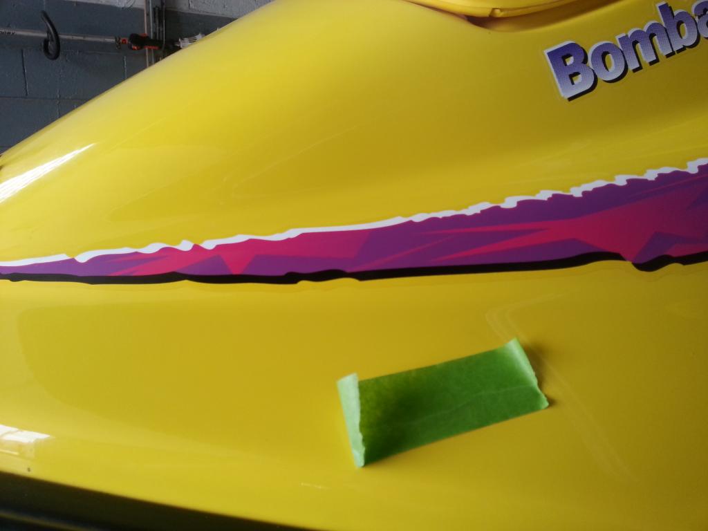

Isn't it amazing how much detail was there. When Mike and I talked the other day we were talking about your ski

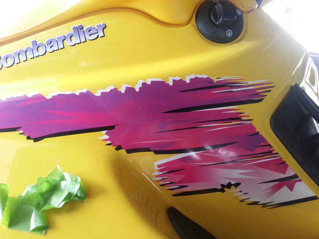

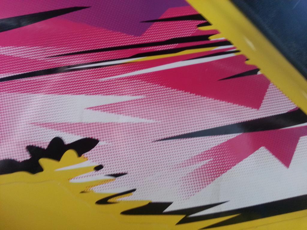

He wants pictures straight on, the problem with that is when you try to get the shot of the whole decal you need to be far back. You end up losing the picture quality. So I took some far away shots and then a bunch of close ups.
They dont get much cleaner than this.
That picture is funny. The guy is almost completely covered all he needs is a ski mask and the girl has the good ol high arched hip (baywatch style) swimsuit of the 90's where it looks like she has nothing on. She is also wearing all five colors of the graphics, purple, pink, white, yellow and black. So was it cold or hot that day?
I wonder if he could use the 95 color palette on the 96 graphics. I MAY be in for another set. Mine are starting to peel up in places and exotic signs says I'm 2 years out from my order so they won't do anything( other than cut me a deal on new graphics which are still more than PWCgraphics). :( Eventhough I maybe have 20 hours( super high estimate) on my resto and it stays in a climate controlled environment when I'm not riding.

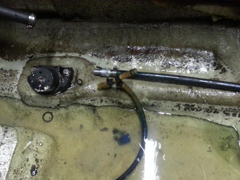

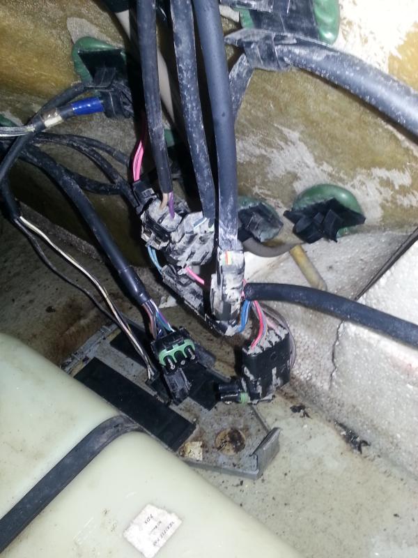

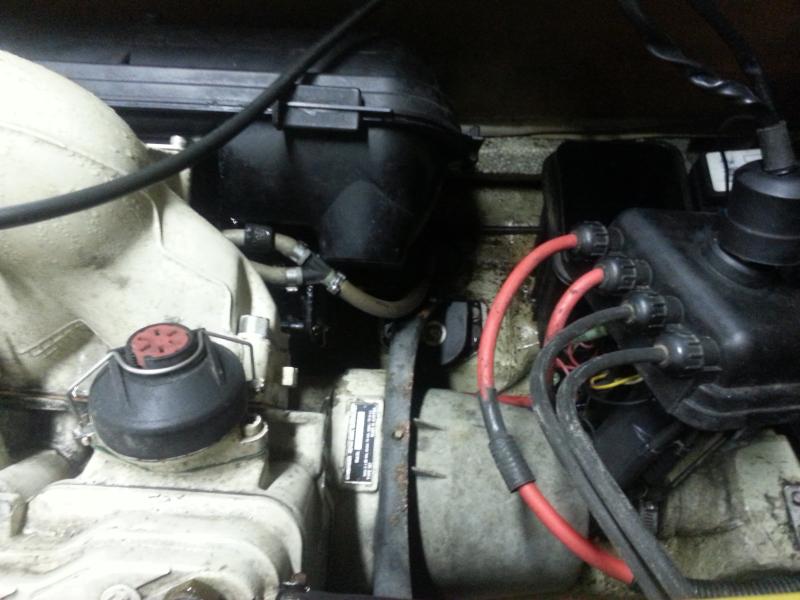

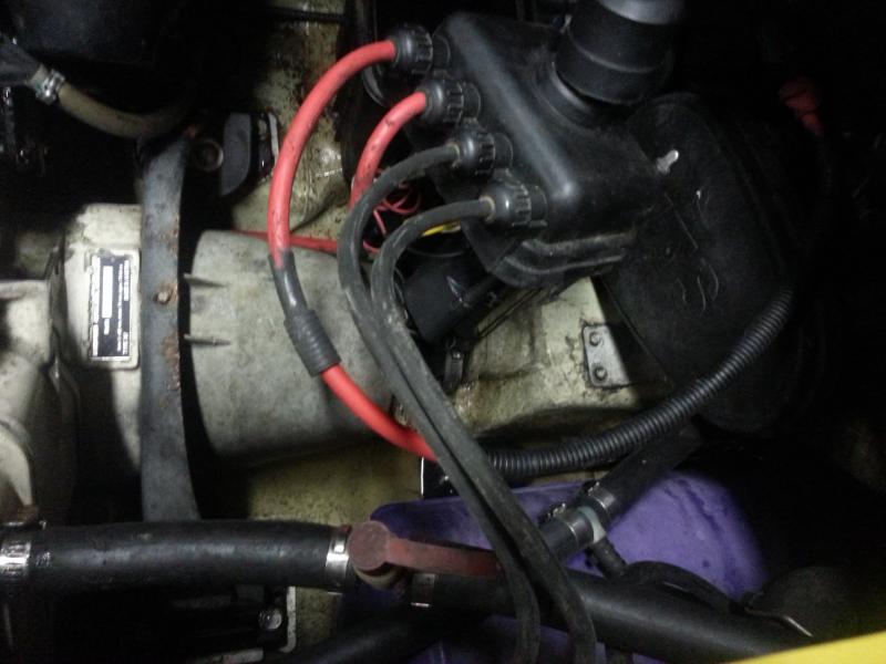

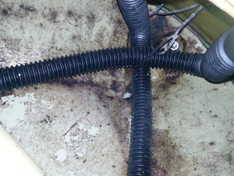

Ok just got back from the shop. We stripped it and gave it a good scrub.

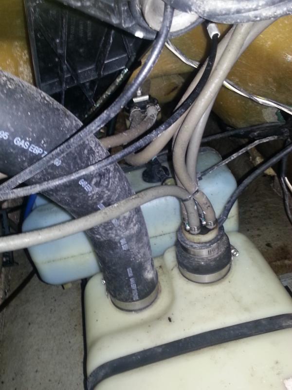

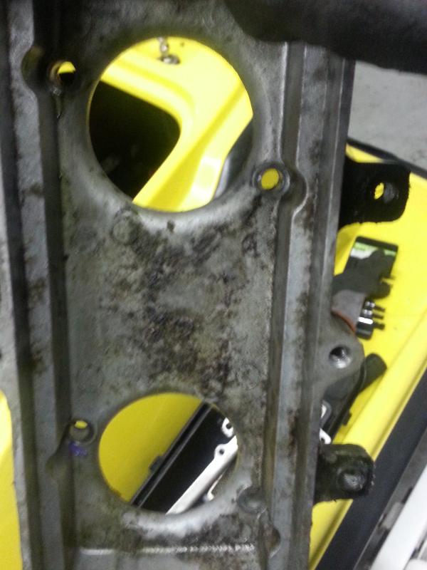

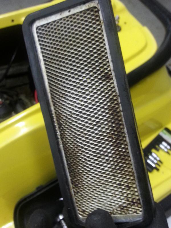

The flame arrestor and bracket were nasty

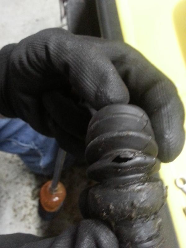

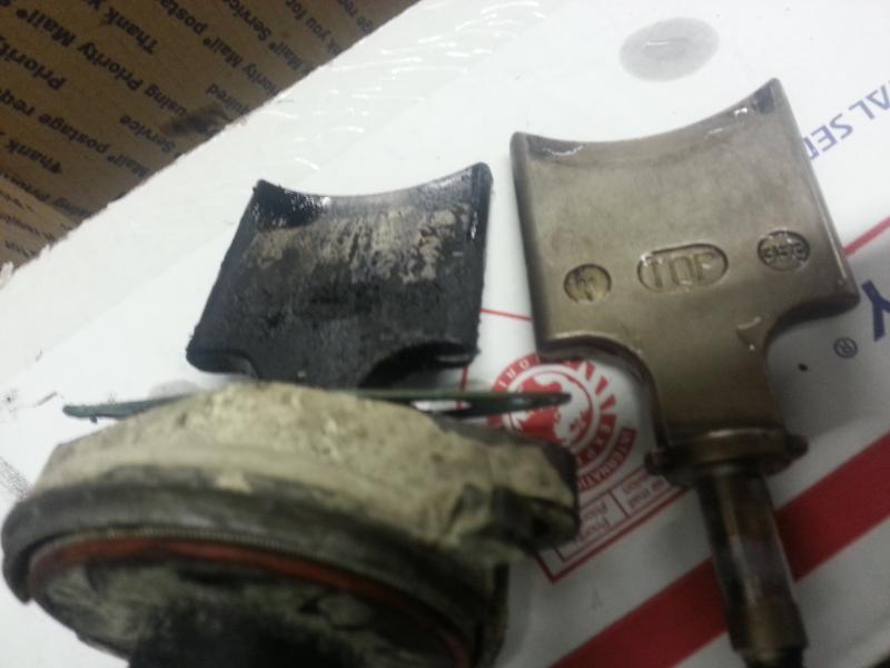

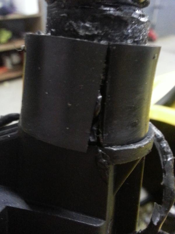

Vts sleeve was cracked
The vts boot was ripped

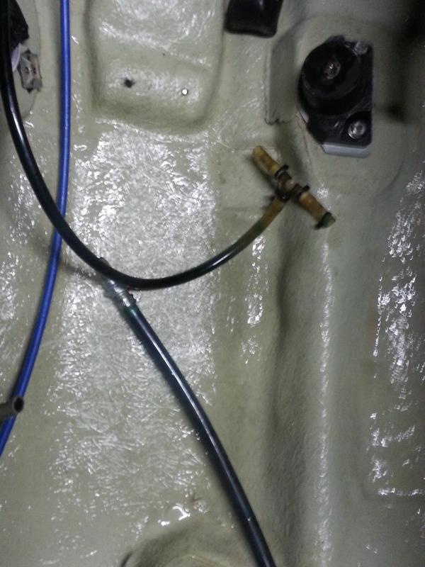

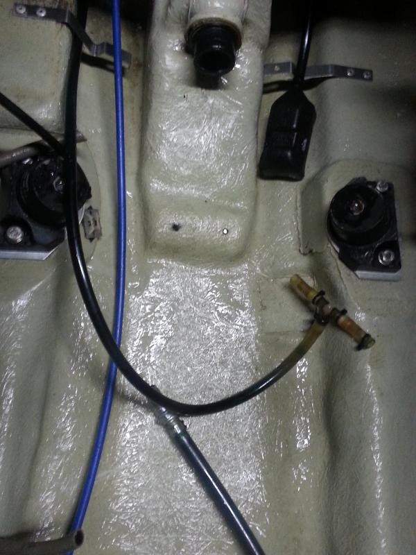

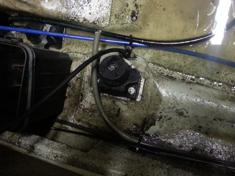

The motor out and the filthy hull

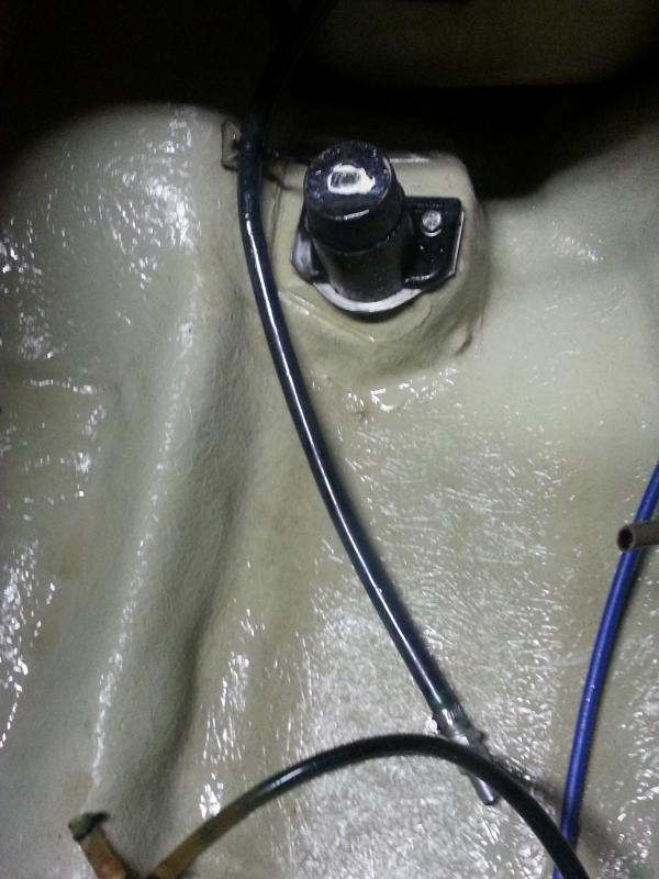

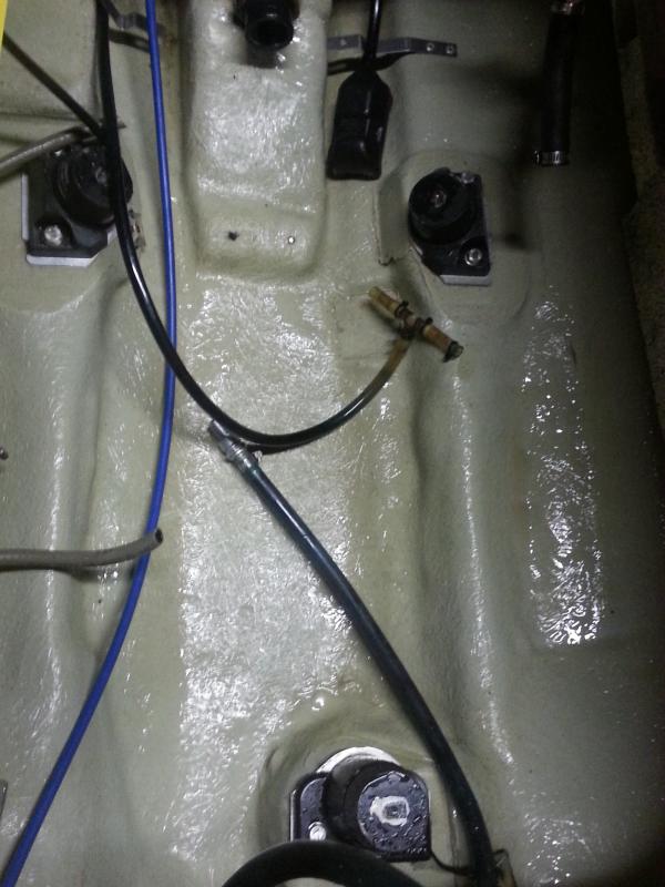

All cleaned up, we used degreaser and a scotchbrite pad. Then rinsed it with warm water and repeated a couple times. We also tilt the hull to the left and raise the nose us a bit when we rinse it. The 96 xp only has one drain plug so you need to get the water to rush out that side with the plug. Spx's 97-99 has 2 drain plugs so you do not need to tilt it.
I always love how clean they get with just a little but of elbow grease.

Fuel line-$30

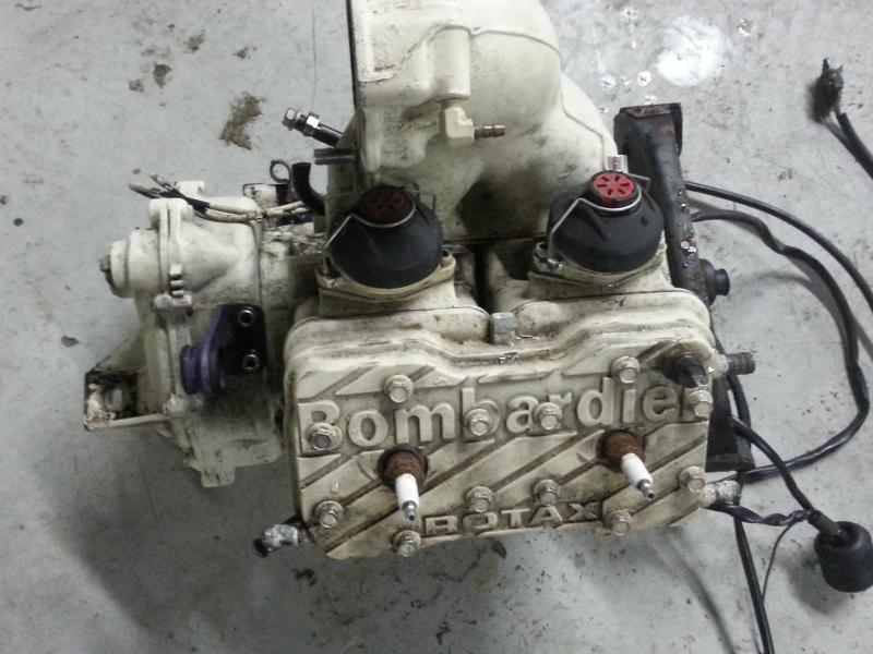

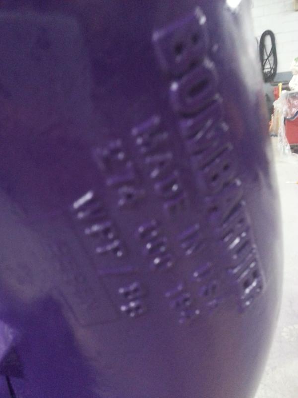

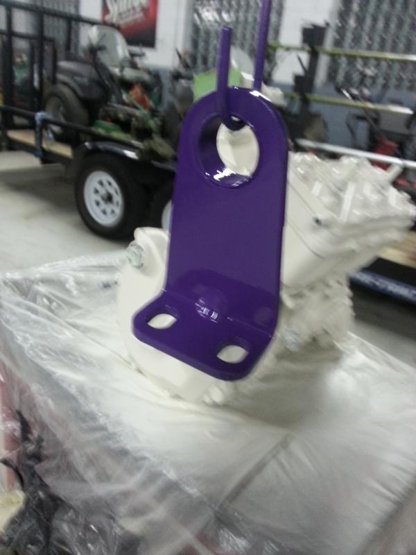

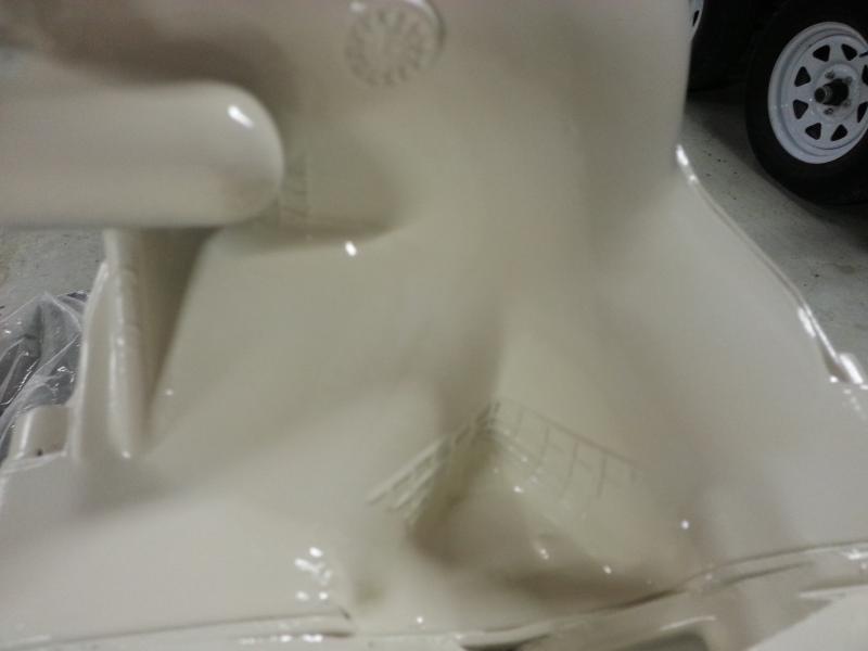

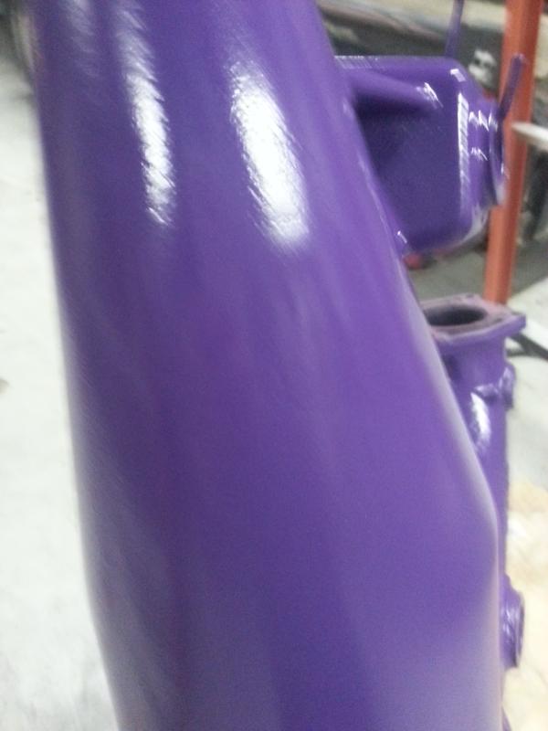

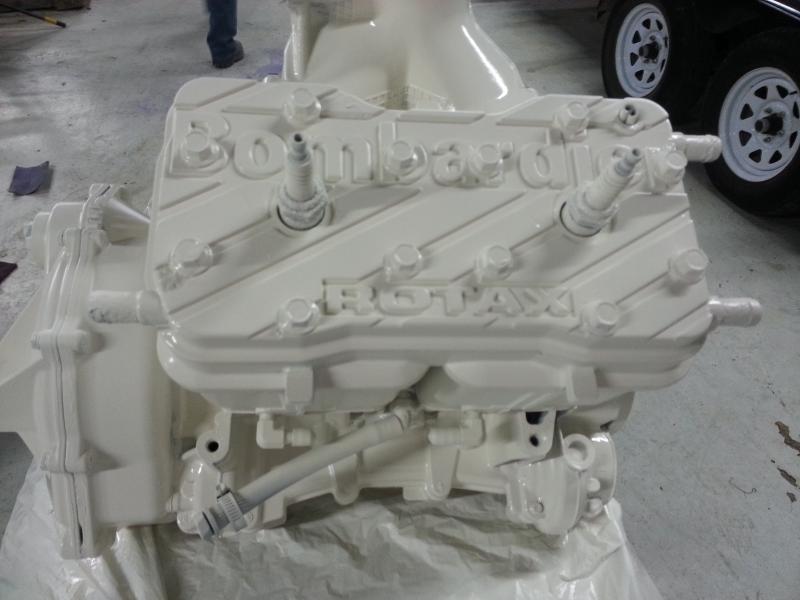

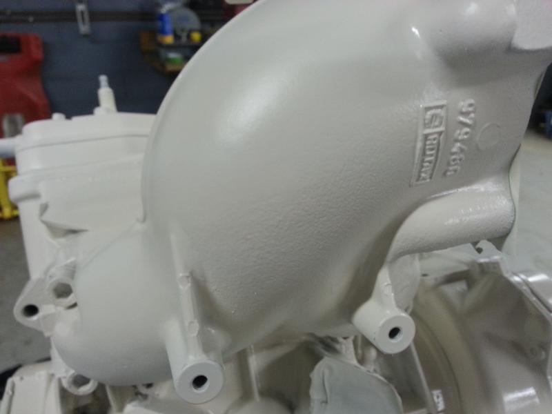

Today we cleaned the motor, wire brushed it, scuffed it with 220 grit sand paper, then we cleaned it with degreaser followed by acetone.
After all of that we painted it. We found a paint that is close to the original color at lowes. I do not recall the actual name of the color right now but I will post it at a later date. It was valspar brand. We went there to get the sumptous purple that [MENTION=57920]racerxxx[/MENTION] used on his 96xp resto.
Started out like this
And now
We also started to paint the purple parts, they started to get sanded as you can see the purple paint on the floor but we ran out of acetone so this is all that got painted purple
My future brother in law painted his with bilge paint from west marine. He used a grey color and it turned out nice, but you need to take everything out of the hull. It is oil and gas resistant so it wont peel up. You could use clear I guess but epoxy in the fiber glass pretty much does the same thing thats why these clean up so nicely.

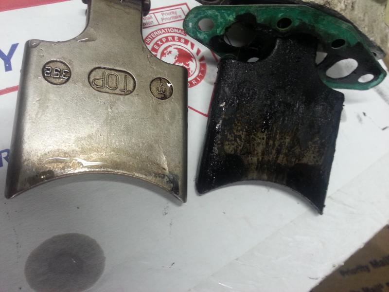

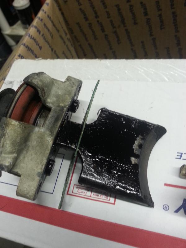

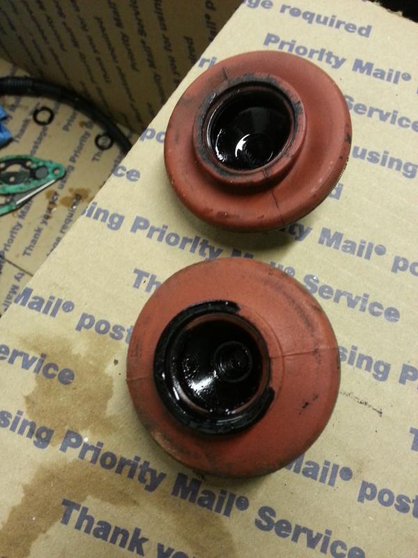

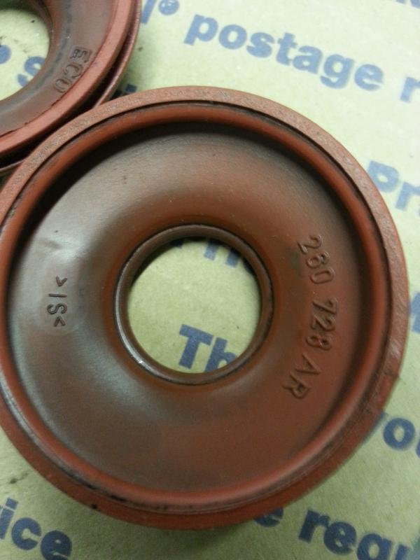

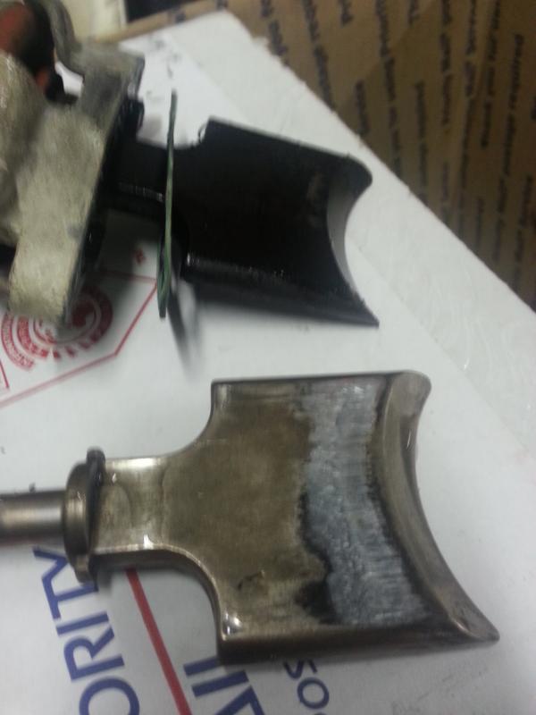

Got back from the sand dunes last night, so tonight we did some work. We cleaned the raves, bellows and housings
We cleaned them with a scotchbrite pad and degreaser.

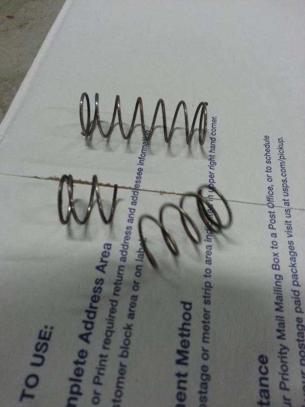

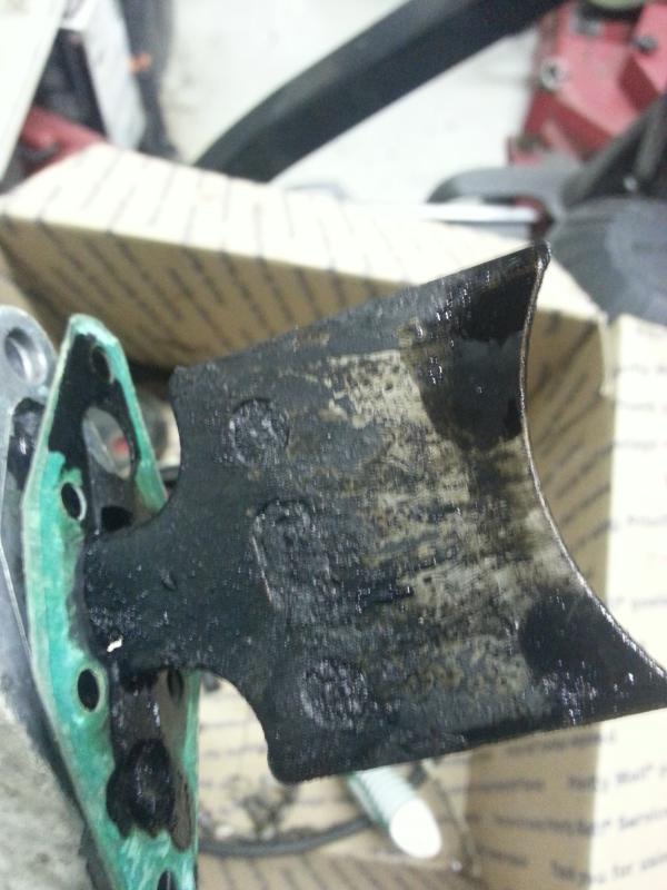

We also found one of the rave valve springs was broken. We will just replace that with a spare.
We also cleaned the flame arrestor and bracket. We also painted sanded and painted the rear motor mount bracket. It was badly rusted. I forgot to get pictures of them.

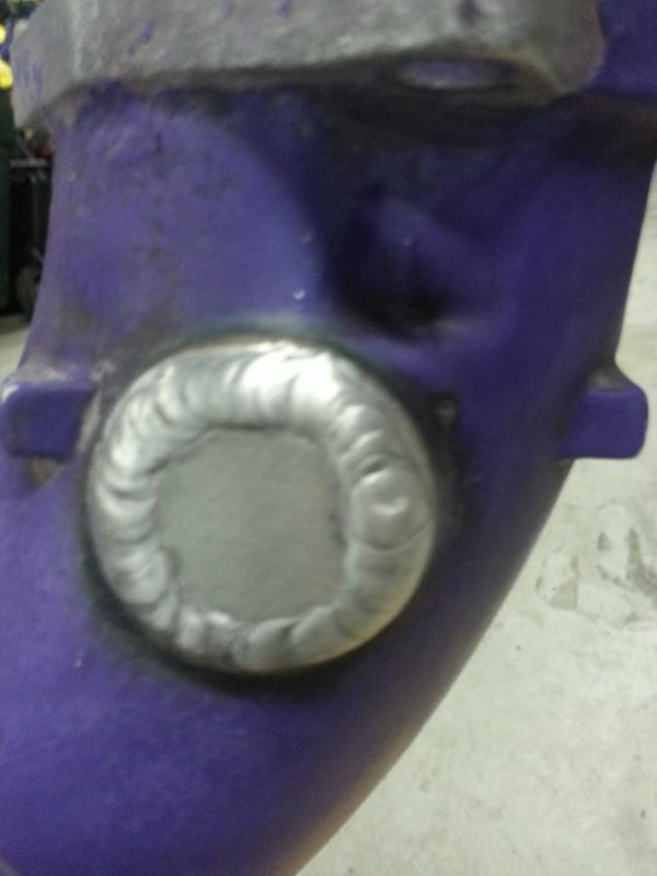

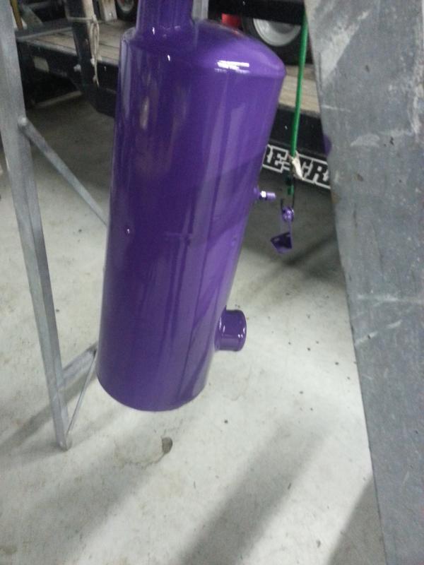

We also painted all the purple pipes.
The welch plugs were already fixed.
We did not want to split the pipe so we taped the clamp.

Also, I am already in the process of repainting my tuner pipe/exhaust. I WAS going to just paint it the same color as the motor, but then I saw your pic with the purple and it looks AMAZING! I saw someone else's ski on here too that was painted that purple color. Love it!
So, [MENTION=51350]Jetskigoodies[/MENTION] , can you PLEASE share what brand/exact color name/where you got it from?
