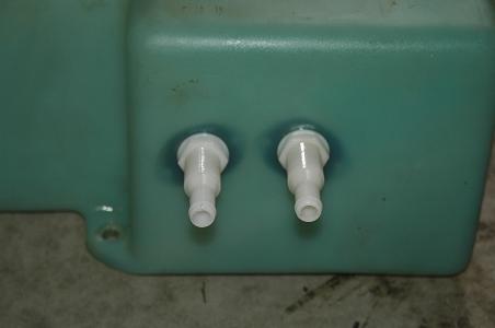

Well, I finally got a day off where the weather was decent and I had free time to track down this leak. Pulled the engine most of the way out, and all fittings were dry. Only a half quart of oil in the reservoir, so I put it to the side, dried it all off, and started working at reaching and replacing the ends of the hoses where they go into the block. About an hour later, I see this...and notice how little oil pressure is on it. Just that 2-3 inch bit in the hose is causing this little bit of leak. That is why with a full tank, it was dumping it all in a week.
I think I will go with the thru-hull fittings like I saw in a similar thread. http://www.seadooforum.com/showthread.php?t=10550&highlight=hull+fitting+oil

Glad I found it too, but in the process, I had to take off the exhaust, lift up the engine, break a couple of bolts, etc. It just goes to show how much corrosion this old XP has, and has me thinking about starting to save up for a new SBT rebuild...
I could almost not justify doing all this work, thinking that anytime now, this engine is going to crater on me.
