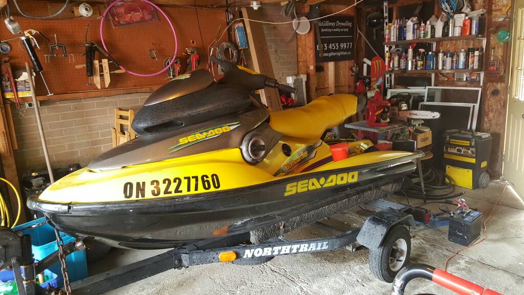

I pulled the mats and reg numbers. The gel was super dark under the numbers.image.jpg
I've started wet sanding with a 320 grit and plan to step up to 800 then 1200, 1500, 2000, 3000
I haven't considered taking off the rub rails but with Adams thread I now know I can get the rivets I might pull them off
Your wasting time over 1500, 320 to 800 is took big of a jump, you need to hit in between the 800 first. Pulling the rub trail is the only way to go. I've done a few x4 restos that by the time I'm done taping and being careful not to mess up the rails it's just easier to remove them.
I've been working on one without removing the rub rails. It's a biotch. My gel coat was not uber faded. I'm contemplating changing my decision on not removing them.

If your talks are not smooth and are Sun damaged then you can leave them. But if they are it's easiest to do the lacquer thinner clean up with them off.
Ok so after wet sanding I used a diamond cut compound two coats. One coat of swirl remover. And then a nice paste wax. Turned out really good. I didn't do under the bumper rails yet maybe tomorrow.
Everything turned out great with the rest of the wet sanding
