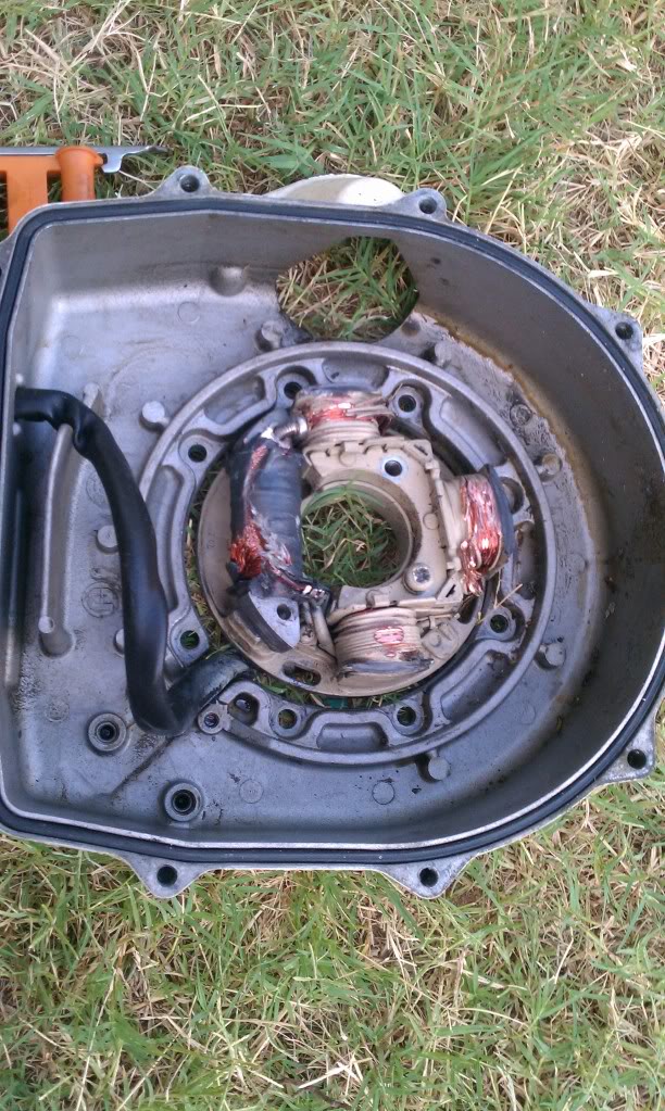

Ok. Trying to figure out the prob with my ski. I was having a fuel delivery prob and have since replaced gray lines and cleaned all fuel related parts. Took the ski out for the 4th weekend and it ran great , the first day. Ran through one tank of fuel and half tank the next day and then it just died on the water. Swam it back to shore and found the 15 amp fuse blown. replaced fuse and now it only cranks and i seem to be getting no spark. Figured i would ask and see if anyone can point me in the right direction.

found the problem. Anyone have a stator assy for a good price.

yeah one of the phillips screws came out and chewed up the whole mess. Looks like someone forgot the locktight im guessing cause the assy has OEM written on it , im sure that means it has been replaced before.
