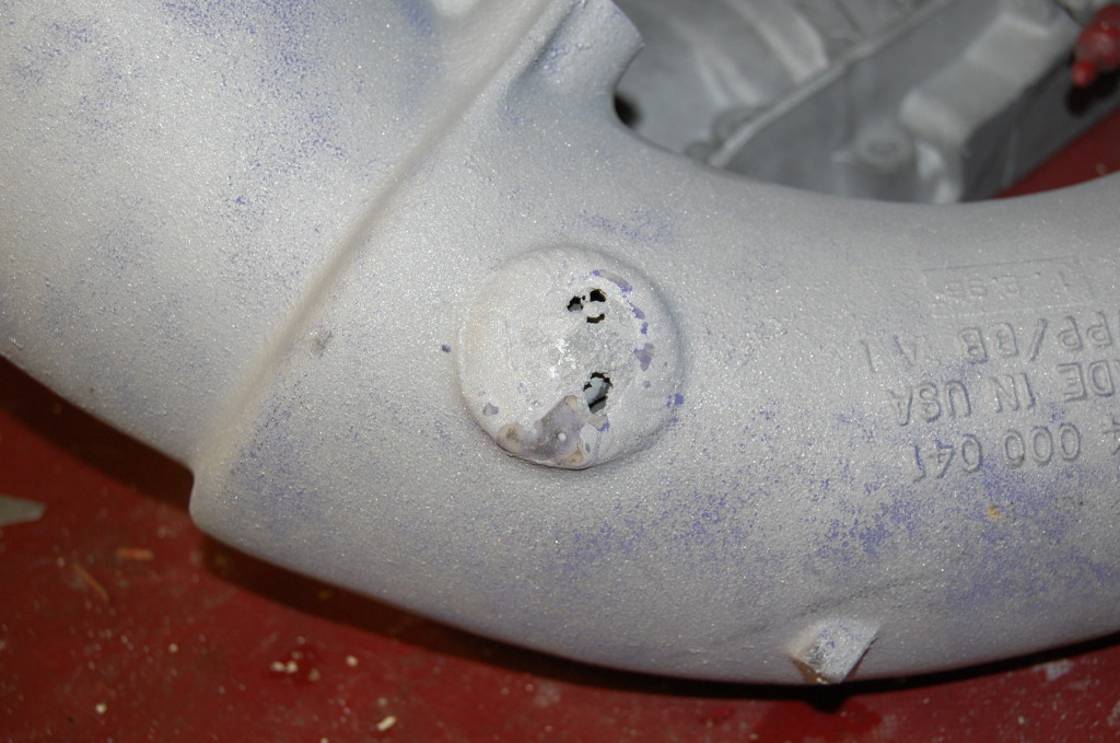

Have you checked for an exhaust leak? A slight exhaust leak will cause a issue like this. Ride it with the seat off and see if it keeps its rpm's instead of dropping them. Also check the Welsh plugs on the pipe to see if they are leaking.

What is a welsh plug? Were is it?
Welch plugs, they are the welded caps on the head pipe. They rot out, typically the ones on the underside of the pipe, they hold the water. You'll need to have a new one made at a shop and have it welded on. DO NOT use JB WELD as a permanent fix, If you look close I left a small amount of the epoxy on it so you can see how NOT to fix it.
Here's a rotted one
Here's a rotted one
What he said also ride it with the seat off you may be surprised!!!!!
