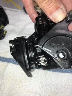

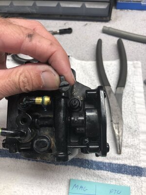

There are three screws. One is the idle, one is a low speed adjustment and the last is the high speed adjustment. Your idle should be set at 2800 rpm out of the water or 1400 rpm in the water. Set the other two to factory, do that before trying to set idle because the low speed and idle work in conjunction.
