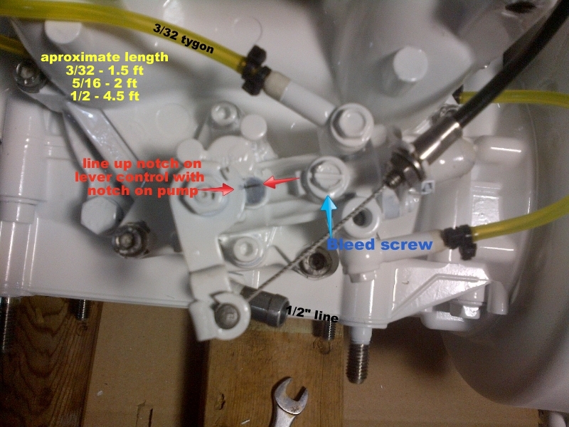

This is a oil pump pic from a 95 XP 720, should be the same as yours.

So in this case, I'm wondering if a picture is worth a 1000 words. Can someone tell me if this looks right? And if not, what's off on it? I am still smoking a lot and idles misses at lot and plugs are wet with oil... Otherwise it's almost like it runs too good otherwise for anything else to be broken.
You can see the throttle lever here along with the piece that pulls the oil injector lever. I actually had to crimp a piece of lead shot into my cable (red arrow) and adjust it all the way up to get the marks to line up on the oil injector. In this position when i pull the throttle, the oil injector lever is as far as it can do and stops the throttle from opening up farther. (I don't this it has much farther to go though)
Here's the oil injector lever. As far as I know, I have the marks lined up. It seesm too far counter clockwise though. As I said you can only pull the throttle so far. I've also read that the lever should be in about the 5:30 position... this looks more like 4:30 to me.
Anyhow, just hoping someone can see this and hope something looks obviously off to someone that knows these better than I.
Your waaaaay off :P
look at the other pictures. look at the two lines, Notice your line is covered up by rust. Notice the distance from the line to the hook of the spring on yours vs the others. Look at the angle of the arm while its at idle position on yours and the others.
The arm is almost straight down or at 5:30 . Yours is at 4 oclock like you said :P
That's why your running so smokey.
At idle that pump flows almost nothing. In the position your in, That is almost 50% flow.
Well, that's obviously my problem then..... so... uhhh, there's two lines? So you say it's covered up in rust? So what is the line I am lined up to now for?
Look at the picture I posted, there is a notch in the arm and a line on the flat circle surface shown by the 2 red arrows. Those to things need to line up across from one another at idle. Scratch a bit of the rust off your arm and it will be a little easier to see the notch.
Yah, I took a wire brush to the arm there... Voila... the line I have been looking for.. thought I was supposed to use that dot. I'm certain that was my issue. Hopefully I can get on the water this weekend and test 'er out.. Thanks all for the help!!!
