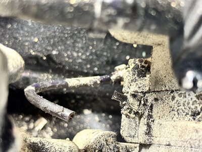

I’m not familiar with the steps to eliminating the oil pump, I have read many times that the oil pump on them is very reliable. If you do run premix you will need to leave the oil tank and line going the rotary valve cavity, Do you have reason to believe that the oil pump is not working? Or are you just concerned because of the small oil lines? If it’s just the lines, once changed they will never give you problems again.
