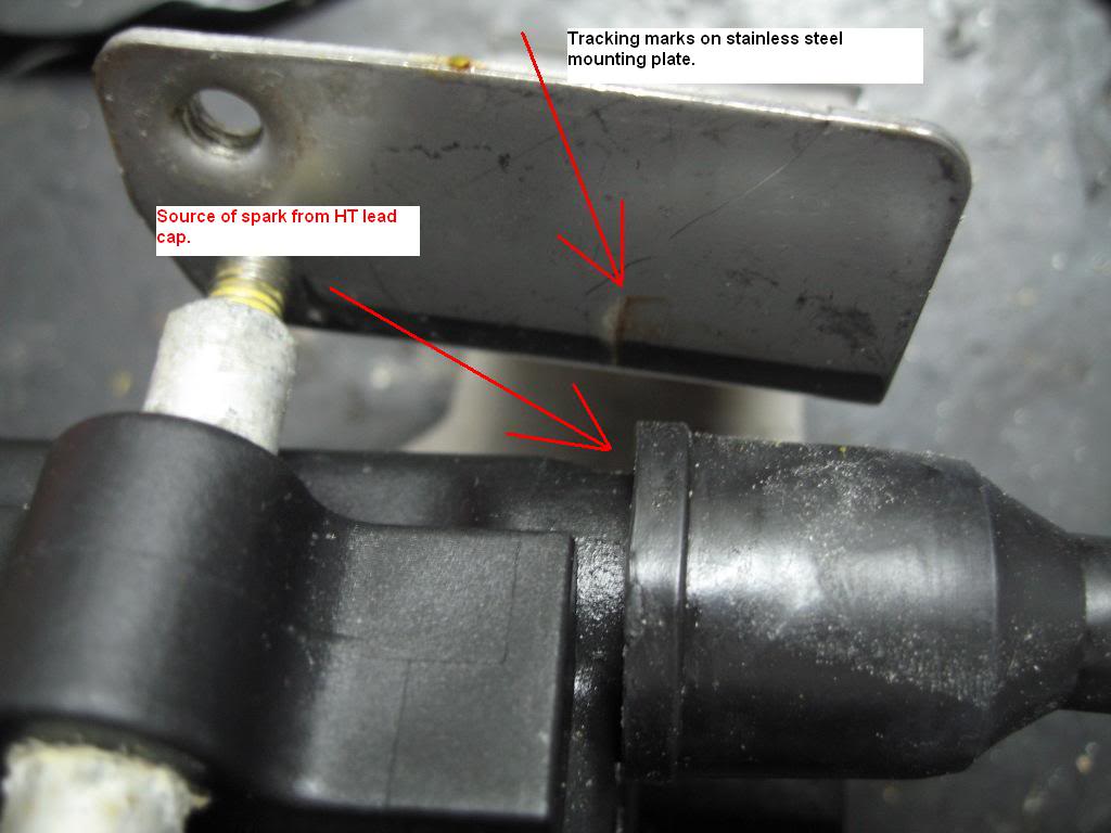

by chance I had cleaned the plugs AGAIN and ran it up. Great on deck but put it in the water and as normal it bogs again. I had read on here maybe and exhaust leak can smother the oxygen in the hull and cause this, so while cruising along I put my hand down to unlatch the cover and BANG!!!! i got multiple High voltage shocks!!!. mmm a lead I think.
So I rip it out of the water and start it up on deck. remove the lid and I could hear it clear the miss. I then proceeded to touch the stainless peg the lid latches onto and BANG!!! a real wopper of a shock.
I removed the storage tray and look at the coil packs and see that they are mounted directly onto a stainless mount that is held in place via the lid locking peg. the top coil pack HT lead is pressed hard onto this stainless mounting plate!!
THE REPAIR
Now if You pull up the rubber cover on the lid latch peg there are two flats that you can get a spanner on. Hold onto the coil pack with one hand and undo the lid lock peg counter clockwise. The coil pack should now come off and you will be able to remove. there are two allen bolts holding the 2 x coil packs to the stainless mounting plate. losen these and carefully inspect the surface of the mounting plate where it sits on the top coil packs HT lead. IF you can see signs of tracking(a spark leaping to places it should not) then I can safely say that this is the cause of all your problems.
now the HT leads are supposedly sealed to the coil pack however obviosly the spark is getting through and it is a bit of a bad design to have the mounting plate so close to the HT lead. these are very high voltage and the spark will track through any week link instead of going to the plugs where it is supposed to hence the missfire/bog

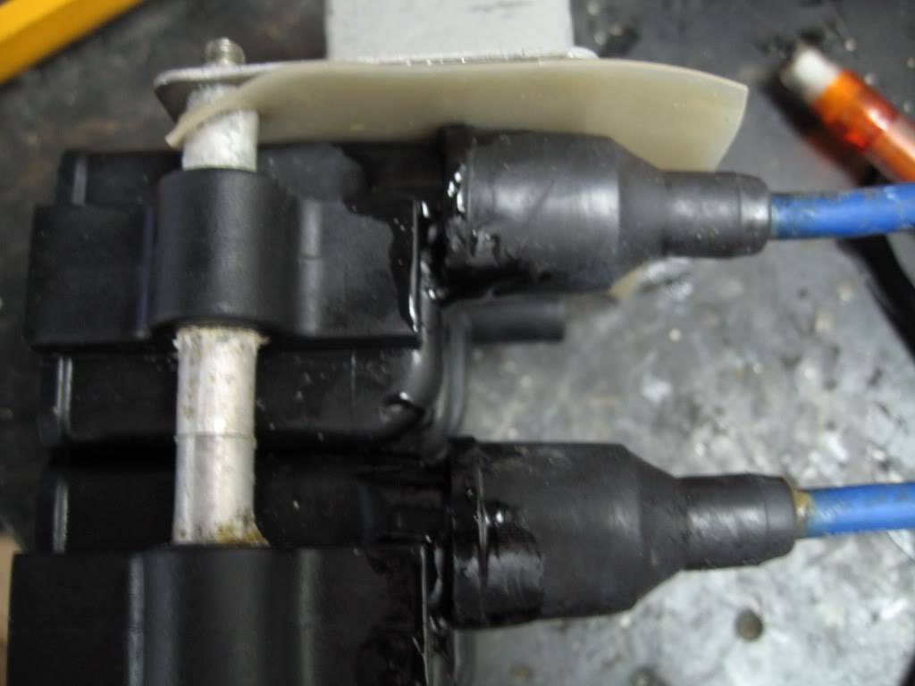

my first attempt was to use liquid tape on the HT lead and a small piece of rubber under the mounting plate(as per pics) and this sorted the problem for 30 mins. on inspection a small amount of water had wetted the area and made a track to the mounting plate at the back where I did not have enough excess rubber overlapping the plate.
my solution was to excessivly coat the HT lead(including lifting up as much of the cap and squirting it in) with silicon/Sikaflex. I then made a thicker rubber plate which was almost twice the area of the mounting plate. then bolted the coilpacks to the mounting plate and applied more silicon/sika between the coil pack and the steel spacers that the bolts run through. I then covered the whole assemble with a ziplock and then replaced.
MK 1 attempt .you can see on the left the rubber does not overhang the plate enough
MK 1 attempt
MK2 and final coating of the HT lead.

On fixing this I asked the dealer that still has our old one in bits if they could check it and low and behold there were tracking marks on the mounting plate of that one as well. All that ball ache for a simple design error.
