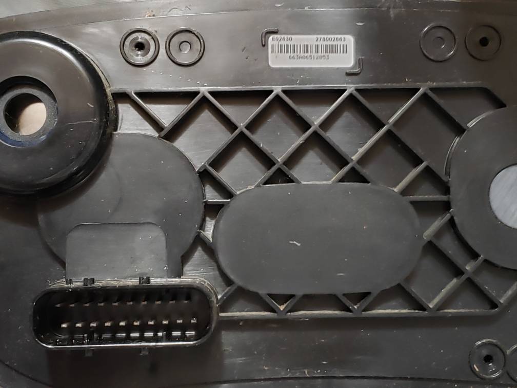

I bought a new cluster off of Ebay. My hrs went to all 999s. It was suppose to be calibrated and the seller stated that it would be plug and play. Well I plugged it in last night and it turned over but wouldn't fire up. Also had a check engine light on only after cranking it for 30 seconds. Which I didnt have previous. Also I couldn't get to my compass but it was getting late so I had no time to test my old cluster. Even though I ran it a few days ago. Do I need to marry the cluster to the ecu. Leaders RPM where I bought it says I dont. I know they made the 155hp and 260 that year. Also not sure about a updated part number but the new one doesnt match the old one. When I searched for the old part number it doesnt exist. I'm sure they updated it. Can anyone shed some light on my issue? My appreciated

For the newer boat clusters from around 2010-2012, hours are only kept on the ECU so your hours will be retained. Older model 4tecs, had hours stored in the cluster and hours stored in the ECU. Your Cluster will also have to be flashed for the 2012 model year boat first, then married to the ECU. Hopefully your tech has BUDS as I've heard there are some issues using Candoo where they can't use BRP software for flashing.
Well when I plugged in the new cluster it read 999hrs but didnt start motor just turned over. I went to my mechanic yesterday and he married the new cluster. The engine starts and ecu reads 102hrs which I had on it. BUT, the new cluster still reads 999hrs. [emoji2369] what can cause this? I plugged in old cluster and still read 999 to and also started boat. Now I have a old and brand new cluster that starts the boat and reads 999hrs.
Needs flashed first and then married as I described above. Without flashing the proper year/model, some features such as hours, rpms, speed, etc may or may not show up properly even though it will run after being married.

The only reason it's saying 999 is because the cluster is not reading the ECU hours properly. No hours are stored in the cluster on your ski, only ECU. When you married the new cluster to the ECU without the proper flash first, your ECU is now set for that flash so any cluster, including your old one, will read 999 because it hasn't learned to properly display the ECU hours. You will need to start over with the correct flash for your year. Never heard of any dealer supplying a new cluster with a flash already on it especially Leaders since you have to marry anyway.
