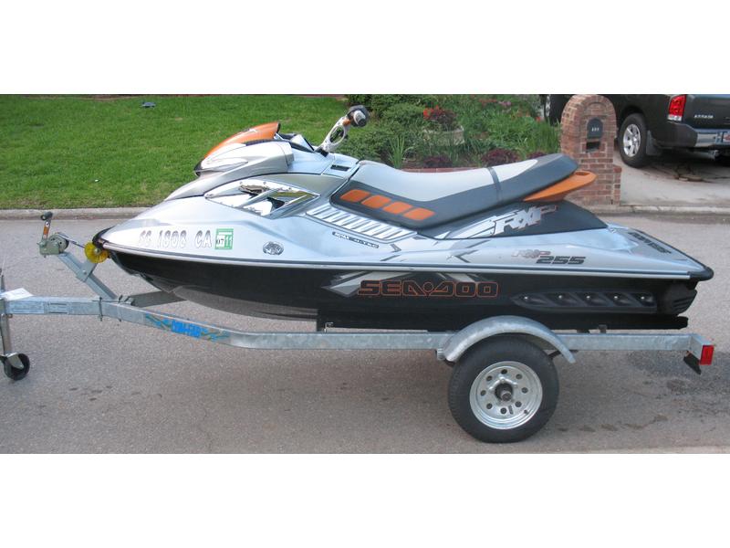

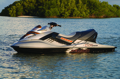

both of the 08 x models look similar the sticker on the side should be a dead giveaway.
If no decals, then the P model has a single piece seat, the T model has a two piece seat. The answer might be different for the two models.
RXPX 2 seater
RXTX 3 seater
