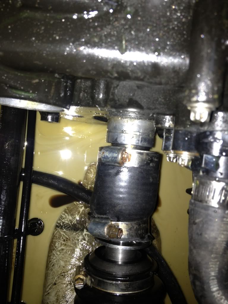

Think this may be the problem.. Came on the ski.. Ghetto as heck and a little fresh oil around it. Is there suppose to be a hose around the shiny part of the cover so it doesn't leak out the back?
What is the proper setup?
