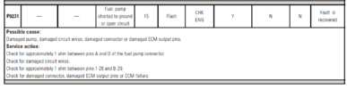

Thanks for the response and question. When I last ran it and checked the code I got the following code: p-0231
The machine will run for about 2-3 minutes before shutting down.

I would monitor the power going into the fuel pump to see if it drops out when the engine speed starts to drop. I am sure once it stops it will automatically shut the pump down.

I do see the ECM reference in the image you provided. I wonder if the MPEM you mentioned and the ECM are tied into the same parts?
If so, I am trying to locate the part and would be willing to replace and expire further.
MPEM and ECU(ECM) are not related nor tied together in any parts diagrams, completely separate and do separate functions. You'll find the ECU on top of the intake manifold which is the same on the diagrams.
I think your shop doesn't really know what they are doing and they don't have the experience to properly diagnose the problem.
I've seen that code before where it does what you describe and usually is ECU failure and not repairable, not MPEM, so requires new ECU. You should check all contacts and terminal connections on the circuit but my experience has been it needs a new ECU.
