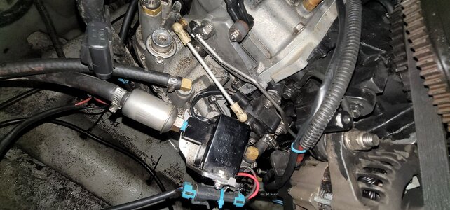

Open the drain screw on the side of the vst. Fuel should flow as long as the key is on. While you are there, do you feel the pump running inside? The pump is on a timer in the ECM, unless the engine is running.
Not sure about your beep. Should be 1sec beep when you turn key to run. Try pulling the blue wire of the bottom of the large gas filter.
Can you define “blew up”?

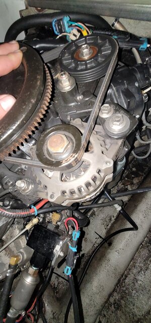

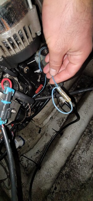

Alternator is like a car. Put a voltmeter on the output to check. That should show any “drops”. Check all your ground wires. There are several. No green connections allowed.
Ok, so maybe I'm being a little over cautious but its not as simple as that. I have checked the output from the alternator and it usually is sitting at around 14.2V sometimes dropping to about 13.8-9. I have narrowed it down to 2 things. Either the alternator somehow having a drop in volts is making all the electronic components go crazy resulting in a irregular Injection pulse from the ecu and causing the each bank of cylinders to misfire ultimately dying down and stalling. Or, I believe its either one of the temp sensors on each bank of the cylinders. I did notice that the engine will start up and run perfect when I swap one side of the wiring harness for the temp sensors to either port or star side but when I swap vice versa it will start up and immediately start chocking up and eventually dying with bunch of smoke(unburnt fuel) occasionally causing mean loud backfires. Excuse my ignorance but I am not sure which bank the yellow sleeved wire harness clip goes into? Right now I have the yellow sleeved clip for the Temp sensor connected to the Port side of the engine Starboard side in order to get it all cleared up and running all cylinders without chocking up and able to move it into drive to rev it up but then I do notice the Startboard side of the engine gets significantly hotter than the Port side. Not sure if this makes sense since I'm dumping all the scenarios at once but hopefully you get what I'm experiencing.

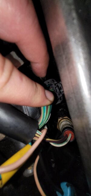

This brings me to a segue question which is kind of bizarre to me and hopefully you can answer. Does it matter which of the two plugs for the head temp sensors wiring harness you use on the starboard or Port side of the heads? One has a Yellow sleeve on it and they are both keyed the same. Interestingly enough when I got some life out of the engine or when it finally cleared up and stopped flooding or misfiring I had unplugged the one of the temp sensors on the starboard and the yellowed sleeved temp wiring harness plugged into Port side of the head with the intake manifold temp sensor unplugged also. I would like to know if you could help me understand how these three sensors communicated with the ecm to add or lower the fuel being injected.

Going back to the alternator which I'm almost positive is over charging or dropping volts at times, here is why I saw its the alternator and I will tie it all together at the end. While troubleshooting in the very beginning and crank the engine when I thought the injectors weren't getting fuel, I did touch the alternator physically and while the heads were cool to the touch because of constant running water the alternator was almost burning. At one point, I did end up putting the volt meter to the battery and as soon as the engine started to misfire or hiccup while running I noticed the battery voltage drop to 6v and back up again sporadically up and down. Now there could be an issue with the alternator if the engine is running but misfiring at a low Rpm which Could draw more power than the alternator can output because it's spinning too slow, but at the time the engine was staying alive so it had to have been at least 900-1100 Rpms.

Is your alternator belt driven? Hot? Are you absolutely certain it is wired correctly? A bad battery (won't take a charge) can make alternator run hot.

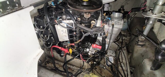

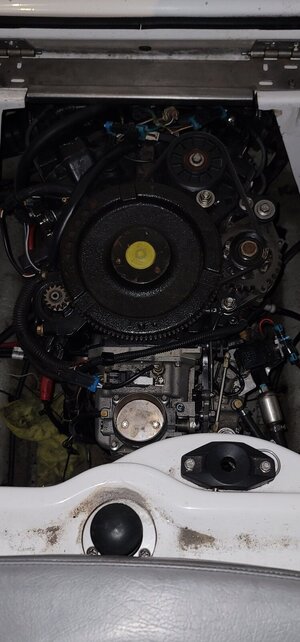

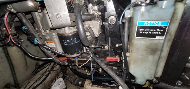

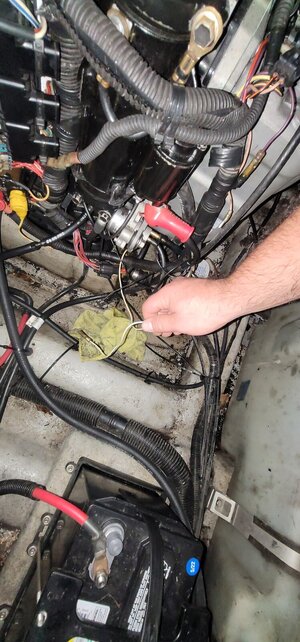

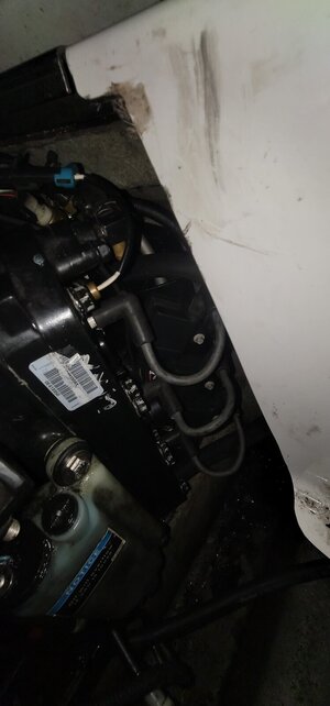

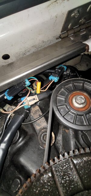

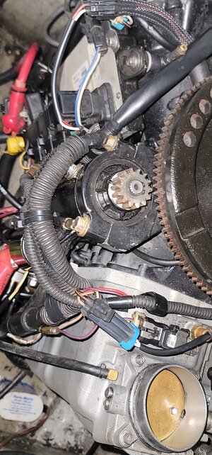

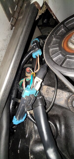

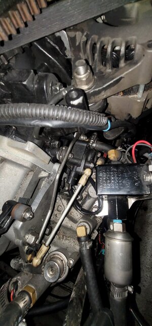

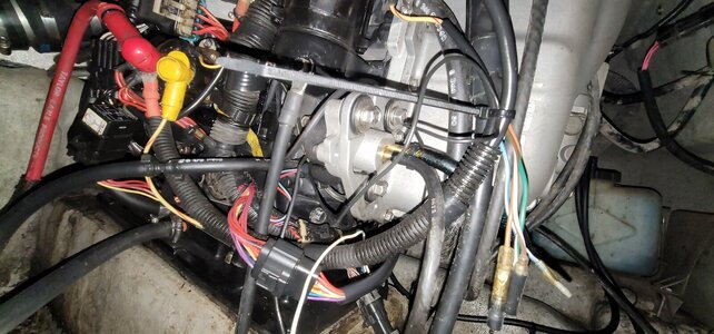

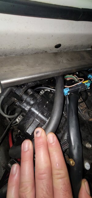

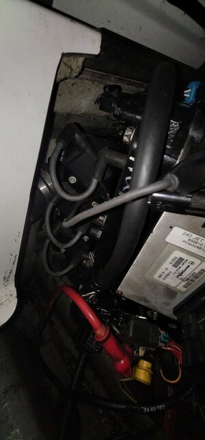

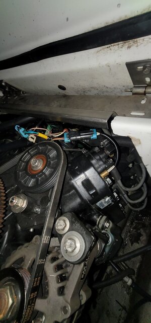

I'm not sure if I mentioned it before but the boat has about 130 hours on it in total essentially brand new looking. The engine was rebuilt due to it blowing up from the previous owners. I also wanted to note that the Rpm guage and Speedo gauge do not work, possibly when the old engine blew up, the alternator shorted something?
Either way, How would the injectors become leaky when they are almost brand new and also ran in the water for about 40 minutes with full power no issues no misfire after u got it started the first time? The alternator is belt driven and I did notice one or the times that it started on the hose before I put it in the water that it was getting hotter than the block which only ran for a mere 40 seconds before it sputtered to a stall. Maybe the range of events is not clear but I have a video of it running perfectly and have not moved any wires around besides just confirming today that all the Temp sensors even in the intake manifold seem to ohm out the same so I ruled those out. One thing I also remember is that when putting the reeds in I made sure that they were all sealed tight and no light came through from the pedals. I'm not sure if that relative to the issue but it's worth mentioning all the things I wasn't sure of. Battery is brand new and cranks from for minutes without loosing much power so that out or the question. I have checked and cleaned all fuses and the plugs. As for wiring the engine back together I'm not 100% sure but it ran on the current setup in the water with no issues so why would it have an issue now? Today I fooled around with it and cranked it a couple of times along with taking out the top sparks on each bank so I can remove the temp sensors to make sure they were good. After I put everything back together I cranked it around 12 times about 25 seconds each interval. The engine sounds like it's firing inside and even almost fell into a starting rythym like it was firing and speeding up the rpm to start like the first time I got it started but then would fall back under starter rpm with the shuddering like it was firing internally. One thing that I have noticed is that after repeatedly trying to start it, I occasionally get this gnarly backfire which should like someone let off a bomb. I also forgot to mention that I also put together another engine on a seadoo 2000 challenger 2000 yr with the Statored electrical system and it still runs like a top. I am going to attach pictures of my engines wiring and also the type of TPS I have just incase you catch something.
I forgot to mention that when it was running good in the water I would get a 4 beeps it seemed like every 2 minutes or so but didn't effect anything. I believed it was the water in the filter so I ended up removing the water separator and draining it. The fuel in there looked like it was mixed nice blue tint with oil. At this point the only thing I haven't checked with a volt meter is the TPS, injector pulse and I need to confirm spark again from all cylinders. Also there is a light blue wire that is somewhat a ground which Ys tight into one single white wire pictured not sure if thats supposed to ground somewhere in the harness. I believe it was dangling before the engine was rebuilt and it ran fine without it when it ran. Either way pictures are attached please let me know if you see anything out of order. Also maybe it's worth mentioning I only got life out of this engine the first time while unplugging one of the Temp sensors on the head I believe the port side and also the intake manifold Temp sensor.
