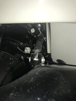

I found the part. Around $150 will I need any other parts? It looks like the boot has some splits in it. Is it easy to install?

Your pix show cable on starboard side of jet housing. That is the shift cable. Since that boot is torn, you have water in the cable. That will make it rust. Soon. Cable and boot should be replaced.
Steering: When I replaced mine $140 from eBay a few years ago for Teleflex brand. Make sure you replace steering bellows, too.
Is the Shift cable different than the steering cable? Are you saying I should replace both?
I have a cable to the left of the jet housing and then one on the starboard side
Yes. Both.
Shift cable should be less than $50.
Shift cable is on Left and Steering cable on right? Sorry I’m just trying to be clear you have been a big help. Thank you in advance.
From behind boat——
Steering on left.
Shift on the right.
Left cable moves the nozzle.
Right cable moves reverse gate.

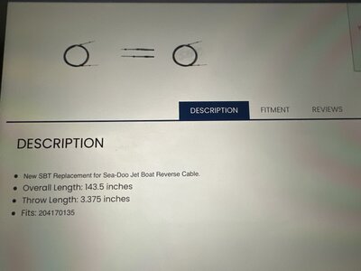

I am not finding that price anywhere. Little help maybe?
Mercury number.
896145A12
Shift, NOT throttle.
On my images above, it states that I need 145 inches, basically 12ft based of part number for my year and boat type. Trust it or pull it out first? Rather have it first before doing it
I prefer to have the old one in hand if I am buying local. The length refers to the longest length of the cable you can measure. Tip to tip. Shift NOT throttle. These are standard marine cables. Not any special Seadoo part. Don't forget the rubber boot for each cable. Mercury calls that boot an annual maintenence item.
