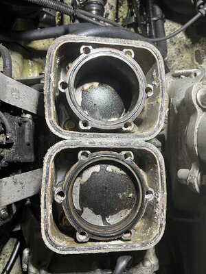

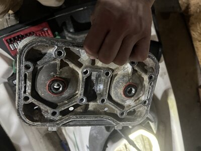

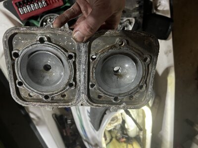

So I went back out to the shop to fool with the ski a little more. After the cylinders soaked in WD40 all night, there was no difference in the amount of movement from the pto (about 1 degree each direction). I pulled the head and I could see standing water in the little voids on the outside of the cylinder walls where the cylinder bolts are which I got out of there and I'm guessing that means that the winterization wasn't done properly. With the head off I could see the pistons were moving and were not seized so I went ahead and pulled the cylinders to see if I could see evidence of water in the bottom end. Bottom end looks fine but the pto had same amount of movement with cylinders off. The pistons look fine and never did seize and the cylinder walls look fine. The head and that space around piston walls has corrosion I'll try to clean up really good. Then I did what I wish I would have done first and pulled the jet pump. The damn impeller is frozen solid. With jetpump removed the crank moves freely.
I went ahead and ordered a top end gasket kit and a kit with a replacement impeller shaft, bearings, and thrust washer and seal. Also picked up the bearing/seal pusher tools and the impeller removal tool so hopefully I can get the impeller out without too much headache. The wear ring and impeller itself look ok and it good shape. Not sure whey the bearings and shaft would seize like this. Anything else recommended to do while I have it apart other than clean the carb? Thanks guys!

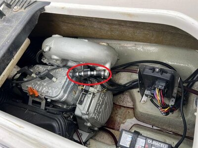

Also my ski is missing this hose setup that goes from the head to exhaust pipe and has two little "tees" on it for smaller hoses (I found the pic online). The smaller hoses are there but the larger hose and the tees are missing. Anyone know what that setup is called so I can order new? Thanks!
