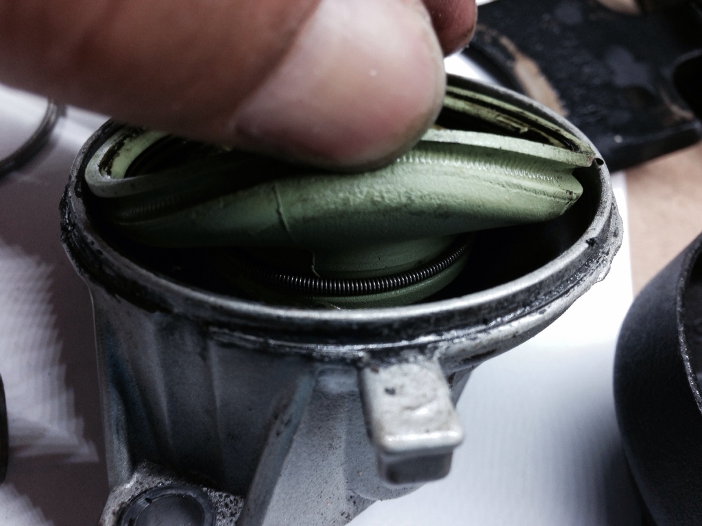

So that piston is scored pretty heavily, taking a closer look at the pictures it appears your lower piston ring is stuck from melted aluminum transfer into the piston ring groove. The top ring looks good and is sealing things up for the short term but that could change in a real hurry.I took a video through the port and spread them to a JPG.

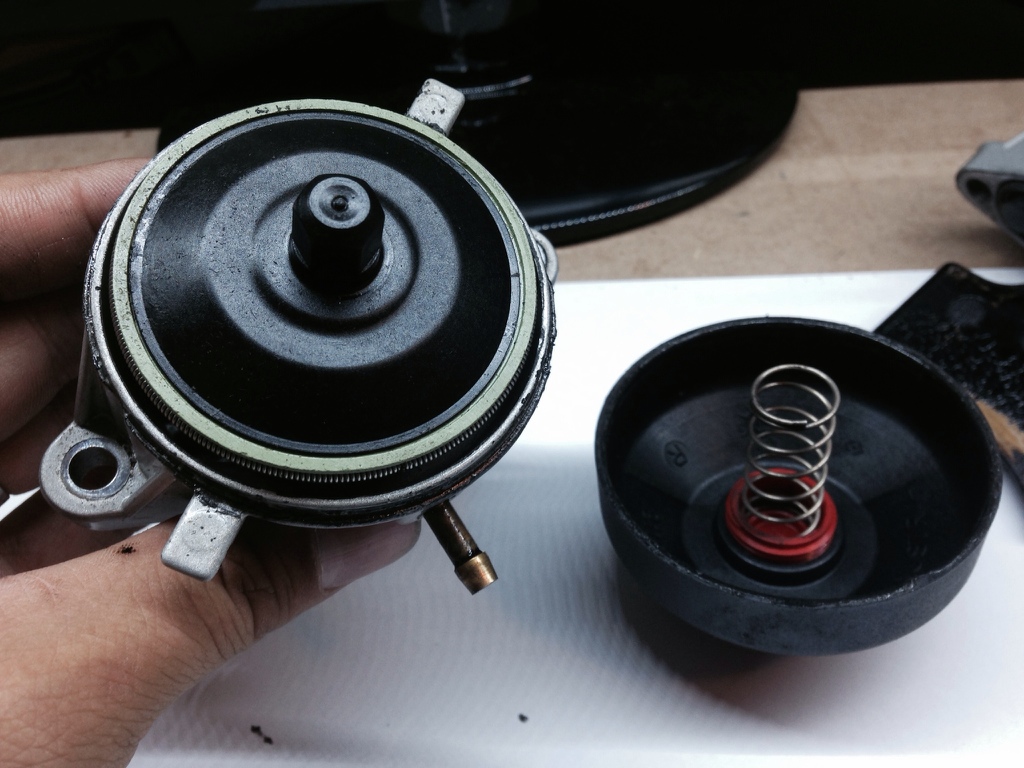

This is the piston skirt. What do you guys think?
The other one is better, no so much yellow stuff.
