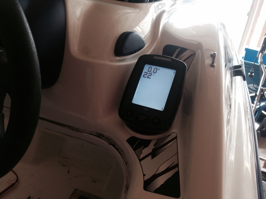

CD player is working, fish finder is alive.
Now trying to find the model manuals to use them.

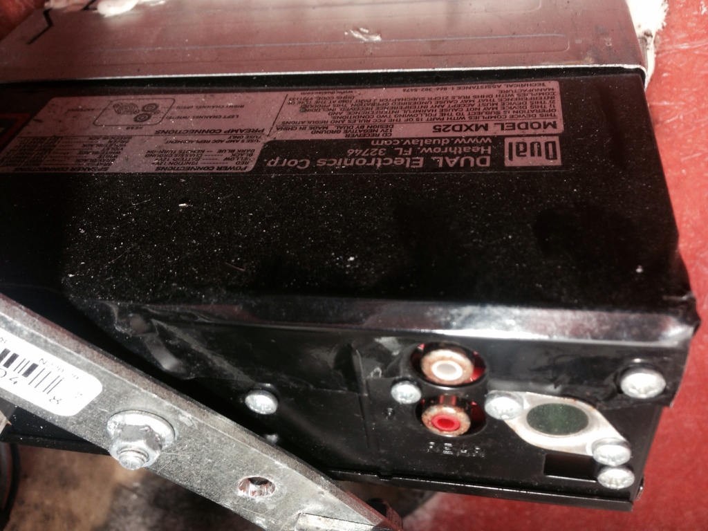

Edit: Just found out the PO got the CD player wired wrong: Yellow wire should be constant 12V battery power direct for holding the memory of the CD player settings, Red wire should be connected to a switched 12V power source. But PO connected the Red to battery directly and Yellow to bilge fan switch, which I think is controlled by boat ON/OFF switch.
Either way I don't think it is smart to leave anything always connected to your main battery, even it only drains very very low current, which is software controlled.
I don't need memory on the CD player, so I connected Yellow and Red together to my new good looking toggle power switch. Peace of mind ...

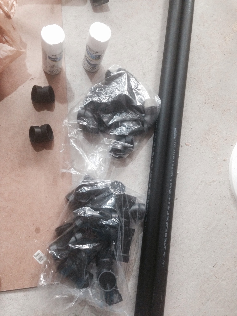

Boarding ladder will be assembled from this pile of parts :-)
Total of $50.
This is 1.5" pipe. OD is about 2".
1.25" pipe is available too, but cost almost double. So I picked the BIG one :-)

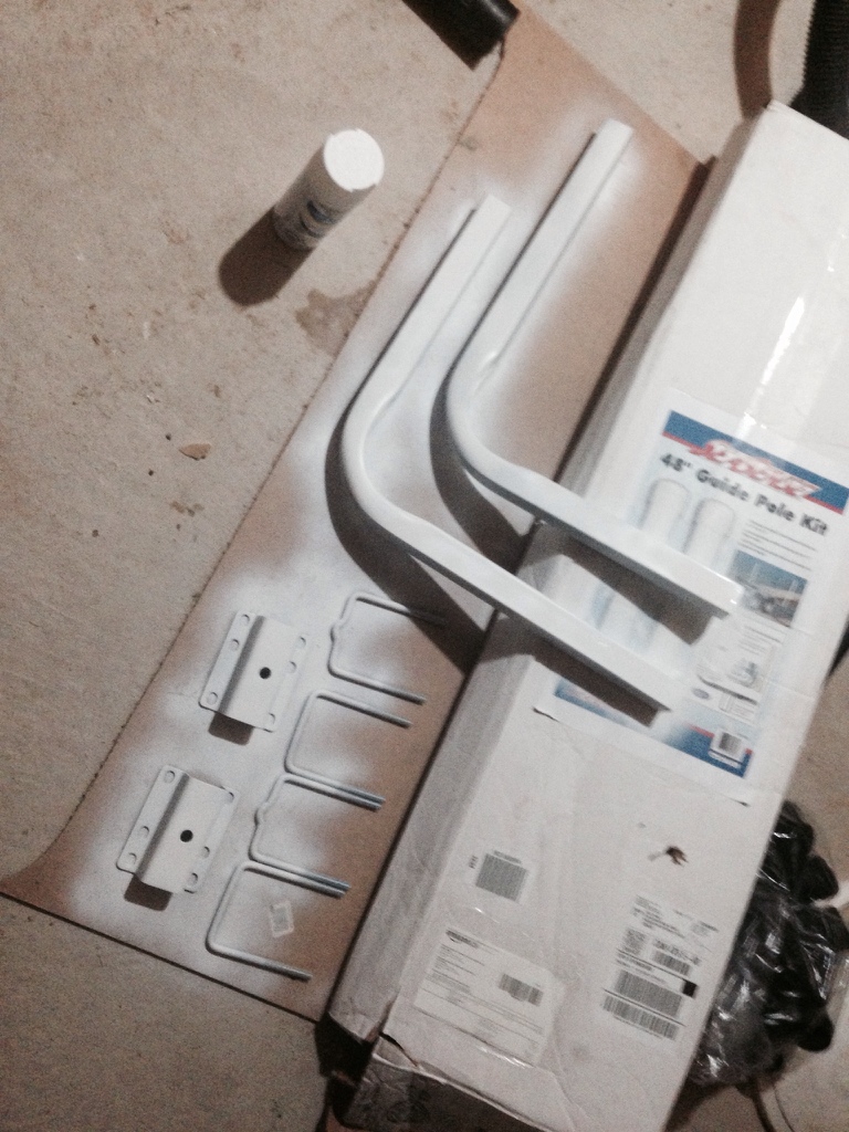

According to amazon reviews. I primed the metal piece. I will paint them gloss white.

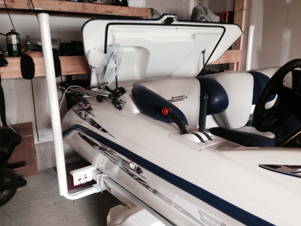

Put the guides on. Had to leave about 2" space between the bar and the rim of the boat, because the max width is in the middle of the boat. I will try it out in the next trip. If the space becomes a problem. I will add a piece of stand off to compensate the 2" gap. When loading the boat, stand off can be turn away 90 degrees. When the boat is almost in position, the stand off will be turned in to hold the hull.
Nice work on the guide poles! That makes backing up an empty trailer easier when retrieving the boat, you have something to see to get an idea of where everything's at if you can't see it in the side mirrors. I need to add those to mine pronto...
I think this won't be a problem but if you do still experience difficulty centering the boat then a bungie cord on both sides around the guide to the cleat should place the boat exactly center during A Katrina storm?

I'm very surprised the square tubing doesn't have a thick hot-dipped galvanized coating! :( But it's a better match and looks much better painted on your trailer anyway!
That makes backing up an empty trailer easier when retrieving the boat, you have something to see ... ...
I was thinking about shortening the pipe to half because it is too tall for the sportster, but now there is a perfect reason to keep it standing UP. :-D
