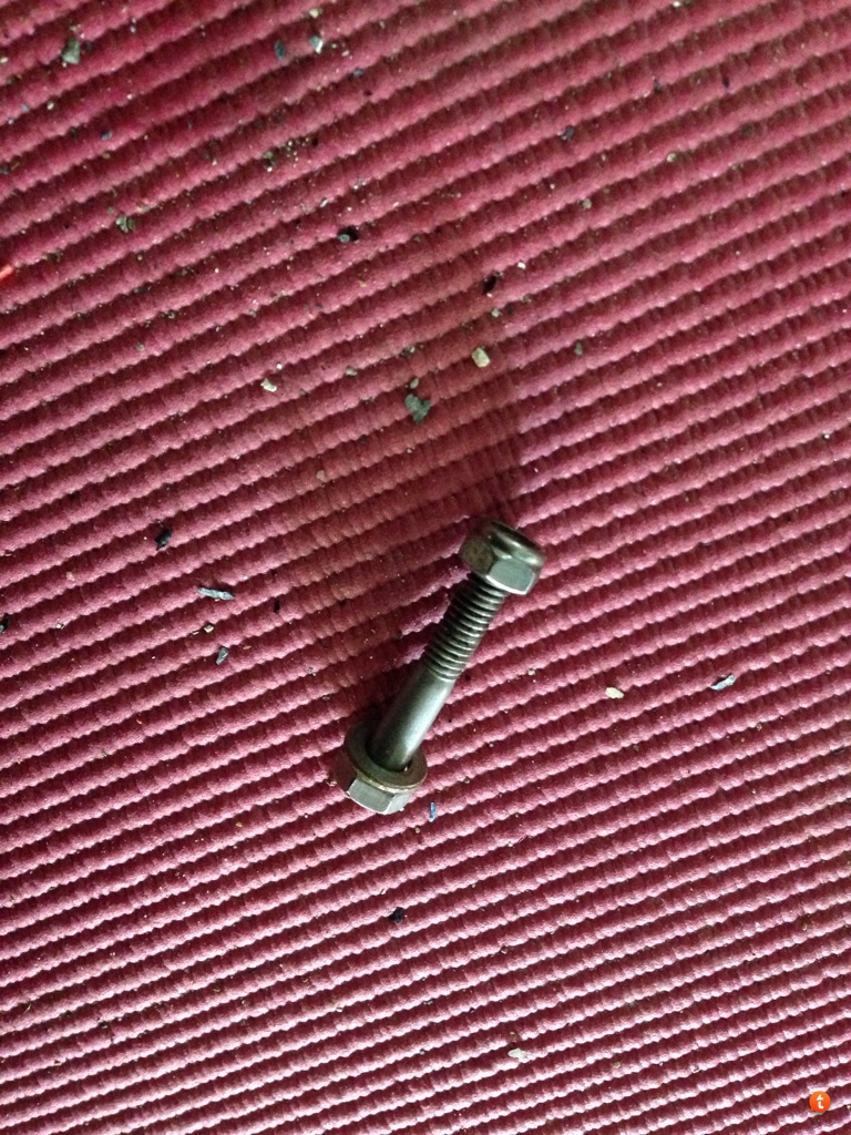

All the back end is back, but I have a screw left. Scary isn't it?
