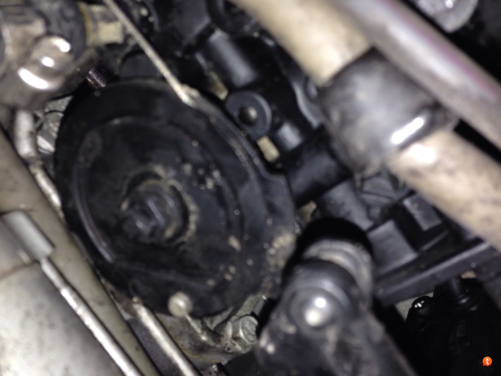

So hard to see it.
I am using iphone front camera as a mirror to see. But I couldn't tell if it is right.
Also when the throttle pushed to the max, the throttle valve is not 90 degree. It is about 45 degree between choke valve and throttle valve.

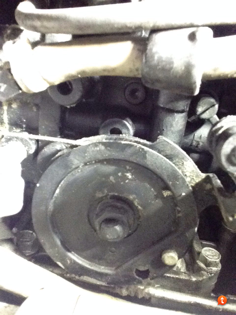

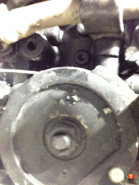

OK, I went to the other side. I opened the throttle control box. Found the cable is loose as I expected.
You can see my pinky pushed the cable over even when the throttle at 25%.
Now I want to know how many ways to tighten this cable up :-D

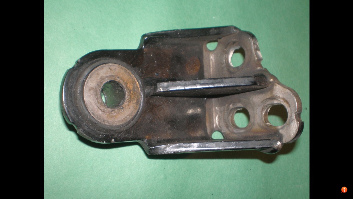

The exhaust support bracket doesn't fit, it is too small. I was kind of not sure when I was looking at the picture on the web page. I get I will have a machine shop to weld my broken one back, maybe for $50 buckets.
I went across the border today.
The exhaust support bracket doesn't fit, it is too small. I get I will have a machine shop to weld my broken one back.
I see they didn't catch you across the border, lucky! :)
I'm surprised it's the wrong bracket!?!?! If possible without problems, consider adding some metal plate while welding to make the bracket stronger. I don't recall exactly the shape of this bracket.
I tried not to break the news. I talked the guy into why I needed a new front bumper for my Jeep:thumbsup:
I will take a picture to show the difference between the stock bracket and the eBay bracket.
Ah ha. That is why it doesn't fit. I ordered the wrong part. 36 is broken, but I ordered 62! My mistake.
