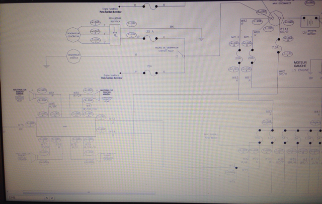

Ok,, looked up the schematics.
The radio basically has a ground and a hot wire. In actuallity it has two hot wires but they are wired together once the power passes through the fuse, thus two wires but fed from the same source. I would think the newer radios that want/need a memory wire would have a separate wire that is hot all the times for memory and clock function.
At any rate, the hot wire comes from the battery switch on the switched side. This means that the radio would not be powered up until the battery switch is activated (turned to the correct position). Many of the fuses are fed this way.
So,,, I guessing you do not have the battery switch turned on?????
The battery is turned on and I even had it tested as well. Battery is good. I am using the harness that was on the stock radio and using the power and ground wire from it. Ground wire is good but no power.
The picture is a bit light, but it shows a fuse between the battery switch and the fuse(s) that feed the radio. I would go to the battery switch and trace the wires, they should run into a fuse. Check the fuse...
