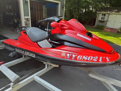

Currently engine idles at 1400rpm on the trailer. I have had a few of these carb models and DIs. Isn’t the carb model supposed to idle at 2800-3000 on the trailer not in water? Seems to have a slight mis while at idle as well. How can I tell if the carb is adjusted correctly or which ones low speed jet is clogged
Also it does not seem to be charging the battery and I can’t find the voltage regulator for the life of me.

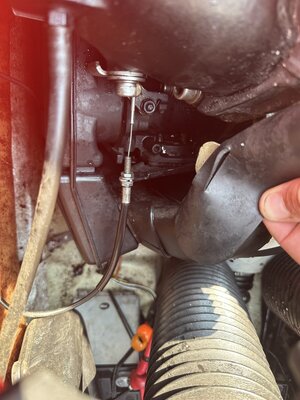

If it has a regularator inside the MPEM. I know my DIs had the same idle speed on trailer and in the water but my last 2000 gtx was carbed and would idle 2x on the trailer and perfect at 1400 in the water. I never rode this so I am not sure if the idle on this is accurate or not. I always thought the carb models would be 2800, hence my question. What can I look for to be sure. I can take some pics. I can’t even see the idle screw with the pipe on. Didn’t want to touch it until I know what I am dealing with and glad I asked the question because I never knew a carb model could be regulated.

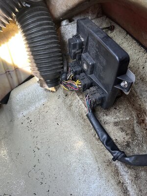

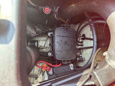

Battery voltage appears to NOT be charging. Battery is full charged and voltage doesn’t move at all. 12.62v running or not. I can’t even find the voltage regulator. On all the machines I had it was up front in my XPdi in the fuse box, and in the rear on my last GTX. This one I don’t see it. It’s not on the cover of the electrical box in the rear or inside of it.

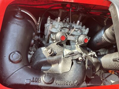

This morning I started it cold after sitting all night. It fired right up with the choke on for a second. Idle came up to 2600 then within 10 seconds came down to 1400 and sat there and idled. Here are some pics.

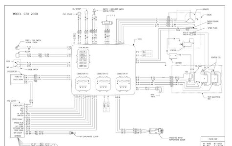

Well I guess there is no regulator it appears, just the magneto. I will come back to that another time. Out of curiosity before I start messing with the engine is it possible the pump could be dragging due to old bearings and the machine thinking it’s in the water vs on the trailer? Maybe I should pull the pump and try and start it with just the driveshaft hanging out?

Update: pulled each plug wire while idling at 1400, front one dropped idle to 1200, then after reconnecting the front pulled the rear one and stalled the engine. Adjust front idle screw on top of carb 1/4 turn and idled at 2800-3000 perfectly. Starts up and idles 2800-3000 now everytime. Smooth as butter and Revs up like a new chainsaw. Lol.
Still not charging the battery. Decided to forget about the magneto and buff her out
