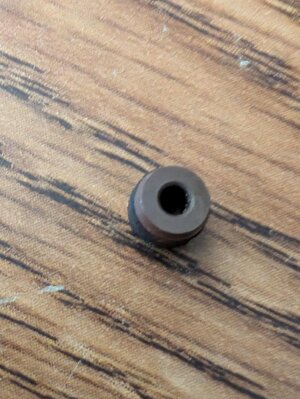

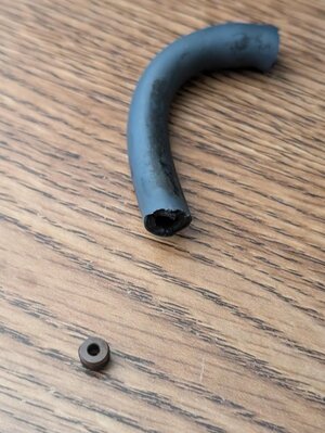

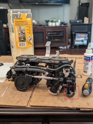

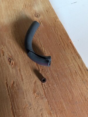

I replaced a line on the carb that had split and noticed inside the old line there is a restrictor flow valve inside..could be the issue if missing? Carb could be flooding?

I believe the absence of the orifice in the line will allow the fuel to bleed backwards into the PTO carb. When that happens the accelerator pump will loose it's prime and when you need a shot of fuel you won't get it.... creating a bog. I don't know if the fuel flowing back would do anything in the form of flooding the carb but that doesn't mean it isn't possible. :D I believe that part gets left out of many carb rebuilds. Good Luck!!
On a side note I've been arguing with some new carbs on a 787 GSX. I hope I found the problem but it wasn't the carbs... it was the return line an fuel vent where I found trouble.
Yipee!!! The little restrictor valve missing was the issue. Such a small thing could cause major problems. A couple of minor issues still to fix but takeoff, mid and top end all working great!!!
