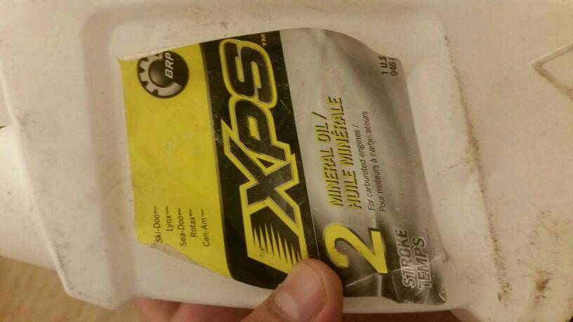

Also what oil are you running? I see a white bottle in your storage tray that looks like mineral XPS not full synthetic XPS?

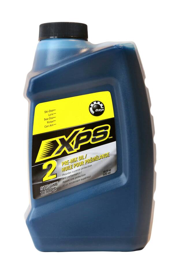

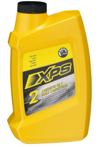

There are two kinds of XPS oils?
I have a feeling you'll tell me it's not the correct one for my xpl? I didn't get it by choice, it was per recommendation from the seadoo dealership when I picked up my parts and oil. I asked for parts and oil. It said two stroke and seadoo. I thought I was good?
I took off the pump today to check the water hoses trying to figure out the source of the temperature which caused the bolt going MIA and the RAVE hoes breaking.
Darn ... I see three or 4 kinds [emoji36] [emoji29]
I do premix and I just went through the tank with 50 to 1
In your ski you want the yellow bottle. And I wouldn't premix at anything less than 40:1 on a 951. Most run at 32:1.

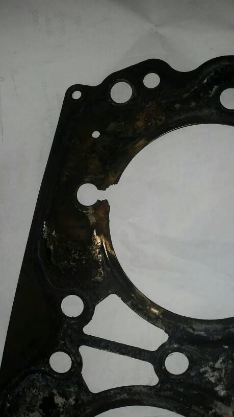

I can't say what caused the bolt to come out but your head gasket is probably compromised now.
