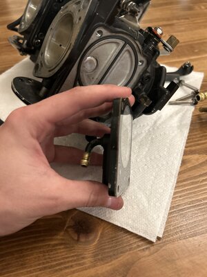

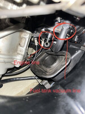

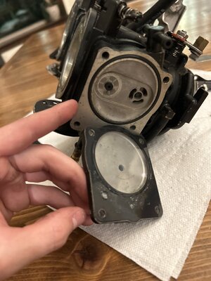

So I've working on my xp limited for a few months now and I've disassembled the entire thing and rebuilt it. Now I'm running into some fuel issues. I rebuilt the carbs using a kit from OSD marine. which I believe is a quality kit and has oem spec parts, BUT now that I've started to crank the engine, it's not pulling fuel. I also replaced the fuel lines in full rebuild so it has to pull fuel through about 10 ft of line. I cranked it for awhile and still wasn't getting fuel to the filter that unscrews from the bottom where the lines hook up to. I hooked a hand pump up to the filter out side and pumped fuel in the filter hoping it would speed up the process, but even though there is fuel inside the filter, the pump has not put anymore fuel in the lines or the filter. I looked at a diagram for the vacuum lines hoping I just hooked them up wrong, but I'm pretty sure they are correct. I have the vacuum that comes strait from the tank hooked up to the top double sided connector and the one on the side hooked up to the engine connection underneath the carbs, is this correct? I've also turned it over while feeling the end of the line to see if there is suction in the fuel line, but I could barely feel anything. I'll upload some pictures of the connections in a second post. Any help is appreciated, Thanks!
