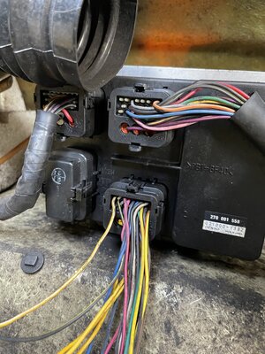

Hey everyone new to this forum. I just got a 1998 Seadoo gtx limited for free. I hooked a good battery up to it and I get two beeps when putting the key on. I press the start button and get nothing no click or anything. I can just start it from the relay but still won’t start. I checked resistance on dead post, key, and start button all good. I pulled the plugs and I get spark on both plugs I sprayed started fluid inside carburetor and still wouldn’t start. I have checked all the grounds and I’m good to go there. I’m thinking the mpem is bad but I wanted to test it before I got a new one. How would I set it? Any suggestions?

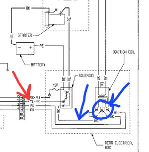

This is the schematic diagram for your ski. If you open up the rear electrical box where your starter solenoid is, there should be a black wire exiting the starter solenoid connector and joining a few other black wires on the ignition coil mount bolt. These connections inside the blue circle MUST be clean and free of corrosion. If you do a continuity check with a multimeter, measuring between the bolt in the blue circle and the Negative battery terminal, there should be less than 1 OHM. The Yellow/Red is switched on when the engine is off, key on(2 beeps), and start button held. Measuring between the Yellow/Red and black wires WHILE depressing Start as described in the last sentence should result in slightly less than battery voltage.

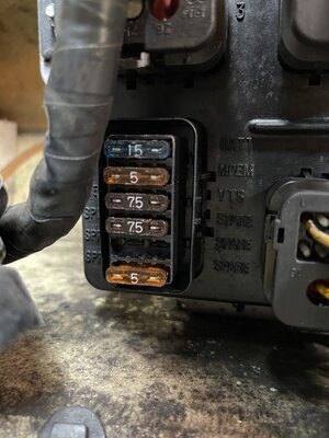

For troubleshooting purposes, remove all but the 5A fuses from the MPEM. The 15A is for the charging system.
