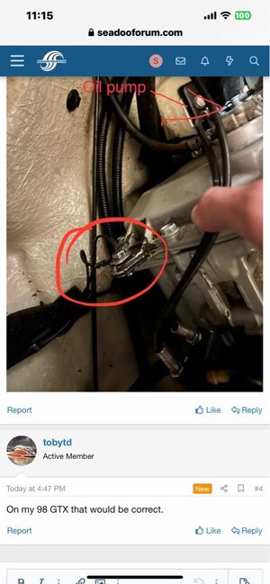

I picked up another 98 GTX. Has 150 compression, beeps twice when I put key on Dess post. Gauges aren’t working(or that’s another issue), I I can jump solenoid and it turns over, can verify spark on each cylinder. I have 12 volts on battery side of the solenoid, and 12 bolts at the yellow red wire that enters bottom of solenoid plug. I ohmed the black wire from the coil to the small plug that houses the yellow/red wire plug. I am not getting a click or anything from the solenoid. So would you say that the solenoid is toast or is there something else going on?
