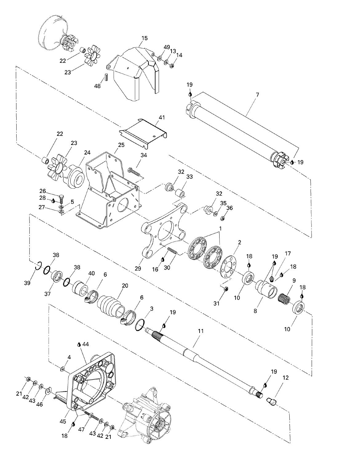

Do you have part#3 on the ski? It is a chubby o-ring that goes behind the bellow on the carbon seal set up. It's a "spacer" to push the boot further and put more tension on the carbon seal.
97' XP doesn't use the neoprene seal according to the parts diagram. Still not sure what their rhyme or reason was.
Correct,they relied on the lip on the wear ring to seal. They only show them on a few skis. I use them on every ski/boat I work on.
