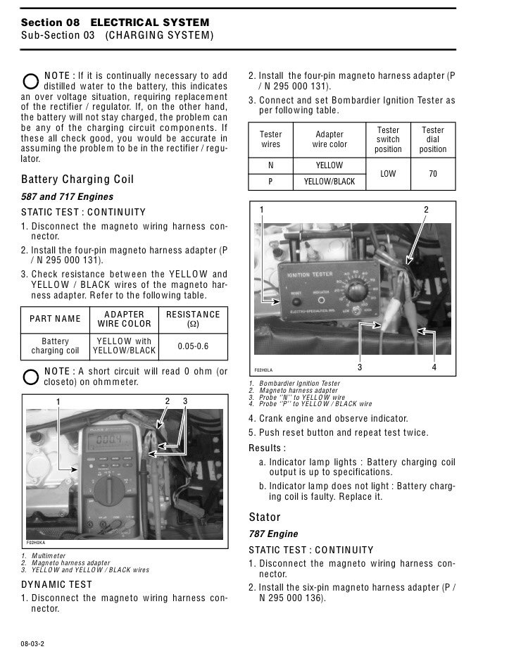

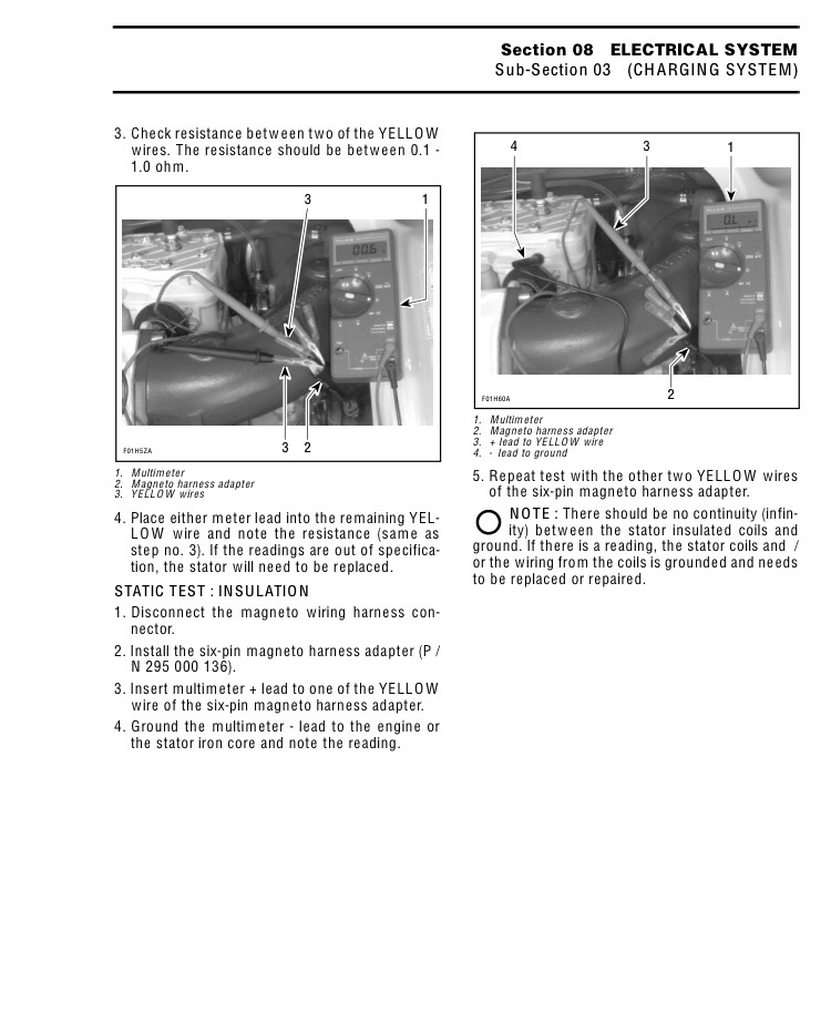

If you can wrench the repair manual can be had for free off the Internet. I would say off hand it's your charging stator or voltage regulator. Manual will give you check out procedures for the charging system. Do not just throw parts at the problem. Do the check outs. The problem with an older ski is if they can't plug in the scanner to tell them what is wrong. They are at a lost to what needs replaced. Some will just throw parts at the problem till it's fixed. Like $400 later! Start by checking and cleaning all your wire connections. On the battery,engine,starter and bolted on grounds on engine. Pull junction plugs apart carefully and look for crud and corrosion. Put Dielectric tune up grease on the cleaned up connections to protect them. Do not put in the female parts of junction plugs. Swab on the male ends / plugs.
Here's the Charging Test procedure:
