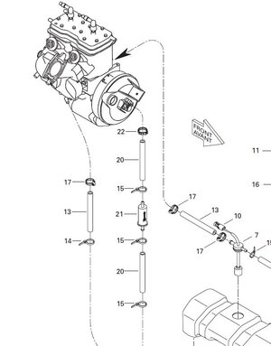

I disconnected line #13 from the top of the oil tank and pulled a vacuum on it because the crankcase was full of water/oil due to a bad gasket. When I pulled the vacuum it emptied the oil tank. This was with the cylinders removed. How did that happen and does the crankcase normally have a certain amount of oil in it?

You drained the rotary valve cavity along with the oil tank. The number 13 line connects on the front and back of the engine and forms a loop. It just endures the rotary gear is always full of oil, which is completely seperate form the crank case and pistons.

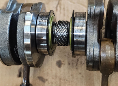

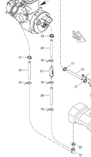

Thanks for the response. Which seals keep the rotary gear separate from the crankcase? Looking at the parts diagram and don't see it.
The seals are part of the crankshaft. In order to change those you need to completly rebuild the crank.
This is why many people will add a shut off valve to the line 13, the one that goes to the lower part of the engine to limit the amount of oil that can get into the engine when not in use as a temporary measure until such time as an engine rebuild is required.

Line #13 coming from the bottom of the oil tank, add a shutoff valve? I also was able to suck most of the water out of the crankcase using a shop vac attached to a small hose that would fit between the crank counterbalances. I have a new cylinder gasket to install because it was leaking water out the side of the PTO side cylinder. Also, thanks for the pic, I understand better where the oil is supposed to be now.
