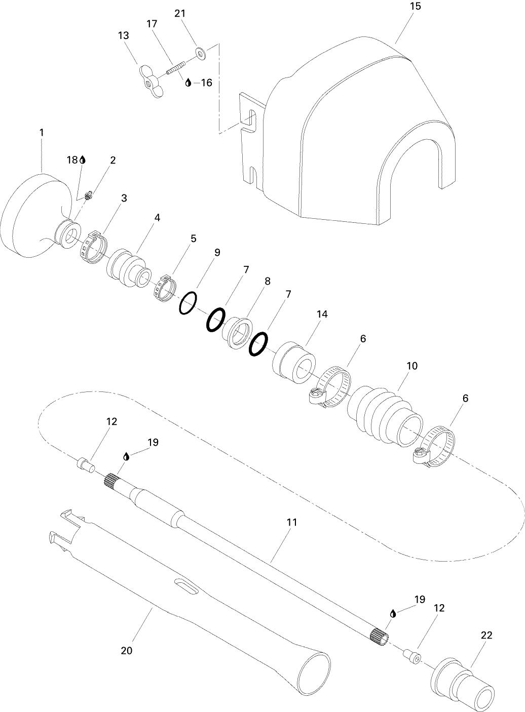

In the middle of the lake, annoyed, I googled and found this forum and possible causes. I limped it back to the trailer, got it home and pulled both jet pumps off. Both wear rings have a good amount of wear, looking down the side, i can see a decent sized gap. On one, the prop rubs in one spot so it looks a bit more rough.
Would you guys think its safe to say these rings are my issue? Can anyone point me in the direction of a sticky that has thorough directions in replacing these? Seals/orings that need ordered in addition to the rings? I may try and order a new prop for the one thats rubbing as it looks rather rough. Finding parts for these boats hasnt been easy thus far.
