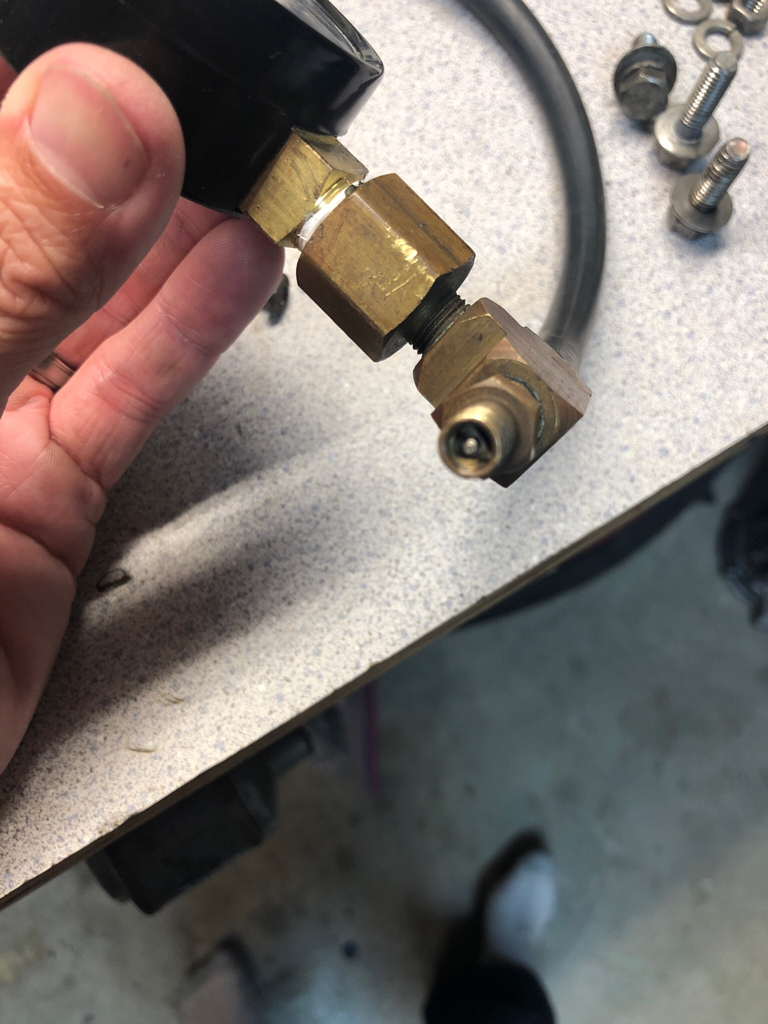

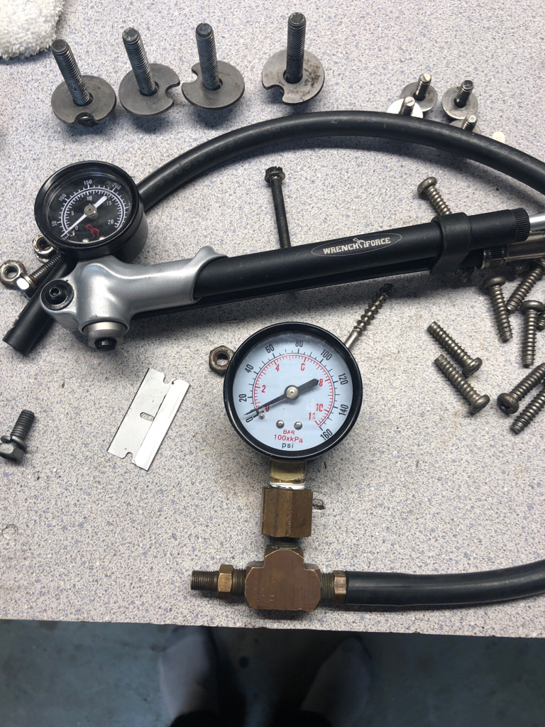

Just need to get a pressure test kit made for the carbs and I'll be out for the first initial ride before I begin the jet pump rebuild. Any chance someone could just me how they made theres?
There’s no nut on the tank. Just wiggle and pull the red fitting out.
Here you go.
