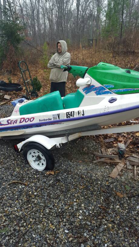

I bought a new to me GTX for dirt cheap, all I have to do is clean it and she's ready for the water, but the paint scheme isn't my favorite, what would be the best way to paint all that isn't white. I also want to paint the plastic a different color. Im going to dye or reupholster the seat.
Use the same procedures you would with painting a car. The rub rails and plastic parts can be pulled of and replaced with other colors, or spray them as well. The rub rails will chip if you rub against docks or anything solid.
For the time money and trouble I would just buff out what you have and ride the heck out of it.
That's kind of what I was thinking, its my first ski so I think that's what I'm gonna do, I was exploring my options
You can find the hood in yellow also if you don't like the green and don't want to paint.
