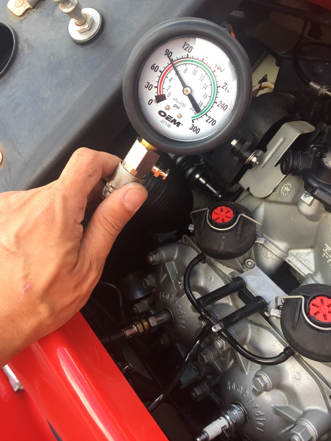

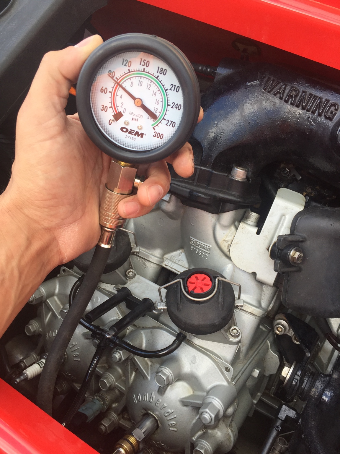

Just ran a compression test on it today, got 90 on both cylinders. Has no problem starting up or anything. I rented the compression tester from auto zone so I'm hoping that it's calibrated right.

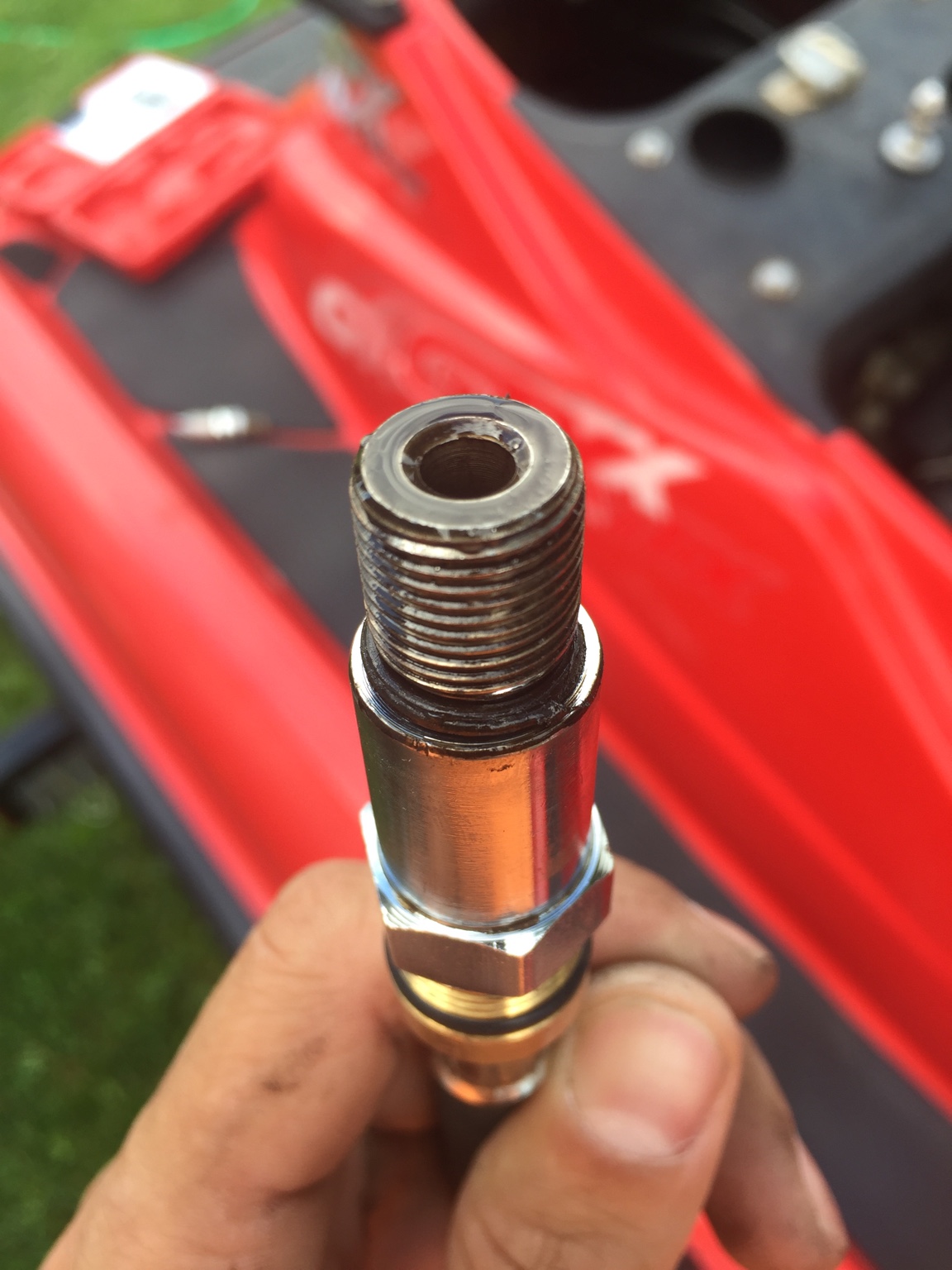

When I pulled out the plugs (brand new) I noticed they had oil on them, and even the end of the compression tester
Any ideas on what the issue could be? Do I need a new top end? If the compression readings are right I understand that's deff the issue. I'm just confused as to why both cylinders are pretty much the same reading.

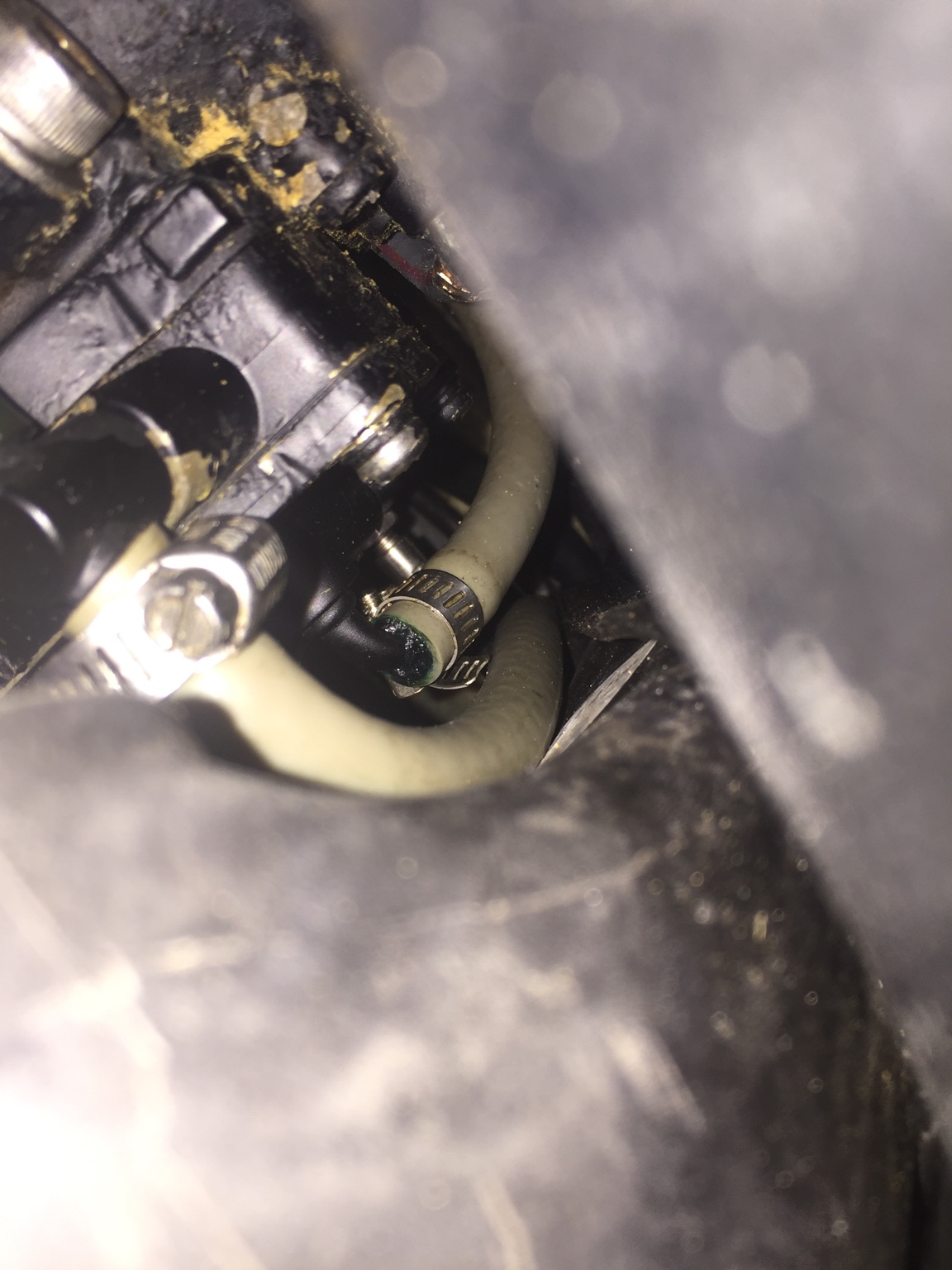

Also I noticed that some of my fuel lines are still the grey tempo lines. They look to be pretty gunky where it goes into the carb

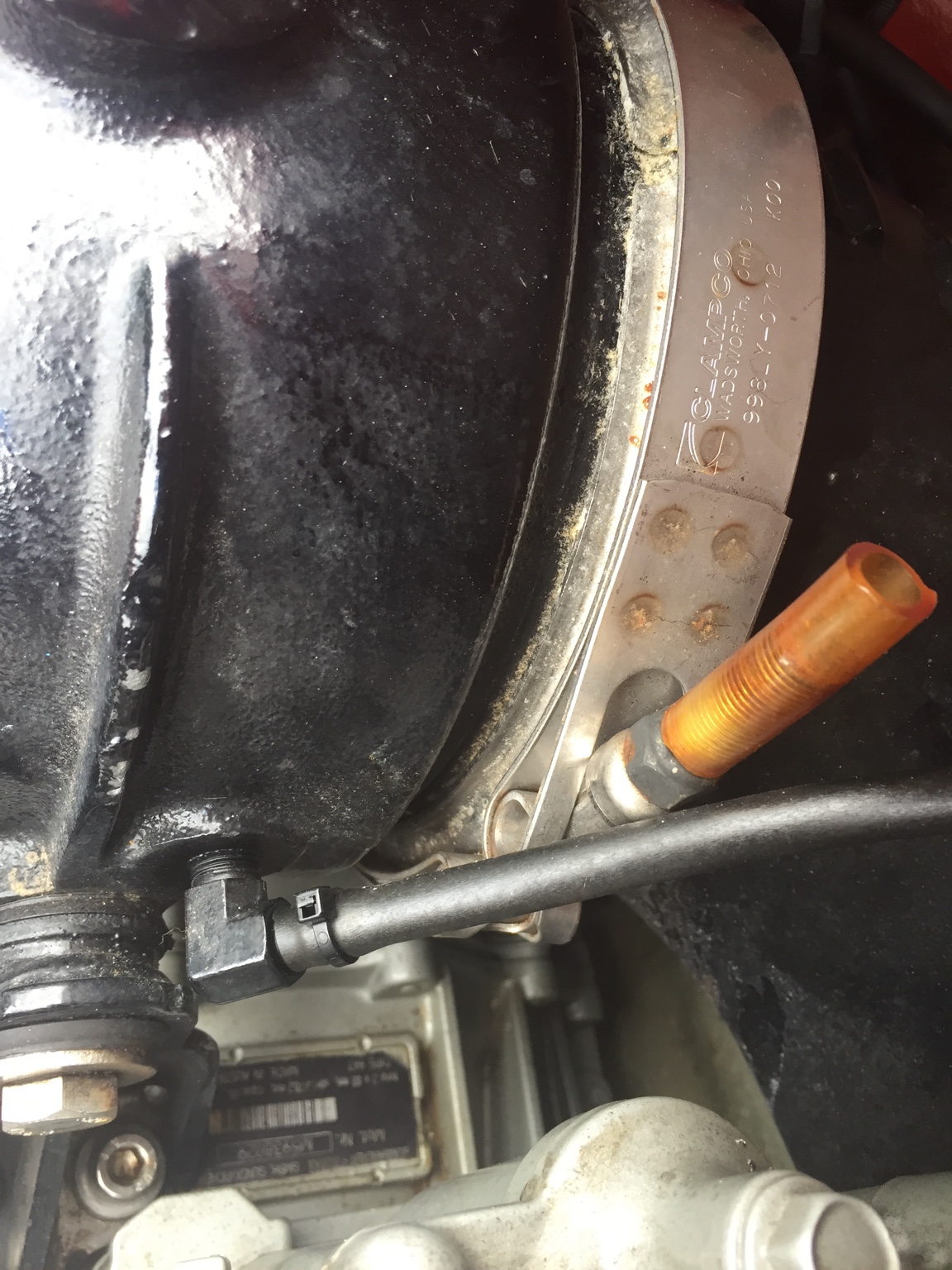

Another thing I noticed is that the band clamp on the exhaust looks to be slide over a little. Could this of caused an issue that lead up to this?

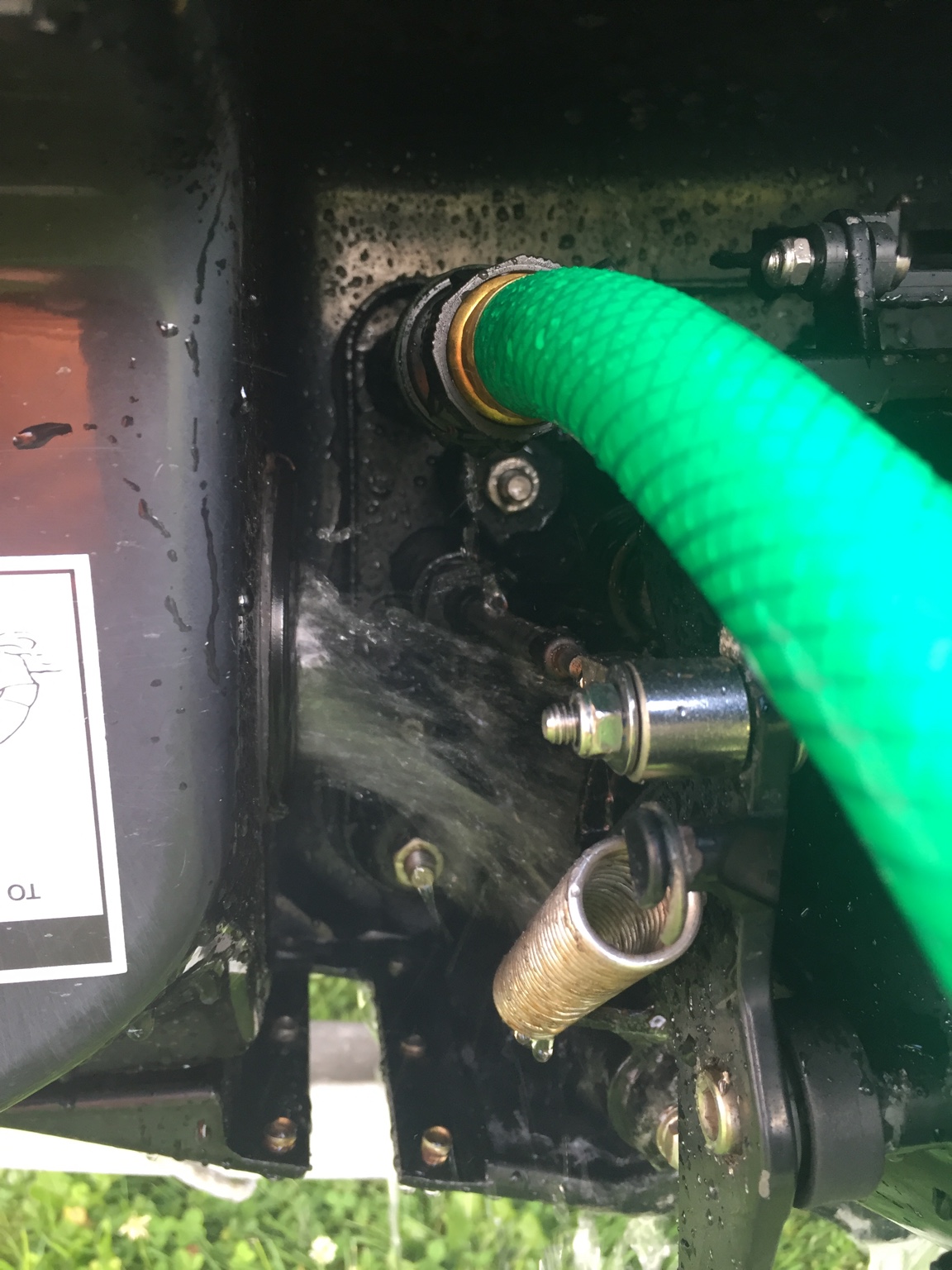

And lastly, when It was hooked up to the hose today I noticed water coming out of the exhaust hole in the back, is that normal? I'm fairly new to working on skis and just want to make sure, thanks.
At 90 psi, at a minimum your top end needs rebuilt. 200 or less hours the crank should be ok. If near 300 hours, time for total rebuild. This is assuming the rented gauge is reading accurately.
Water should come out the exhaust when on the hose. Make sure you do it in this order. Engine on, water on, water off, engine off.
Grey Tempo fuel lines are engine killers. Replace them all and double check the carb filters since you just rebuilt them.
Did you use an OEM kit? Did you replace the pop off springs by chance?
I didn't touch/replace the carbs sense I've had it because I've never had any issues up until now. Maybe you saw "carbon ring" and just misread it. Thanks for the advice tho. Ski has 270 hours on it and I believe it was rebuilt once before by previous owner, not sure though. I bought it with 230 hours on it 4 years ago.
You have to get rid of the tempo fuel lines and rebuild the carbs immediately.
What plugs are you running? They don't look like BR8ES's.
I always ran those ngks but I grabbed these plugs because that's all the local store had for me to fire it up. They said they were compatible
I do plan on changing out all the fuel lines and rebuilding the carbs too
Get those plugs out too. There is no way they can be comparable with 3 different heat ranges.
You also need to try a different compression gauge because if you do actually have 90 pis carb kits aren't going to do anything but waste money.
I planned on using another compression tester just to be sure. But if I had to rebuild the top end I would do the carbs while everything is apart is what I'm saying. Do have any ideas what you think it is based of the symptoms I listed? Does that sound like something that would happened with a bad top end?
The symptoms you are describing are exactly dirty carbs and/or fuel system.
Unfortunately the results of running it that way are ruined top end and thus low compression.
Thanks I didn't know that. Hopefully I can get some better numbers out of her now
