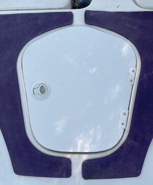

Hi, I realize that this is an old thread, but my brother-in-law picked up a 1997 Challenger also missing the hatch on the rope storage locker. If you can find a used one they are crazy expensive. Instead, I used a piece of white polycarbonate, cut it to shape, made some new hinges from thin PVC plastic (from a bottle), ordered a new latch from Amazon and voila, new door for about 30$! It does not have the purple covering on it, but works quite well.
