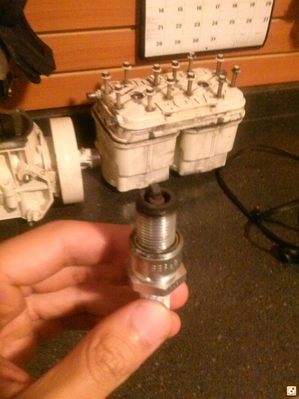

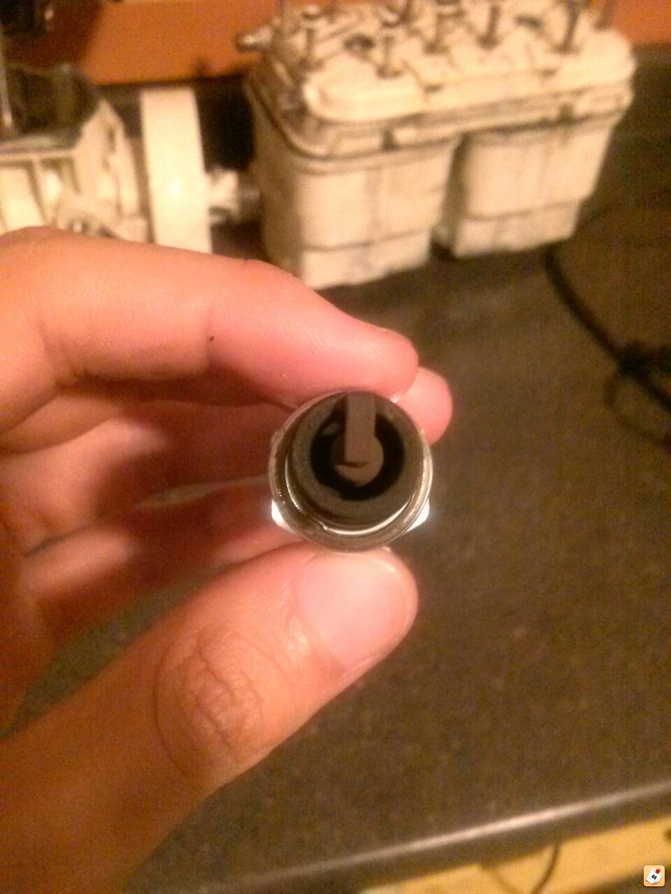

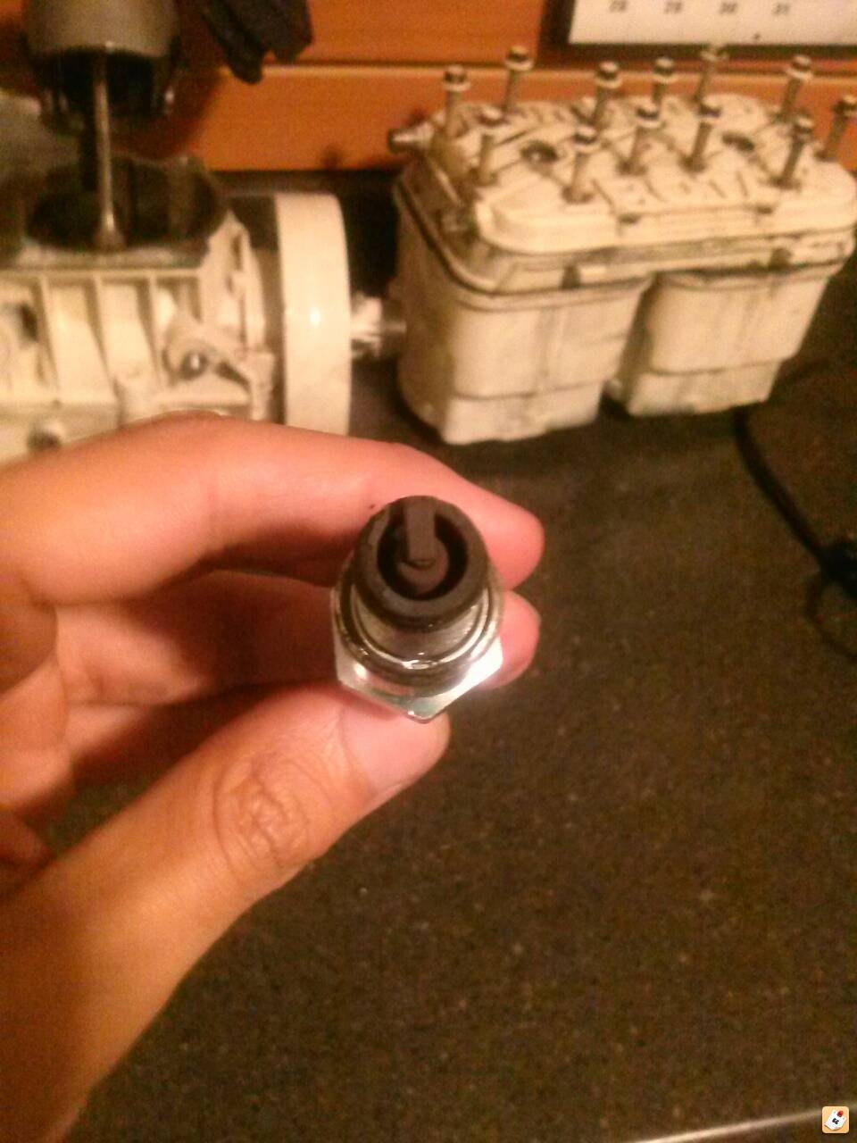

What do you guys think of these these spark plugs

I think they have WAY too many hours on them to make a call. But, they are brown, and not wet.... so, it's OK.
Its the bombardier mineral oil that the dealer suggested its a white bottle since i lost some of the xp-s syntetic from bombardier but they said it was fine if the mix.

If you must read plugs(I advocate looking at them for signs of trouble, like snow-white or gray ceramic insulator), then this site is acceptable to me:
http://www.seadoosource.com/sparkpluginfo.html
Looks like yours have been running recently at low(er) speeds, in which case I'd say it looks acceptable. If you do a high speed plug chop, I would like to see them clean up a bit, with a color change on the grounding strap where the strap heats to sluff off deposits.
How does the piston crown look?
http://www.smellofdeath.com/lloydy/piston_diag_guide.htm
Here's an article written by an actual expert (see bottom of page, how to read plugs)
http://www.strappe.com/plugs.html
At least you can say there are no air leaks, they look like they're on their way toward fouling but I'd bet if you took a high speed run they'd clean up and be good for some more low speed operation.

To be honest it had been going 75%to100% most of the time unless I was warming the engine up or putting the ski on the trailer.
The piston looks like the first one with the dark borwn/black color.
I will do that test Sunday when I take it to the lake.

In that case, I'd say you could go a little leaner on the high speed mixture but don't go too far, you just want the ground strap to lighten up a little so the deposits will begin to burn off, like the first plug on this page:
If you go too lean, you will roast a piston, too rich and your top end RPM will suffer some, turn it back a little and see if the top end RPM comes up any. If running WOT and the RPMs begin dropping off, it's most likely because your pistons are too hot.
But you're close to where you need to be, just looks a hair rich. Put av gas in there and it will wash your piston domes clean b/c high octane burns so cool, the only way to tell when burning that stuff is by ground strap color.
If you really think you're leaving power on the table, then do a WOT plug chop and have a look, those are the conditions where you must not be too lean and your engine is running it's hottest, sometimes coming off the throttle from WOT, a partial lean seize can happen if the mid range is too lean.
So go slow when turning back the fuel, any power loss means you went too far, the leaner you get the closer you are to detonation. Fuel grades can change as well, lower octane fuels are more prone to detonate, and detonation eats pistons.

Yep, the high speed screw. If you were running your ski on the main venturi (over 70% throttle) then judging by your plug it's a little too rich. The ceramic insulator will continuously collect soot if it's too rich, and high speed operation burns it off if it's not too rich.
Judging by your plug, it's not a high speed chop test b/c the insulator nose and ground strap especially, should be cleaner than that, and the ground strap should show a color change on it's length.
So I kinda think if this plug was in an engine running hard(at max temp), it should have less soot on it. It only takes a couple minutes of WOT running for the soot to burn off like it should, if the mixture isn't too rich. You could try turning your high speed mix screw in maybe 1/8 turn increments to see if WOT RPM improves. If WOT RPM doesn't improve, then you were there, put it back where it was.
If WOT RPM begins to trail off at any time, then you've gone too lean, you want to run as rich as you can at WOT without loss of RPM.
The plug will be brown to black at mid range throttle, it doesn't reach max temp under those conditions.
Plugs are self cleaning if the WOT is set up correctly, too rich and they won't clean up, you probably aren't getting max power at WOT, if the plugs aren't cleaning up.
See the pic of the plug with the ground strap color change. This is want you want to see from your WOT chop.
