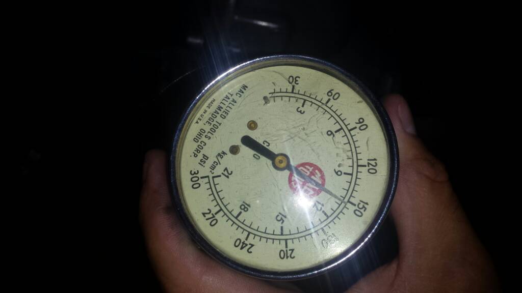

Well I did a compression test tonight and had 154 psi and each hole. I do run the big black thing under the seat so it gets hair. It has been in the nineties the last week with lots of humidity. I'm going to check the throttle tomorrow since I ran out of daylight tonight.

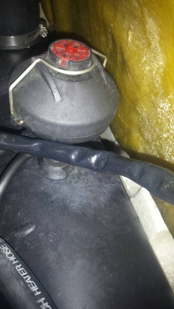

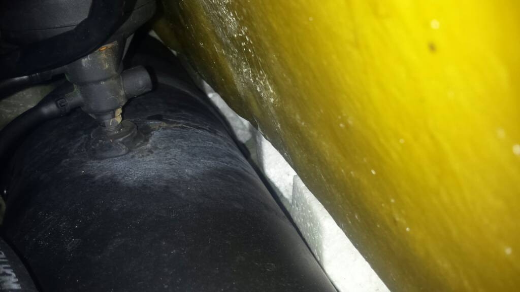

well at lunch i went down to the lake and looked at the ski on the lift and look what my pics found. i would say this is my problem! i will water test it tonight
Looks like it is leaking. On your first picture it looks like there is a little rust. This is typically the lower clamp rusting out.
