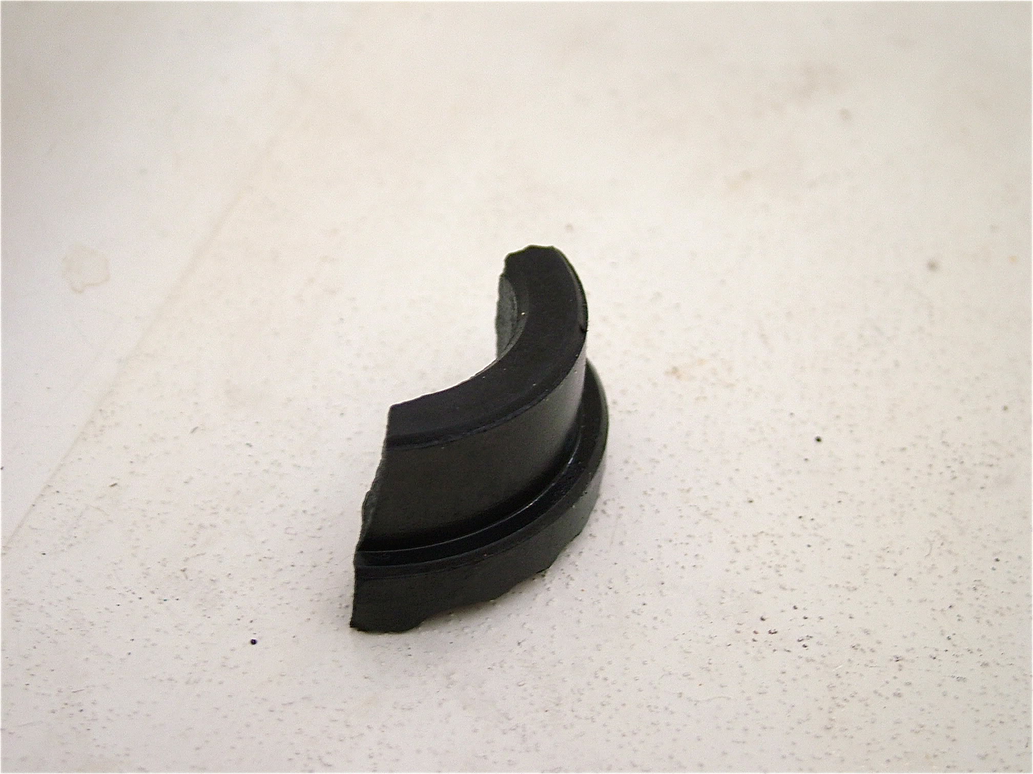

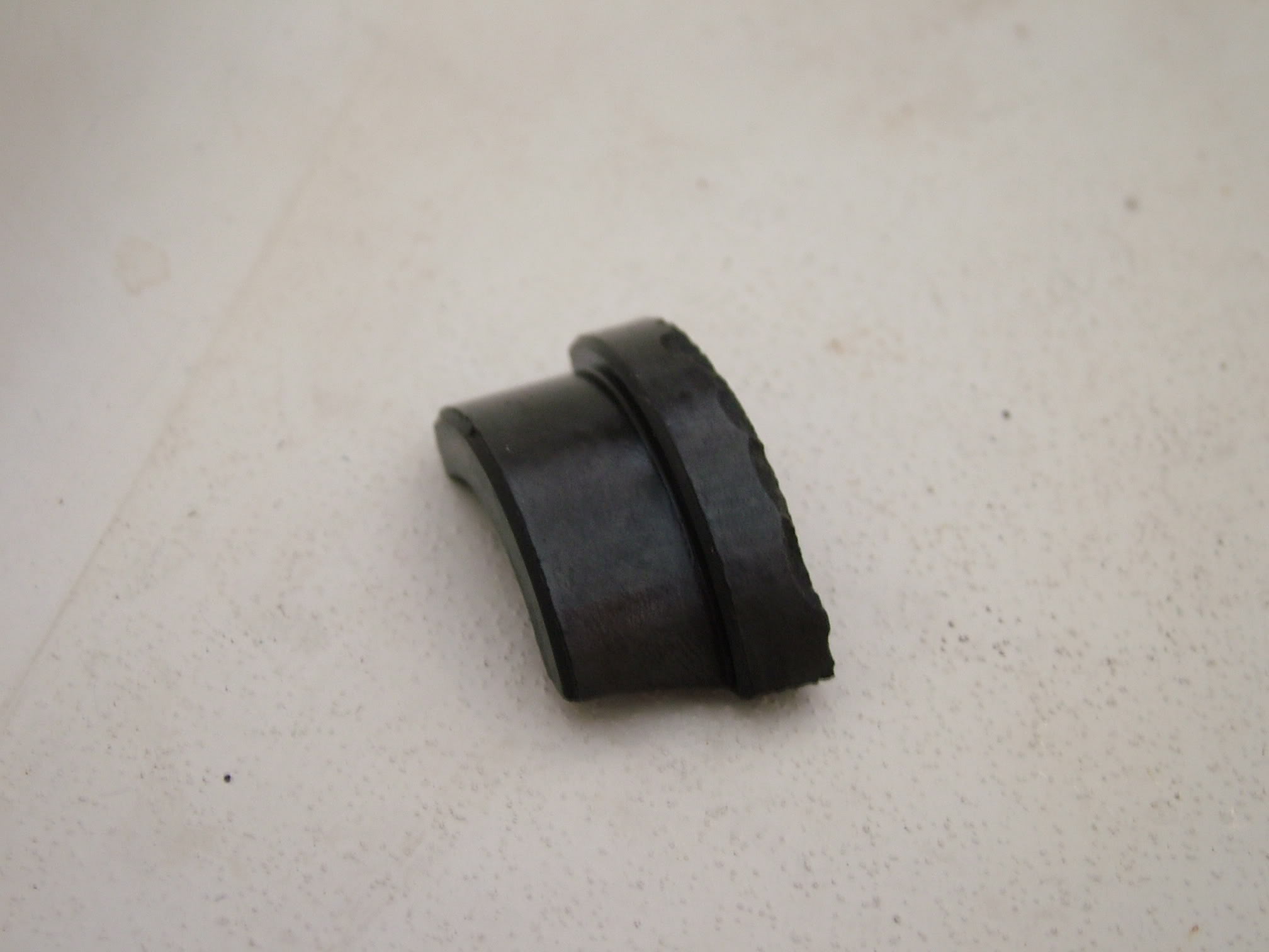

While working inside my 97 GTI I found this at the bottom near the PTO shaft. I'm not sure what it is what ever it is its broken obviously. If anyone can please let me know what it is and how important it is. :confused:
CHEERS!
That looks to be half of a carbon ring.
It would be very important in reguards to keeping your Doo afloat and not filling up your engine bay with water and sinking.
It's basically the seal for your driveline.

The ski will flood period. If you run fast it is less likely to fill since that is when the bilge siphons work best. Running at low speeds in either direction or letting it sit for long periods will fill the hull rather quickly. You should replace the BOOT as well as the carbone ring since they work in unison. The boot acts like a sping to apply pressure to the carbone ring and the seal carrier.

Make sure that the carbon ring in the ski now is actually broken. I've seen skis' that have good carbon rings but that have pieces of old carbon rings laying in the bottom of the hull from a past repair. A broken carbon ring such as the one in your picture will cause a ski to start sinking "big time" when you first put it in the water. It doesn't sound like your leak is that severe.

Carbone rings rarely break into pieces like that. More often than not they simply wear down till the seal is not complete and you begin to take on more and more water progressively. If they break like that it is usually a sign of more damage elswhrere, like broken motor mounts.
Grab your exhaust and try to rock the moto from side to side while watching the motor mounts to check for breakage in them.
I have see some rings break from a tech using a 1/4 drive air ratchet to tighten the clamp. It doesn't need to be that tight!
If that is "YOUR" cabone ring then you would be able to see that it is missing. Look on the driveshaft for the flange of the ring between the boot and the stainless steel carrier. The taller 1/4 in part of the flange will be visible between them.
