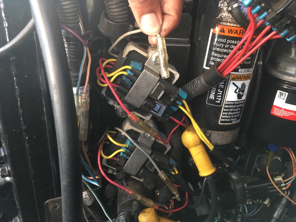

What is this component?
Hi, today while changing plugs I noticed this part with an unconnected wire. There are 2 of them on the starboard side the lower unit has the same wire connected.
What is it?
Can I just jump a new wire to the lower unit?

Those are both voltage regulators. The 240 has a split system. (2x20A outputs) It's great if you have 2 batteries.
Anyway... we get a tach signal from the stator... and that wire feeds the tach. But, since you only have one tach, you only need one hooked up. (like on the bottom regulator)
