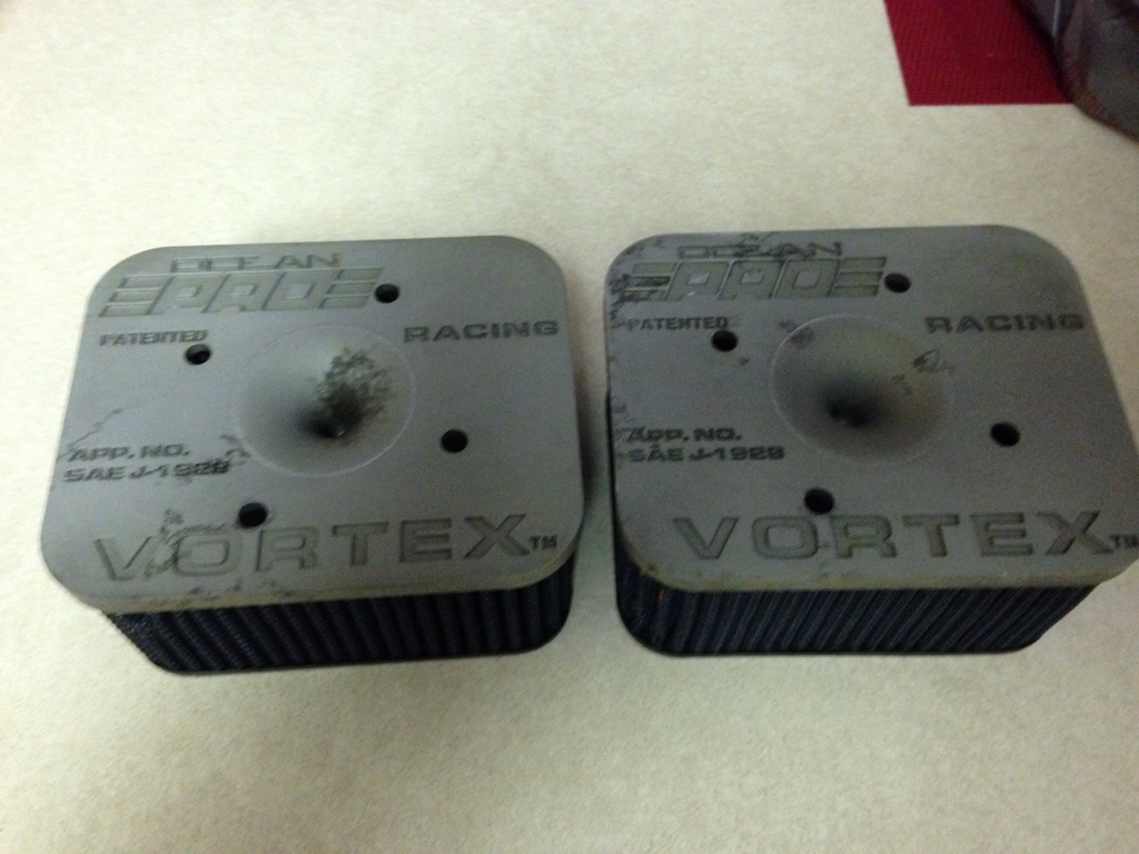

I just picked up a set of ocean pro flame arrestors and spare set of carbs. I want to do some testing for my own knowledge on the benefits (if any) of using these with no other mods. I am going to rejet the spare carbs for these f/a and do some testing with the stock set up and then switch to the open f/a setup with rejettrd carbs and record my data on the two. So, what jetting are you guys running for these open f/a on a stock 96 XP?

I've always heard that they do nothing without other mods but never seen any data, hence why I am going to try this out under the same conditions with each set up. In going to make several runs with each set on the same day same water conditions and see what the numbers show
