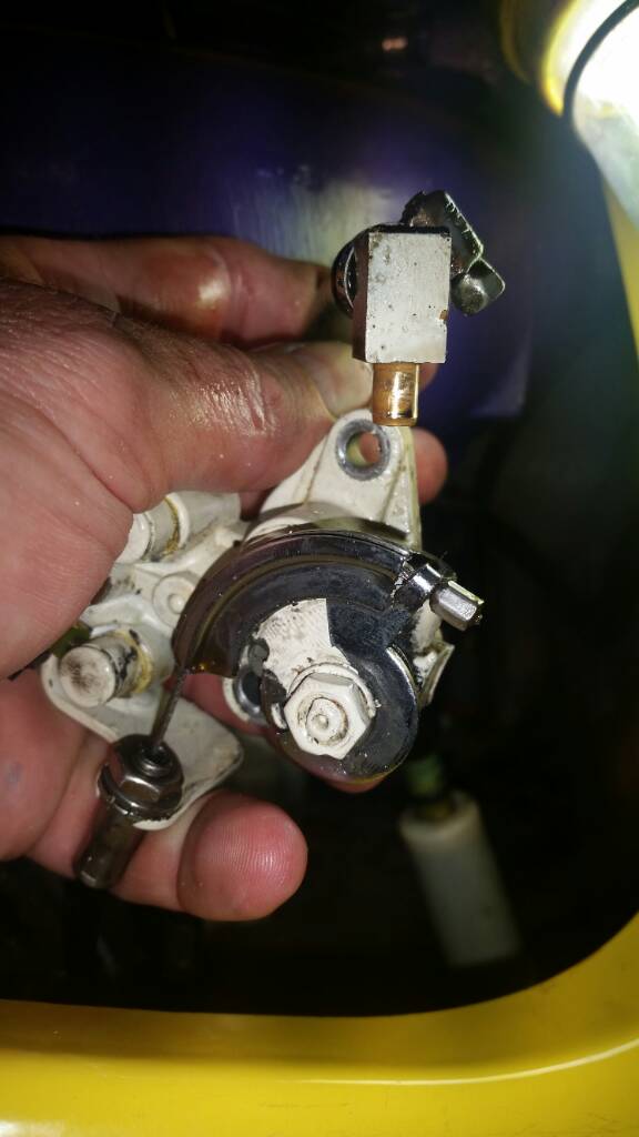

I replaced all as stated above and found the root cause. The pressed in fitting in the oil pump was so loose it fell right out when I removed the pump. I'm hoping this isn't a common occurance. If I hadn't changed the injection lines and watched them closely on the first trip it likely would have cost me an engine.

The outlet fittings are press fit as well.
These may have been epoxied in and so it's likely many will fail. Amazing it wasn't leaking oil into the bilge!

Glad you pulled the pump and found that loose fitting! Sometimes just changing the injection lines will show up a loose fitting as you pull and push on the tubing or tighten the tie wrap clamps. Your spring looks fine from what I can see. A big mirror helps getting the pump back on.
